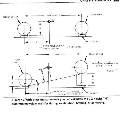

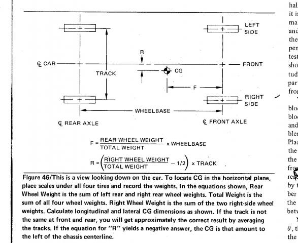

hi Russ and Gary,
This Diagram will help you find the lateral C.G.
When I started my GT40 scratch build 18 yrs ago, there was no internet. so my reaserch was done with books. these formulas, and diagrams, are from .
Fred Phuns book "How To Make Your Car Handle." by HP books
Another good book to read is,
Competition Car, SUSPENSION. Design.Construction. Tuning. by Allan Staniforth, by Haynes books
They may be old books. but there is lots of really good information in them..
I have also included the text that goes with both of the diagrams.If it is not clear, send me your email addy, and i will send it to you

<o:smarttagtype namespaceuri="urn:schemas-microsoft-com<img src=" http:="" www.gt40s.com="" forum="" images="" smilies="" redface.gif="" border="0" alt="" title="Embarrassment" smilieid="2" class="inlineimg"></o:smarttagtype> Hi Mick
Thank you for all the info. I read those books and others and copied heaps of info from them back in the late 80's when I did a Lotus 7 scratch build. No internet then just the local library and ordering in books from the national library.
I am after the COG location of some of the current builds so I can incorporate some anti squat and anti dive in my suspension design. My research says that the originals had 30% anti squat and anti dive.
Hopefully your info will inspire someone to measure there car.

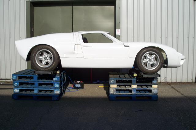

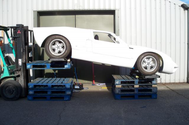

Hi Gary,and Russ
well I had a go at measureing the COG Height. It wasnt easy.I bolted the load bars to pallets, and bolted a frame to the load bars to support the wheels, , then I raised the pallet supporting the rear wheels with a forklift unfortunatly the frame work hit on the chassis at the back, so I was only able to raise the back of the car by 16 inches. but if I get up early tomorrow, i will modify the frame so i can lift the car at least 24 inches
With the car level
Rear wheel height 941 lbs
total weight 1617 lbs
wheelbase 95 in
giving F the value of 55.31
With the rear of the car raised 16 in
Rear wheel weight 935 lbs
Total weight 1621.4 lbs
L = 93 in
Giving G the value of 53.6 in
I havnt done the calculations to find the height as I cant remember how to do sines, etc, but I did measure it, and it seems to be about 16.5 in above ground level. with a 4 in ride height
The centre of the crankshaft is 14 in above ground, but it will be intresting to see how the COG height changes when I lower the engine by 2 ins
The car is not finished, so It is only an approximate COG height. but I hope this helps you Gary. I will see if I can get someone with a finished GT40 to let me measure their car, and get a more accurate COG height

Hi Mick
Awesome. Above and beyond the call of duty.
Interesting to see that your COG is only about 50mm ahead of where Russ has his.
With a driver, passenger and some fuel on board the cog will be heading towards the 50/50 split. The height surprised me as to how low it is, probably quite a bit lower when loaded.
