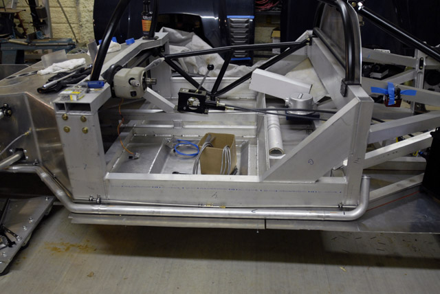

Here's what I did and the work was a lot easier than I imagined. I bought 15" long mandrel bends (they normally come 12" long) which allowed a direct connection from the 45* to the front 90* bend saving the additional weld joint. The pipes were already beaded on both ends so I just cut the bead off the end I needed to join and used a hose clamp to keep in the place for mockup and delivery to welder. I would highly recommend using a stationary band saw for the cuts like I did, the cuts (even the 45s) came out flawless.

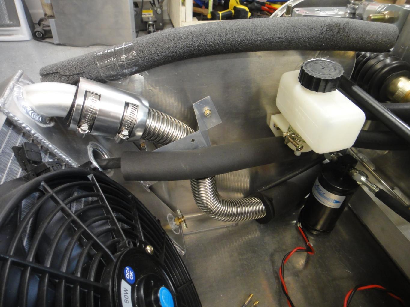

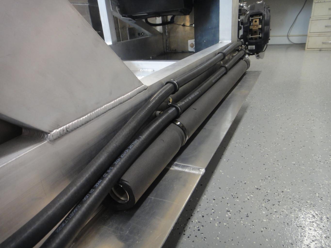

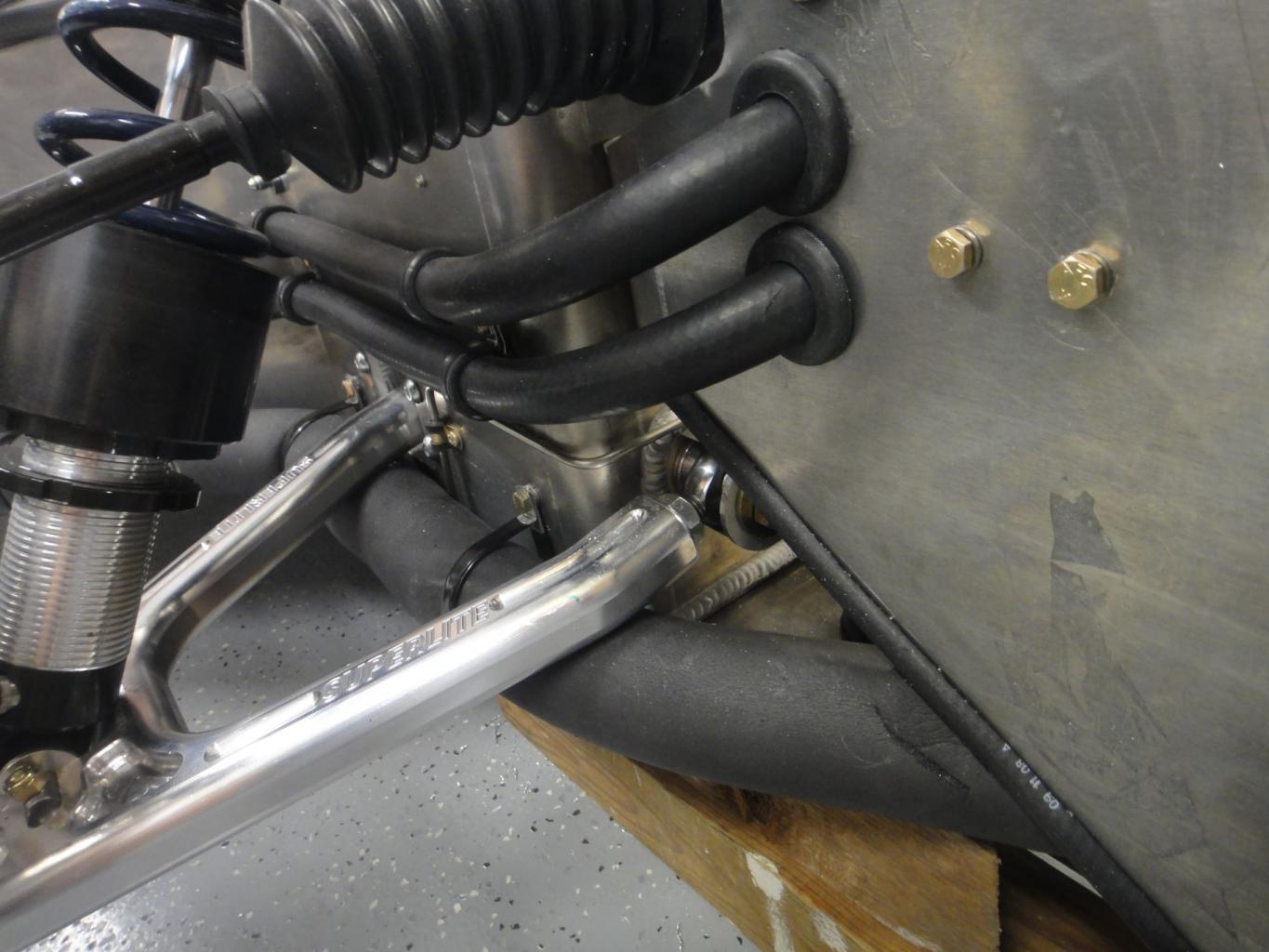

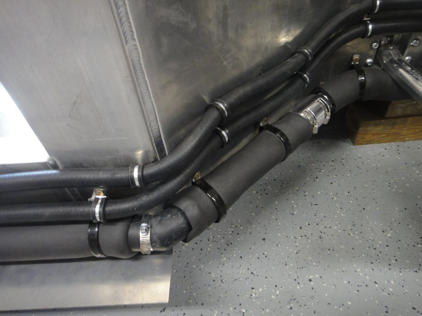

Here's how I did mine. You will notice that its in two pieces. The pipe inside the sidepod and then the piece in the nose section. Why? How will you fix the pipes without taking the car apart should you have a shunt and damage the nose. Just a thought.
The last two pictures are of the system drain. Just a bung in the lower wheel well pipe.
