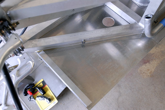

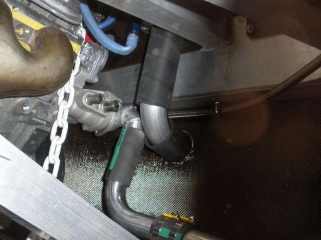

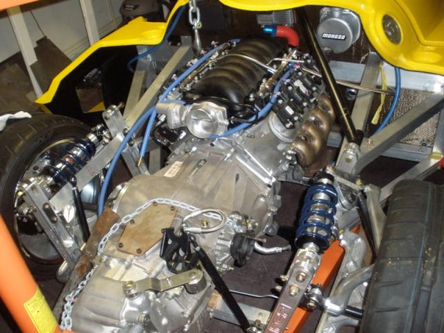

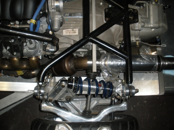

Here are a few measurements and photos:
upper longitudinal square tube inside-inside = 31.5"
lower longitudinal square tube inside-inside = 24.5"
side "pans" were cut for 21" wide x 22.5" long to give about 1/2" tire clearance at the front of the tire.

I as are other LS7 users will have a dry sump tank (3 gal Peterson) in the "wedge space" on the passenger side (the hole in the pan is for drain plug access in the photo). The remainder of the pan is large enough for a 7.5 x 11" Setrab dual pass oil cooler for the engine (passenger) and transaxle (driver). I am trying to fit a positive air flow to the engine oil cooler with a small 3" inline fan and shroud to the side port.....just not sure yet of clearances. Also, several of us are working on wheel tub ideas.
I believe Jack is extending his rear pan across the engine compartment. I am waiting to see clearances once the engine and Ricardo are in place whether to extend the pan aft of the engine to the diffuser.
You may have room, for example, to move a small battery, a fuel pump and the like to the side pans. Of course, this depends on exhaust location (side versus aft).
