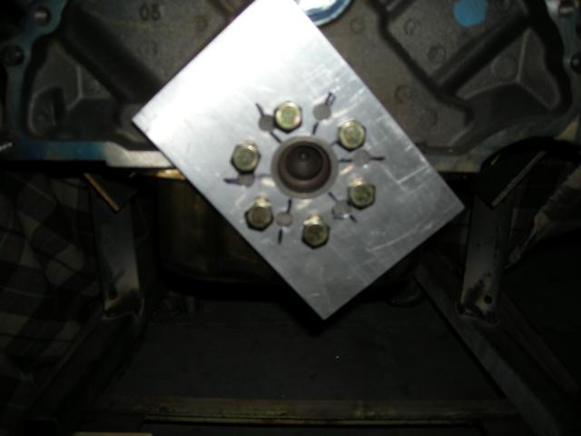

Wally and John,
Thanks for the info, and the bolt pattern worked great, check out the template, then check out my build thread for the final ressults.
Thanks ,
Bob
