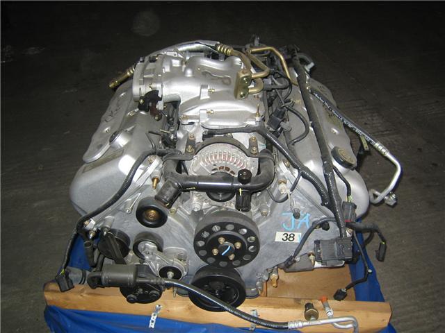

I already have a 400 bhp ford 5ltr Quadcam Modular motor for it and a porsche 930 gbox with LSD thats already been inverted. I am hoping to knock up a DIY 8 stack injectionsystem and a DIY dry sump kit to run the motor as low as possible without having to cut the fibreglass engine cover for clearance.

The first two pictures are the parts i have acquired so far and the remaining shot is of the last project i worked on.
I managed to get a good deal on the porsche box and bits, however 1st gear maxs out at 58mph and 70mph in 4th is 2400rpm on 27" wheels. I am thinking these ratio's may not be suited to my needs and tbh my heart is still set on a 5spd G50 so i may end up selling the 930 if i can get hold of a bargain G50 and will keep the clutch, starter etc.
