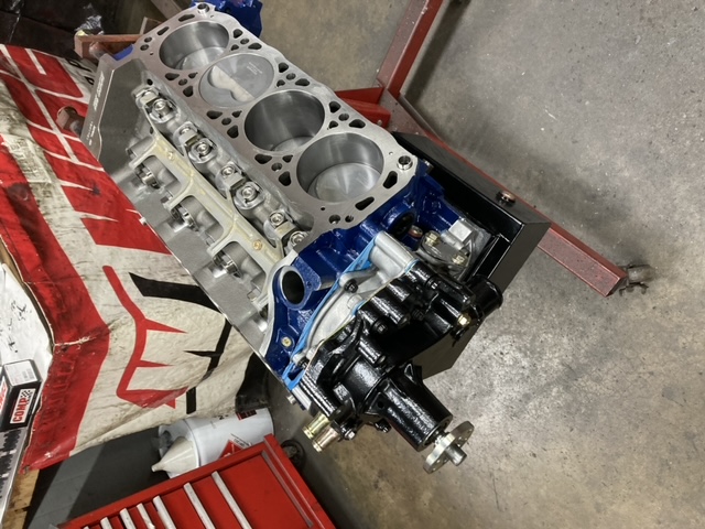

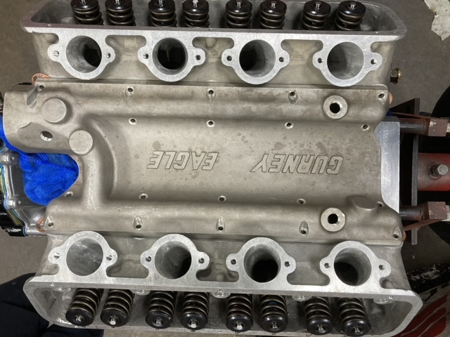

So I have been accumulating needed parts to start the install. I now have the clutch and bellhousing kit with 141 tooth flywheel and external slave cylinder. Then while the engine is on the stand I went through all the loose brackets furnished with the car without any assembly manual. Worked on getting the AC compressor bracket mounted to the right side of the engine. With the Gurney heads the mounting holes are different and the Motorsports block had the boss casted below the head but not drilled or tapped. I was able to get two in the head and drilled and tapped 3/8 hole in the boss under the head and add a third mounting bolt for the AC bracket.

David Garton

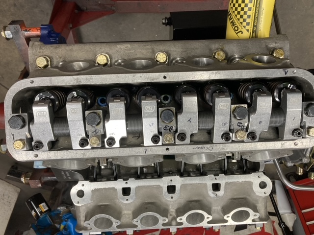

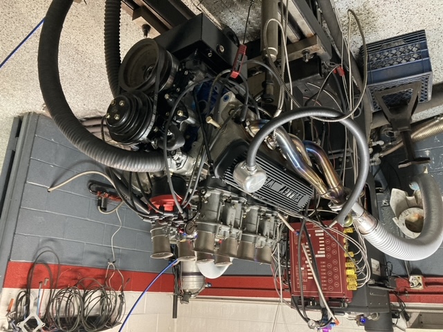

I removed the long nose waterpump and installed the shorty pump from Ford Motorsports . Ordered the double pulley kit from CVF billet pulleys. When ordering they ask factory or aftermarket balancer. Well I said factory and the Crank pulley was an inch short from lining up with the water pump pulley. No biggie because when I called technology they had the adapter in stock and sent it no charge. I was so happy I went back online and ordered their double grooved alternator pulley. After going cross eyed over trying to figure out the loose brackets and pulleys with bearings and C-clips to retain them I have my alternator and AC compressor with all pulleys lining up and the tensioner adjusting tension on both belts and a very good wrap around the compressor pulleys and get to use both of the same belts. Thus leaving me plenty of room on the left side of the engine for the water pump hose and the thermostat housing hose that drops down the same side. All pictures are for fitment and alignment purposes and I am taking it apart and blasting the brackets and powder coating them one color.
