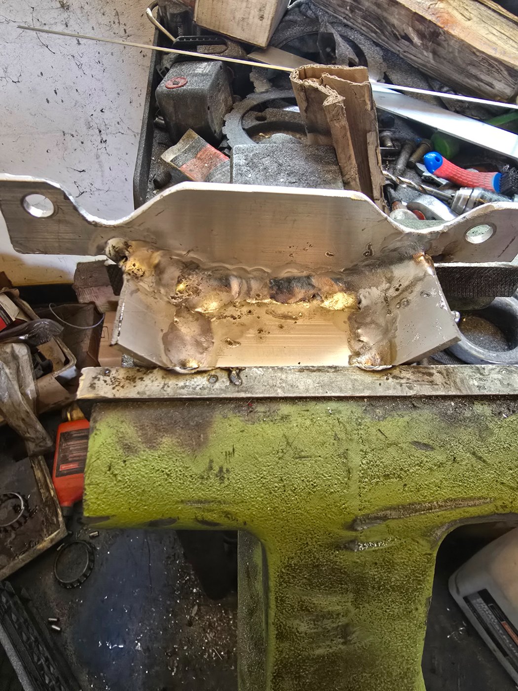

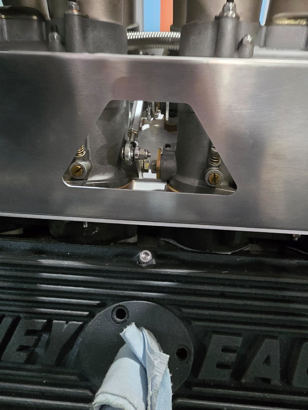

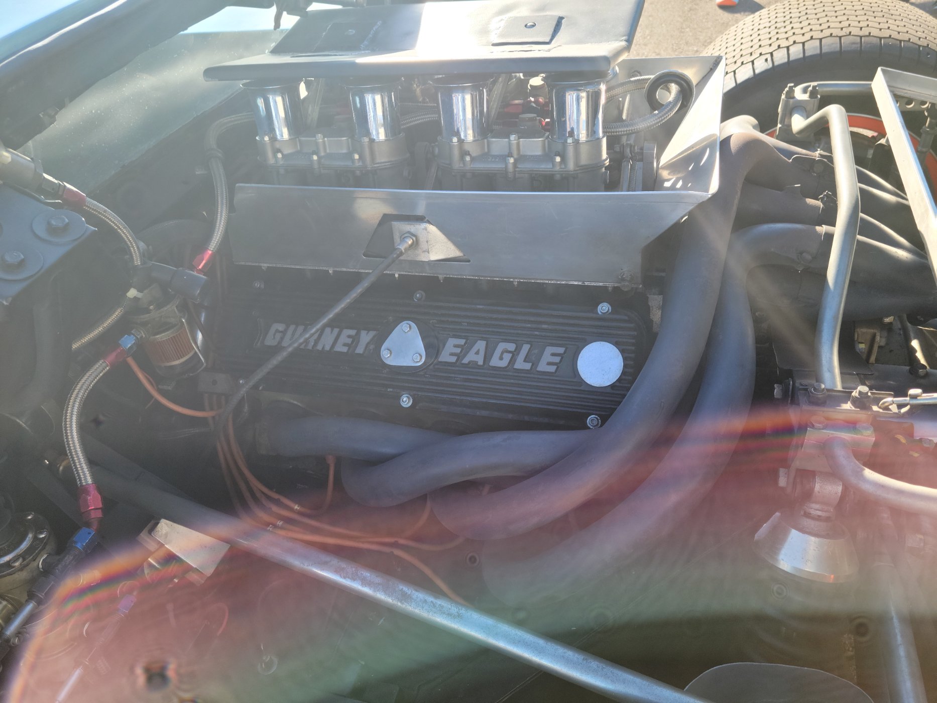

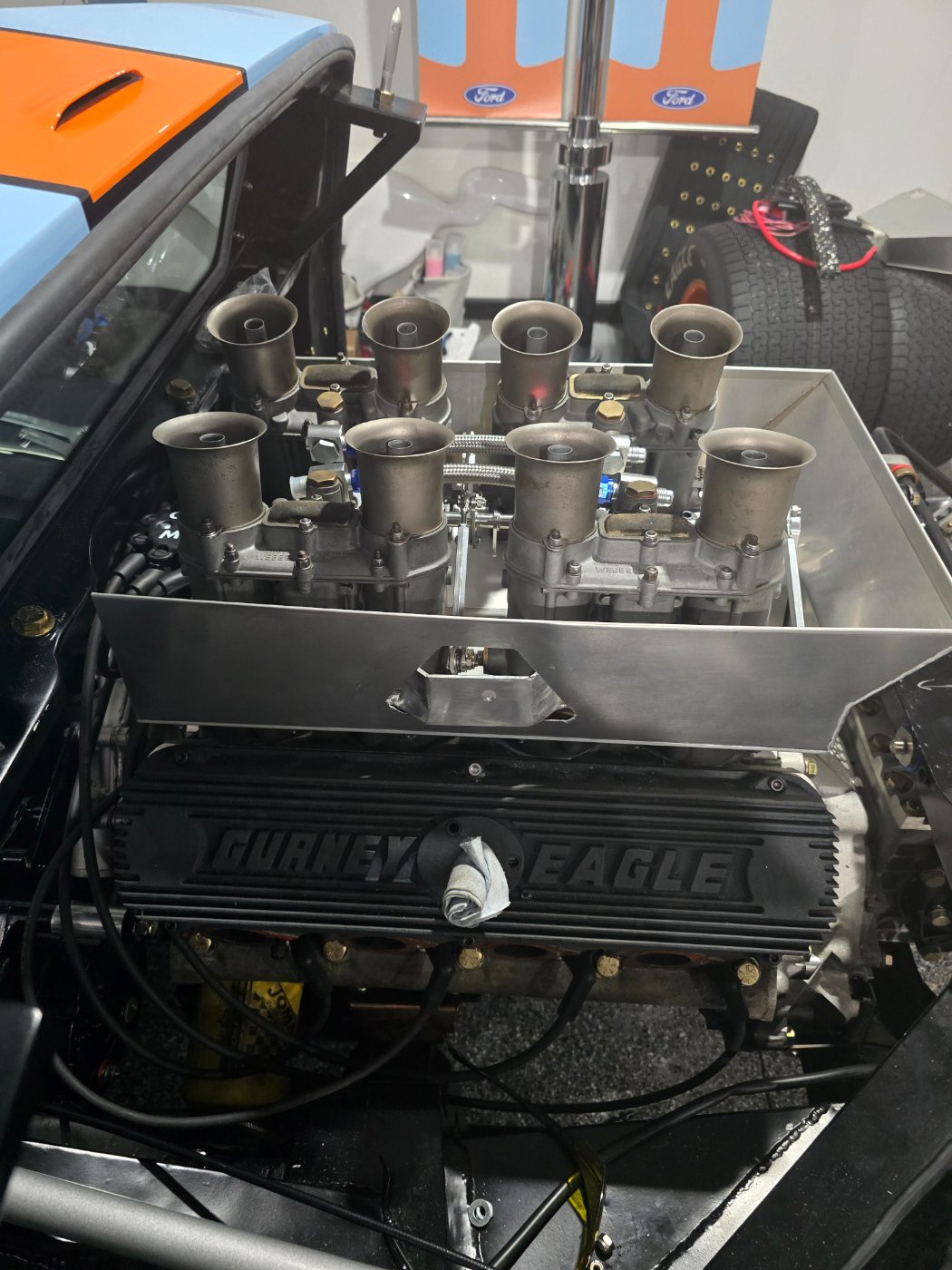

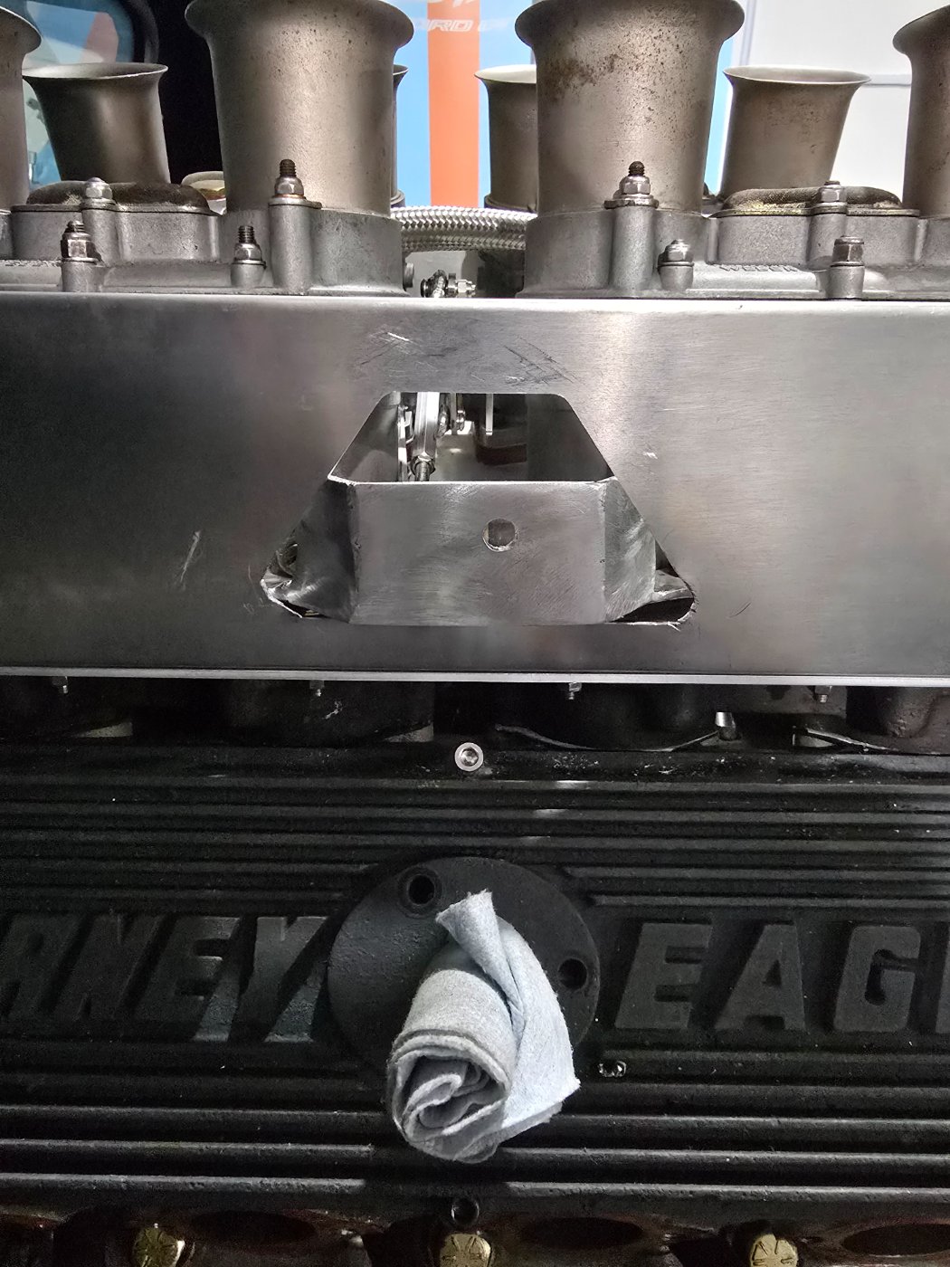

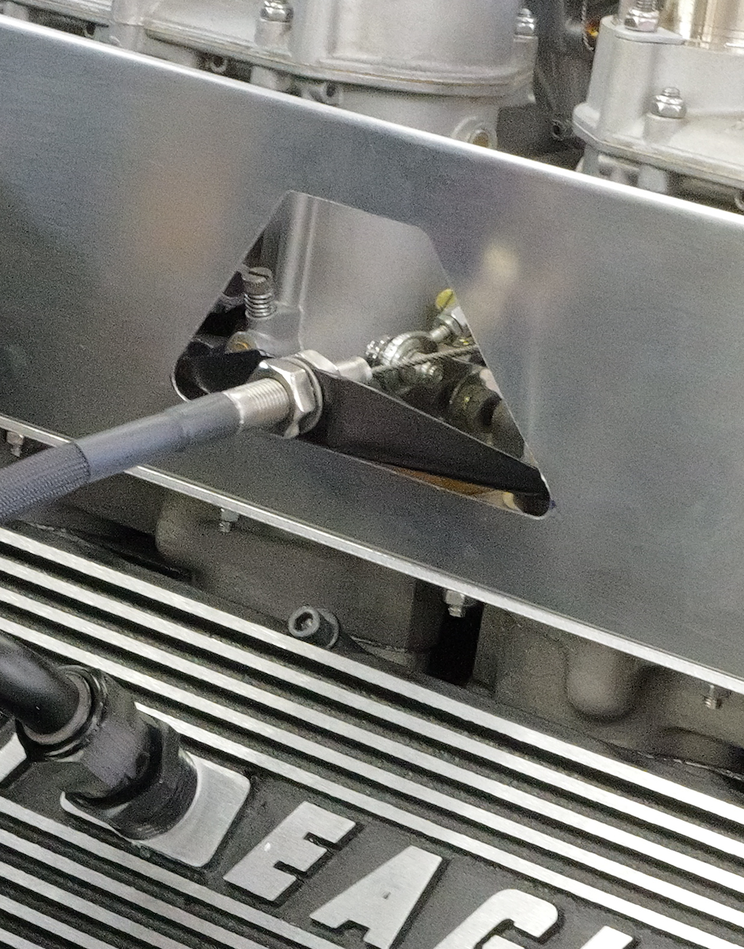

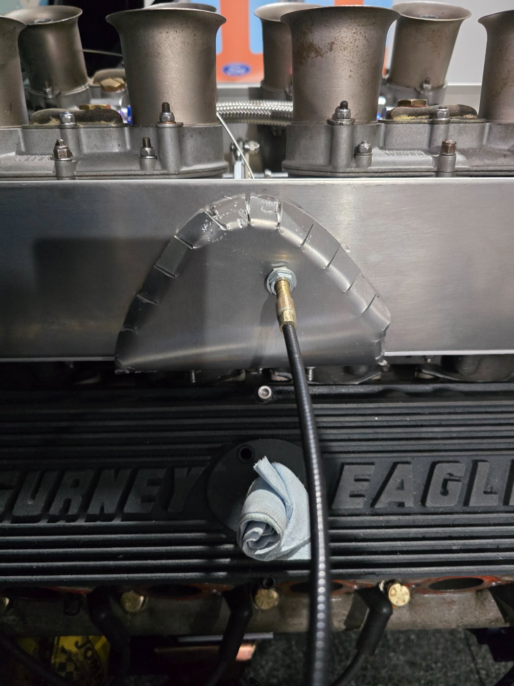

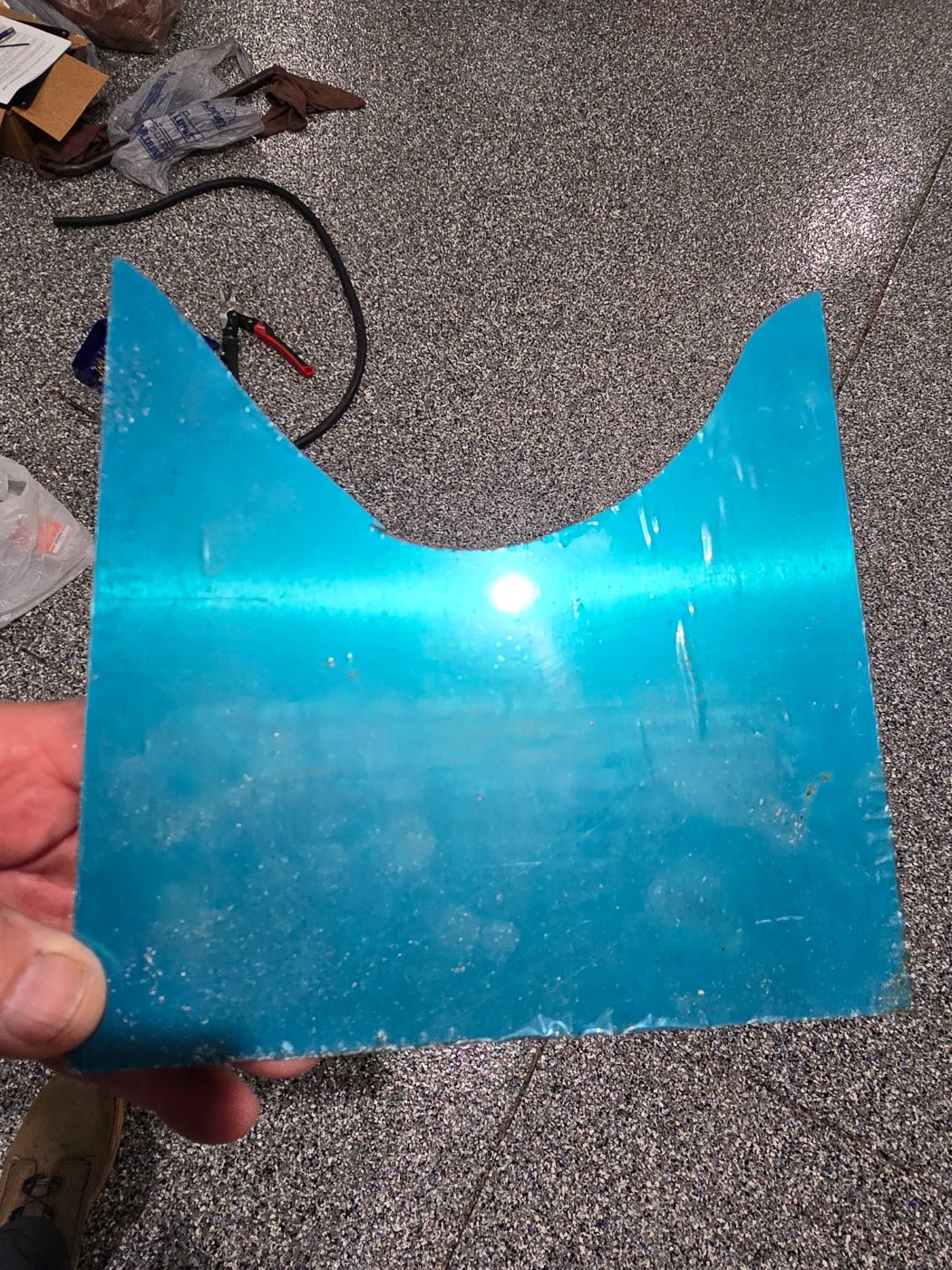

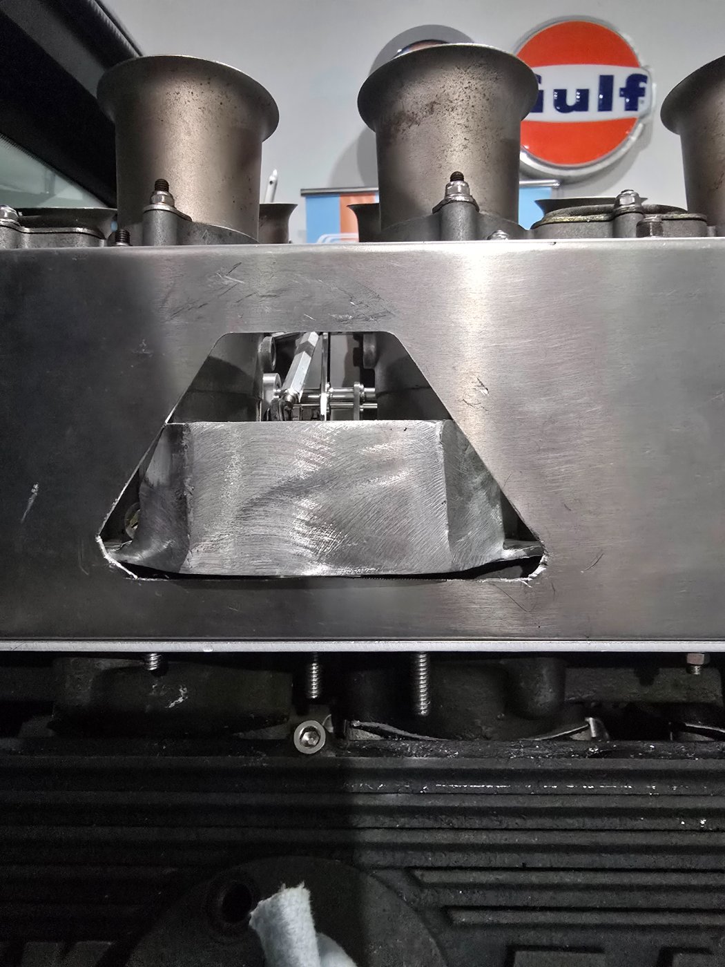

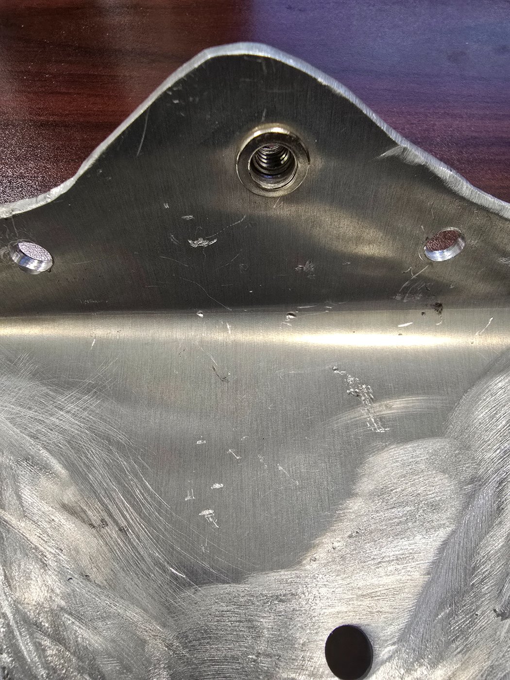

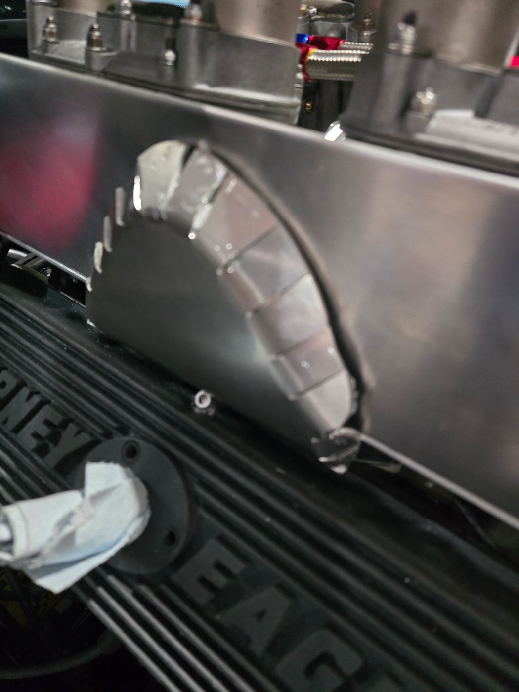

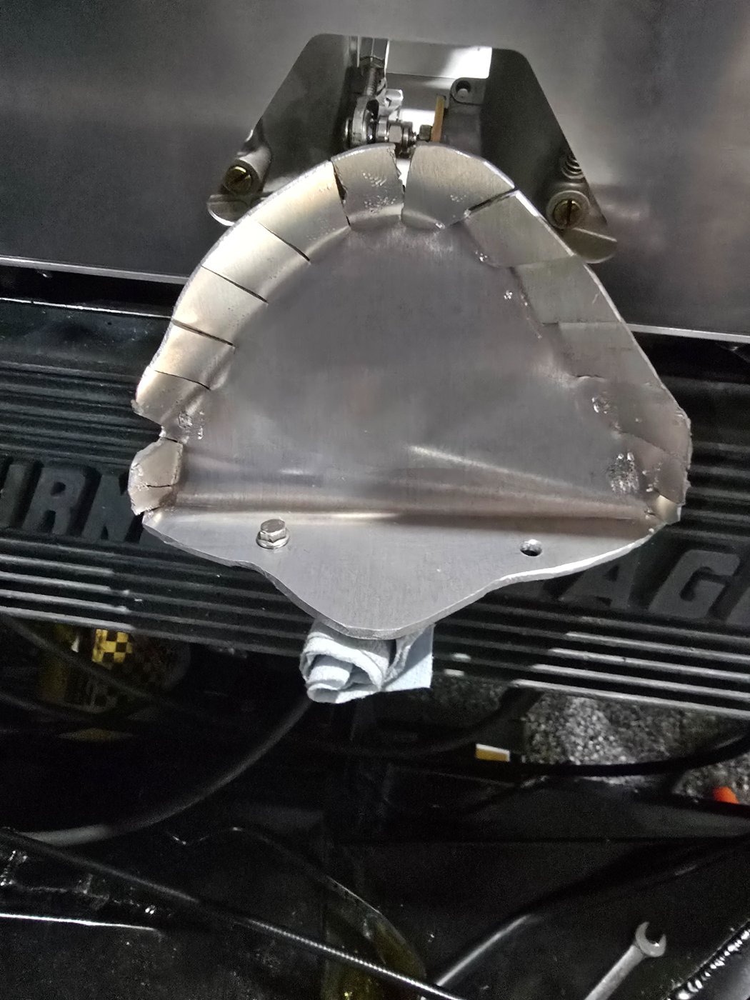

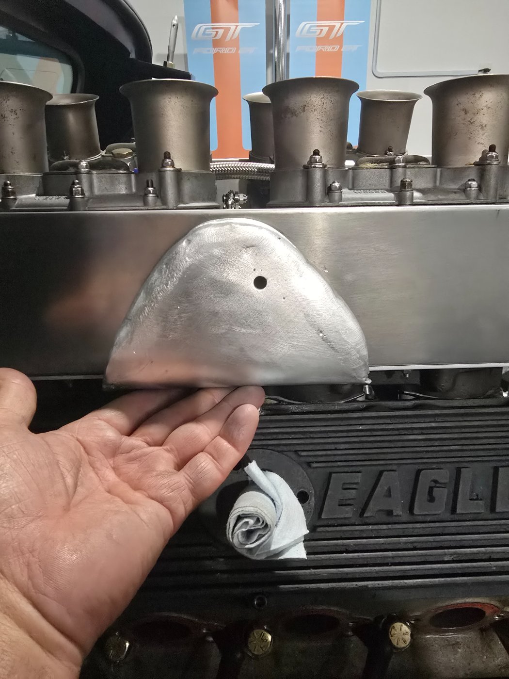

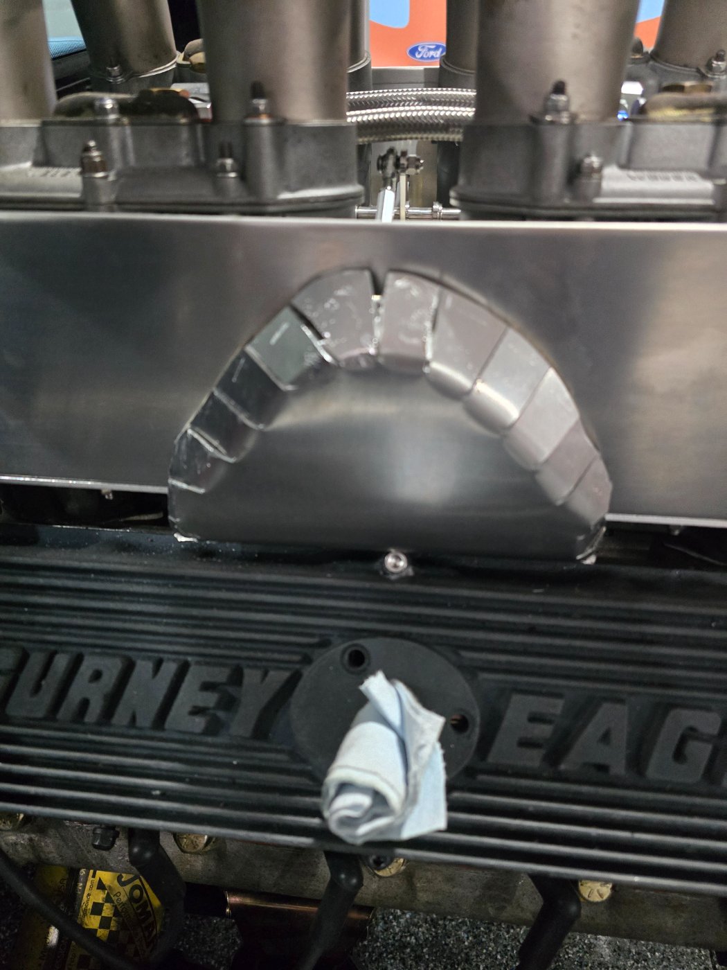

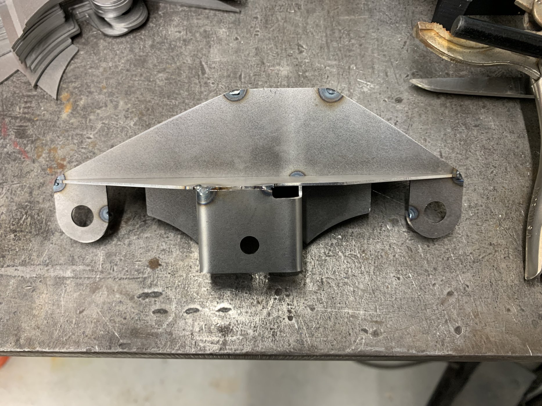

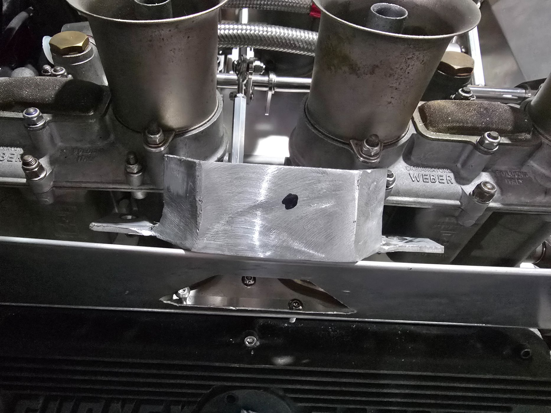

Ok pretty proud of my first time Tig welding with new Everlast tig welder and fabrication of an aluminum throttle cable bracket. From a sheet of aluminum to something looking period correct.

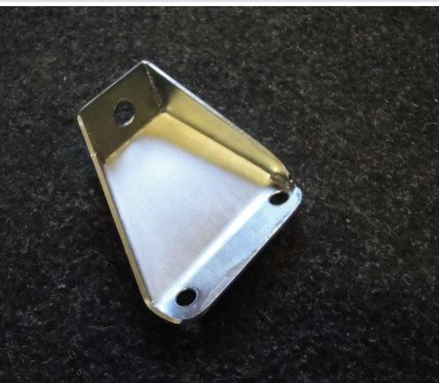

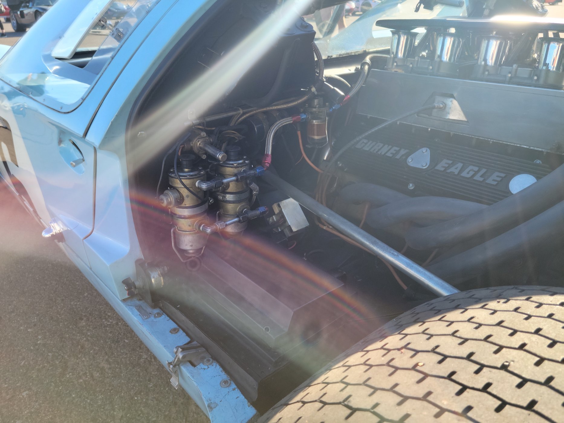

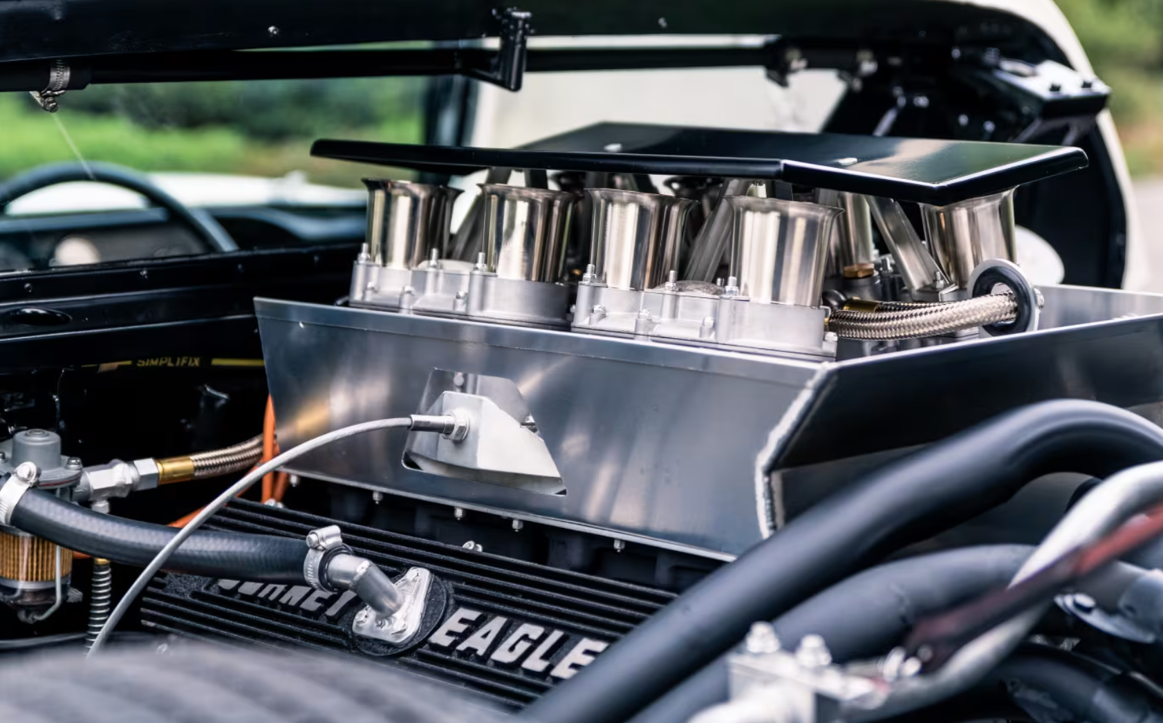

Rob Klein

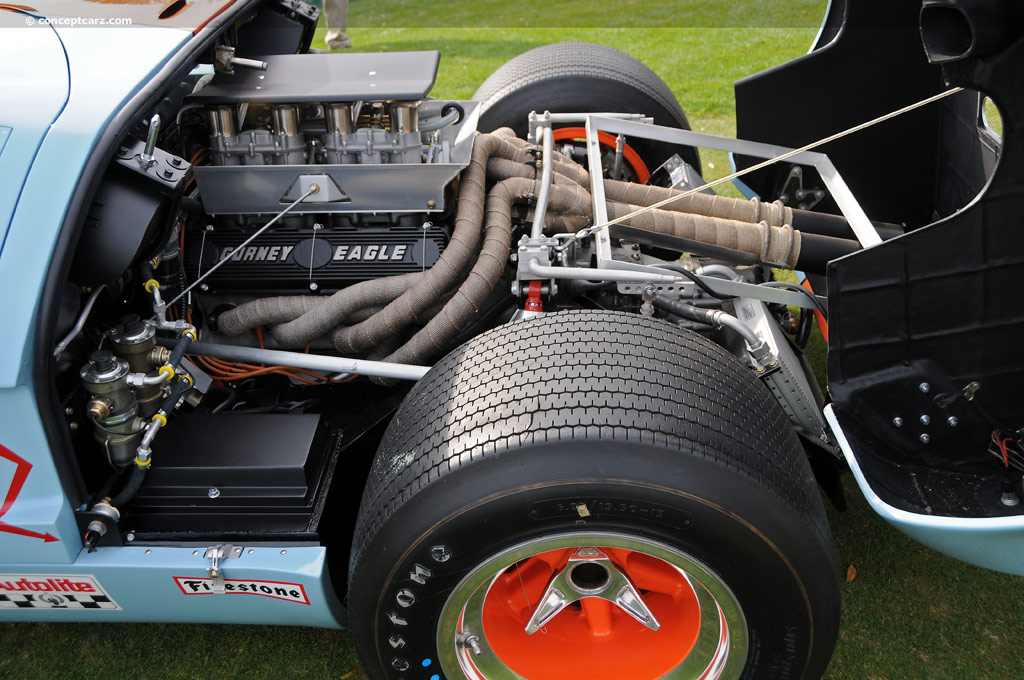

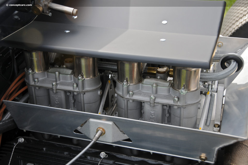

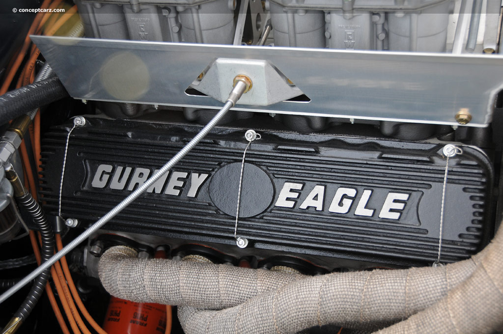

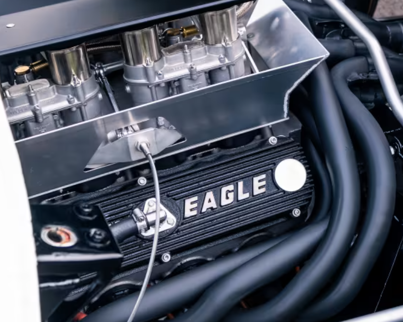

you can get these brackets from Gelscoe

David Garton

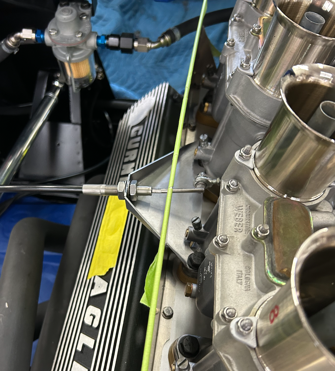

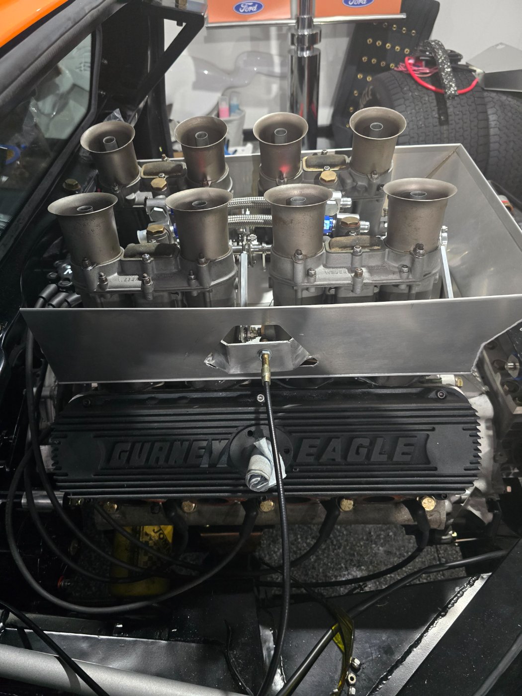

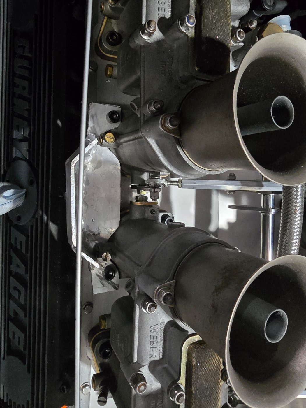

Rob I bought my Turkey pan from them but the second picture you show will not work on a Gurney headed intake spread. Now the other bracket you show is wider and is what I needed but they did not offer it for sale to me. I ended up bolting it to the bottom of the tray and I added a third mounting hole with a threaded zerk rivet to locate from the top and only have to nut the outside ones from the bottom outside.

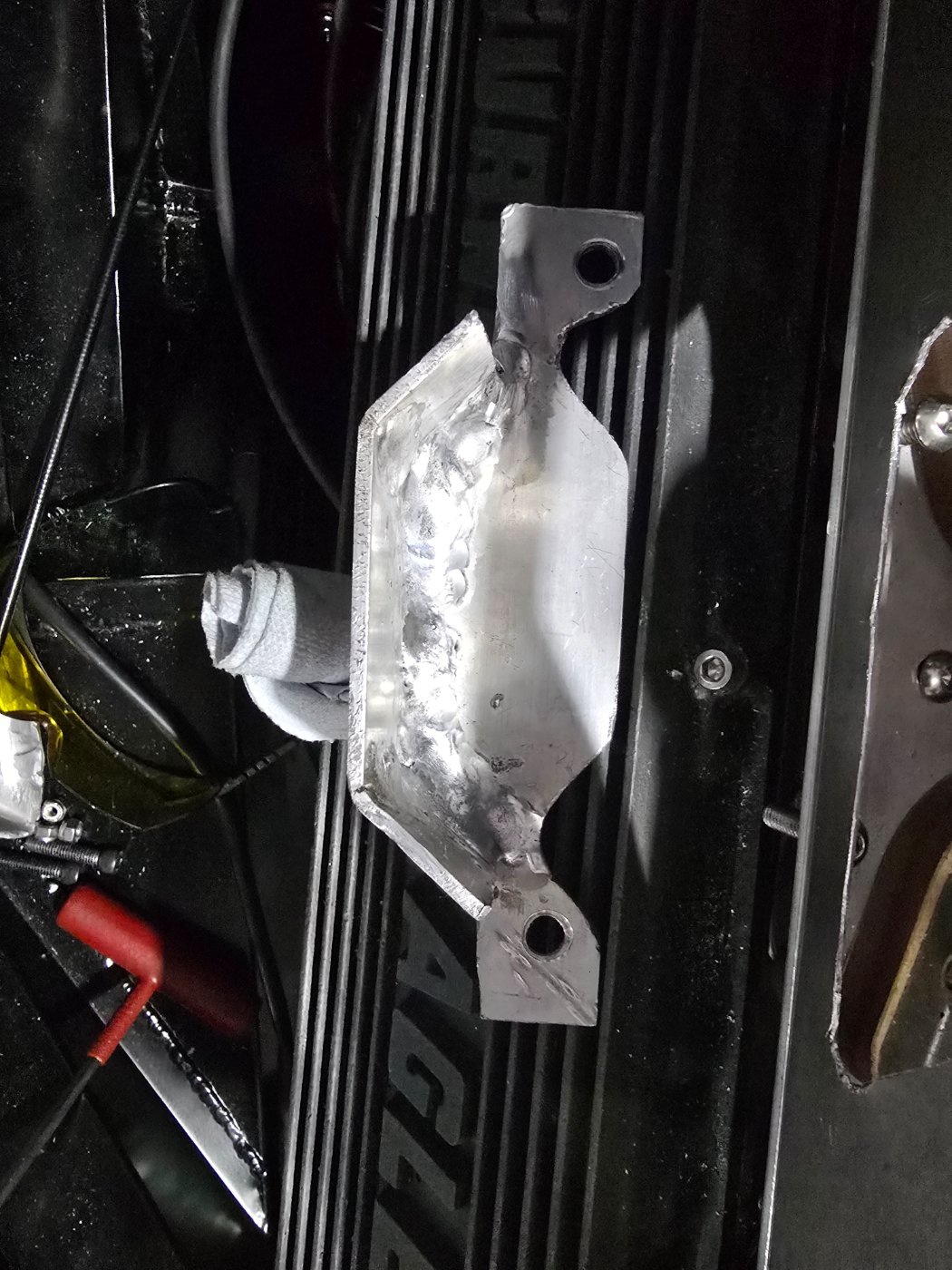

David Garton

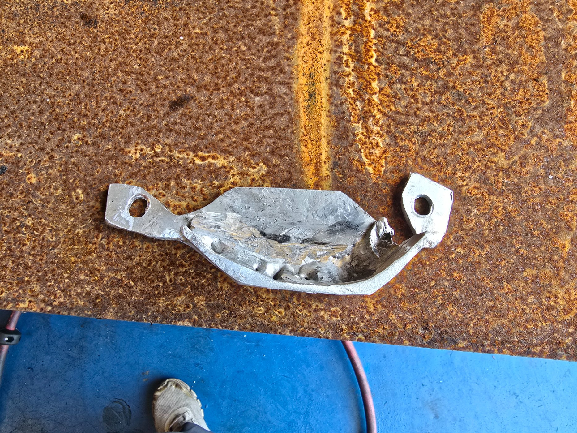

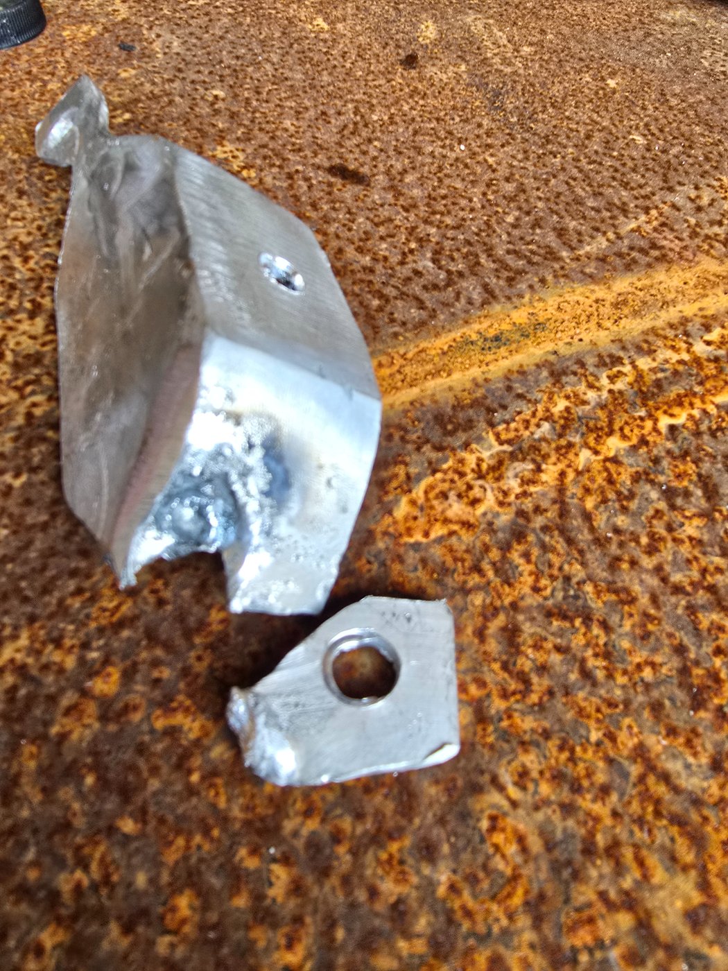

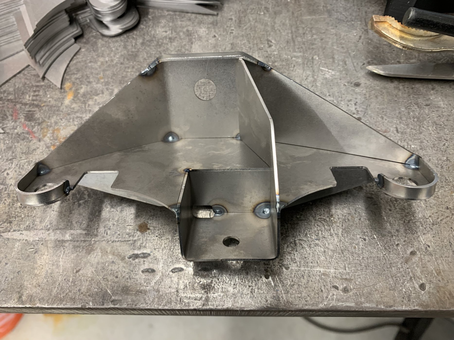

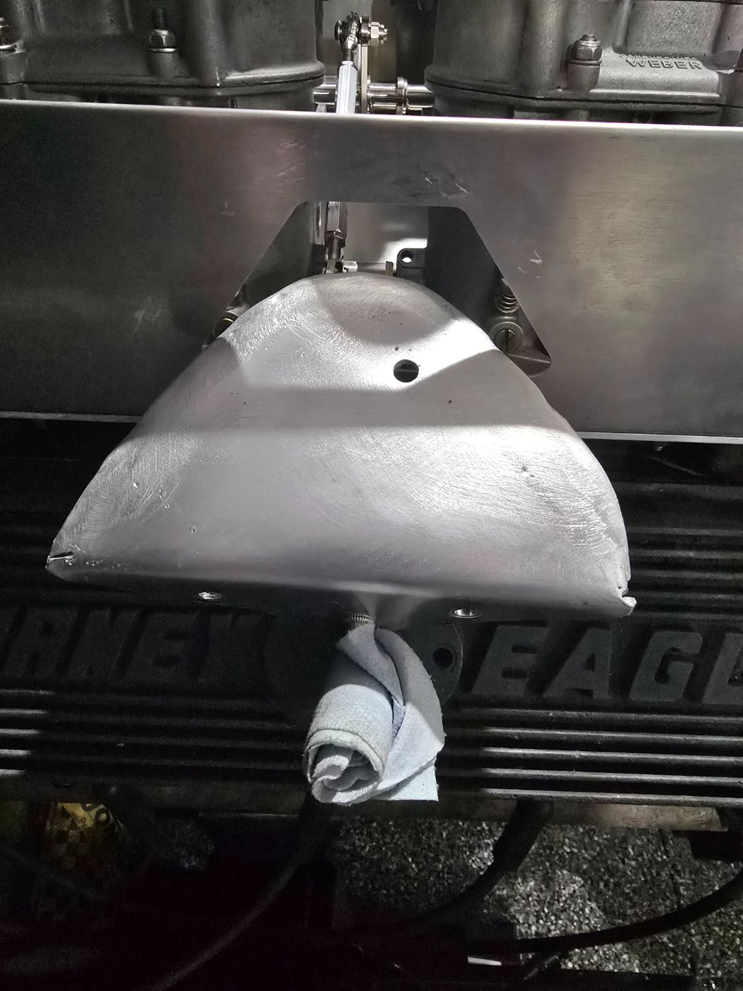

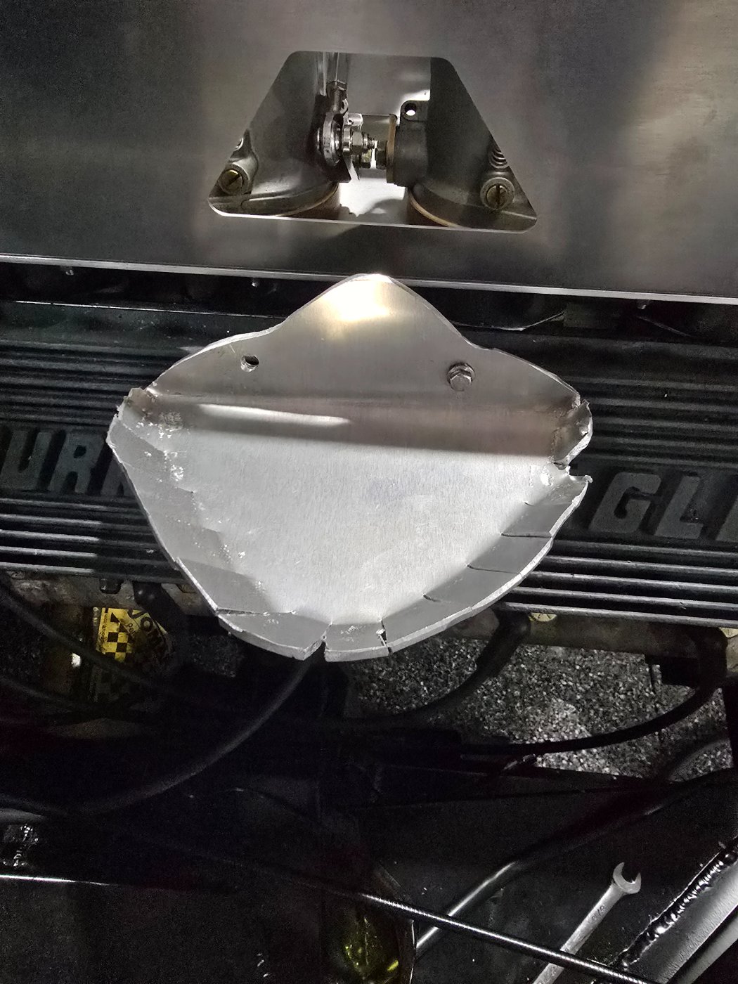

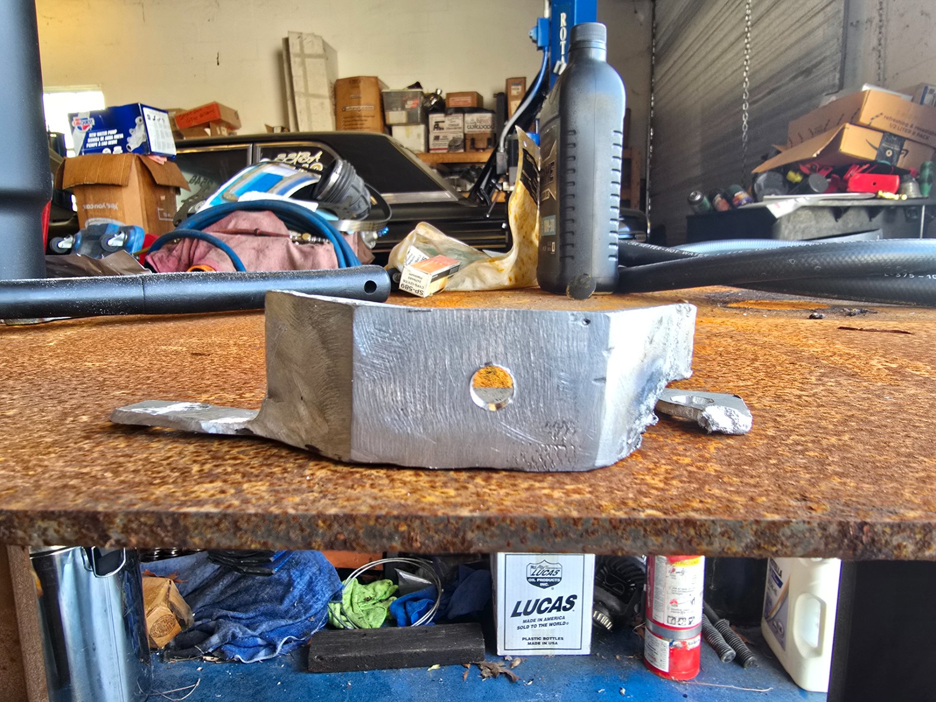

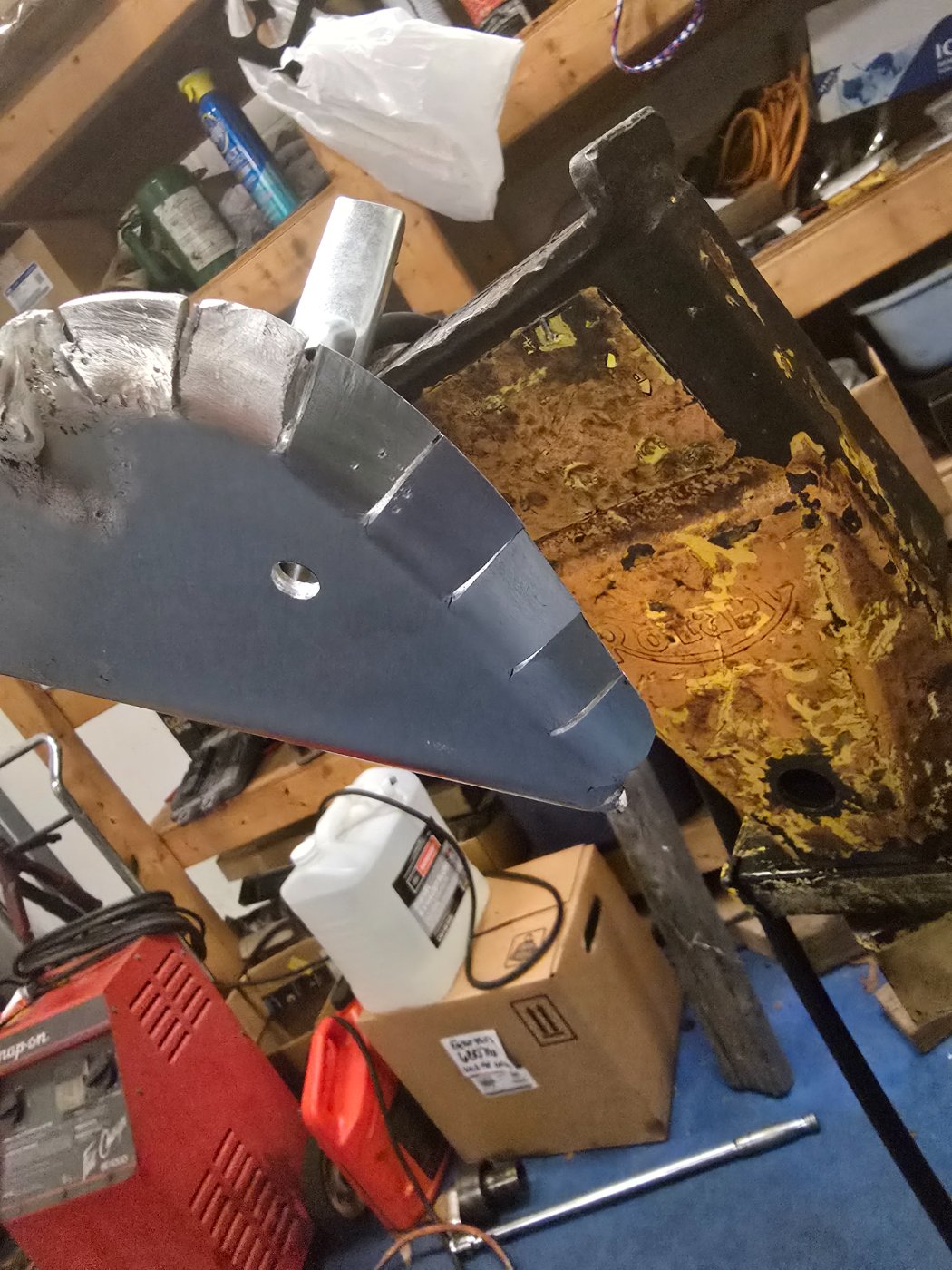

Well I was proud of my first Tig welding job. But then I thought I was getting pretty good at it so I bought some flat stock and tried to make a more authentic one. I was doing good until I tried to fill in a dimple and melted the entire foot off it.

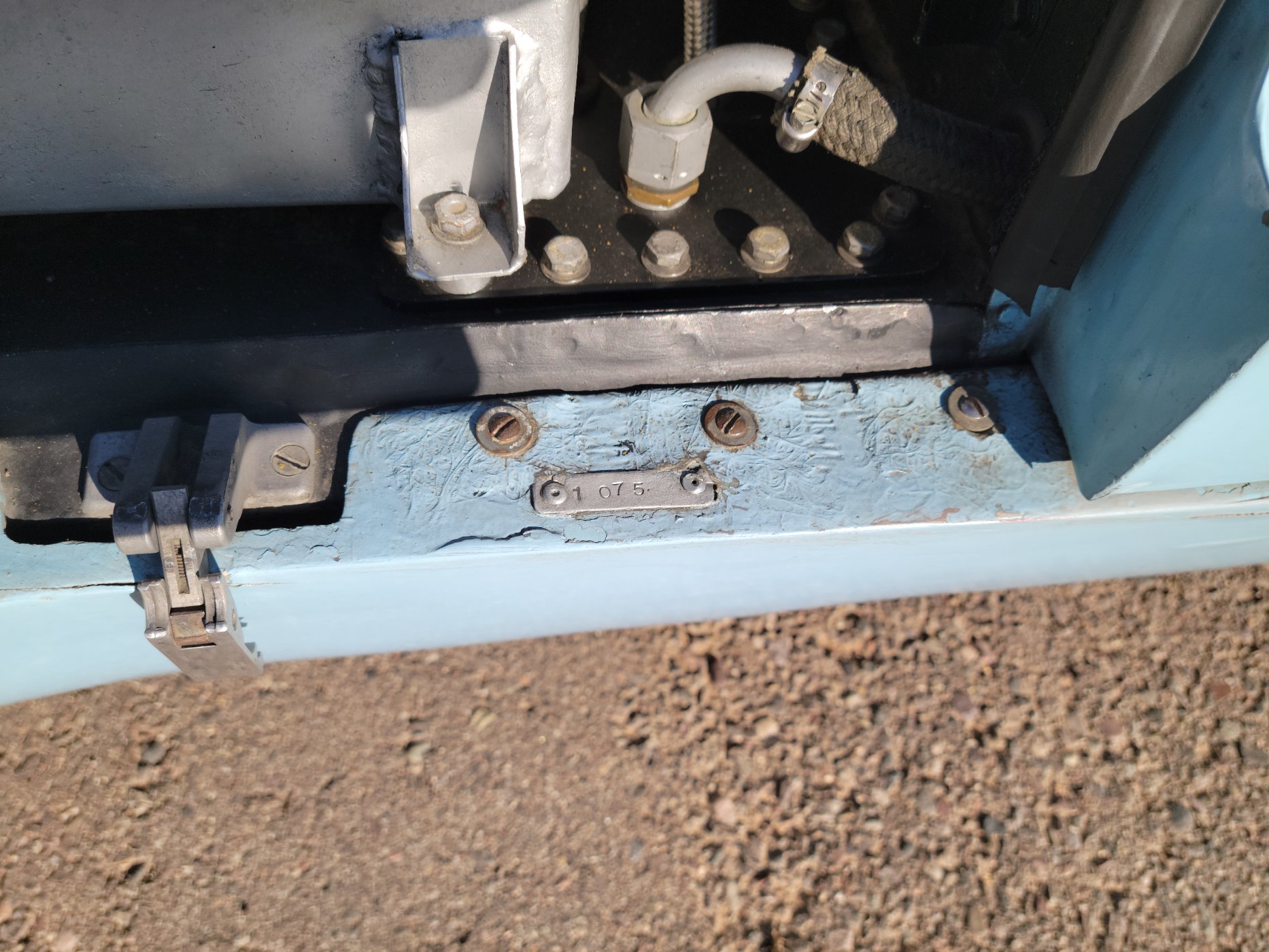

Rob, Thank you. Mine mounts the same way. Here's a picture of P1075. I did get a trophy at the end. Ouch. Yes I had gloves on.
1075 is such an amazing car, but holly crap it looks like a tinder box. I get keeping the car as it was when it raced, but it seems like a light restoration might be a good idea. But what a hard decision.
If you owned 1075 would you clean it up, or keep it as is?
As is . You can't replicate that patina. But yes I agree with cleaning it up some inside and under the clamshell. That picture was taken in November 2021. Ford Performance surprised us at a GT rally when they took it out of the trailer.

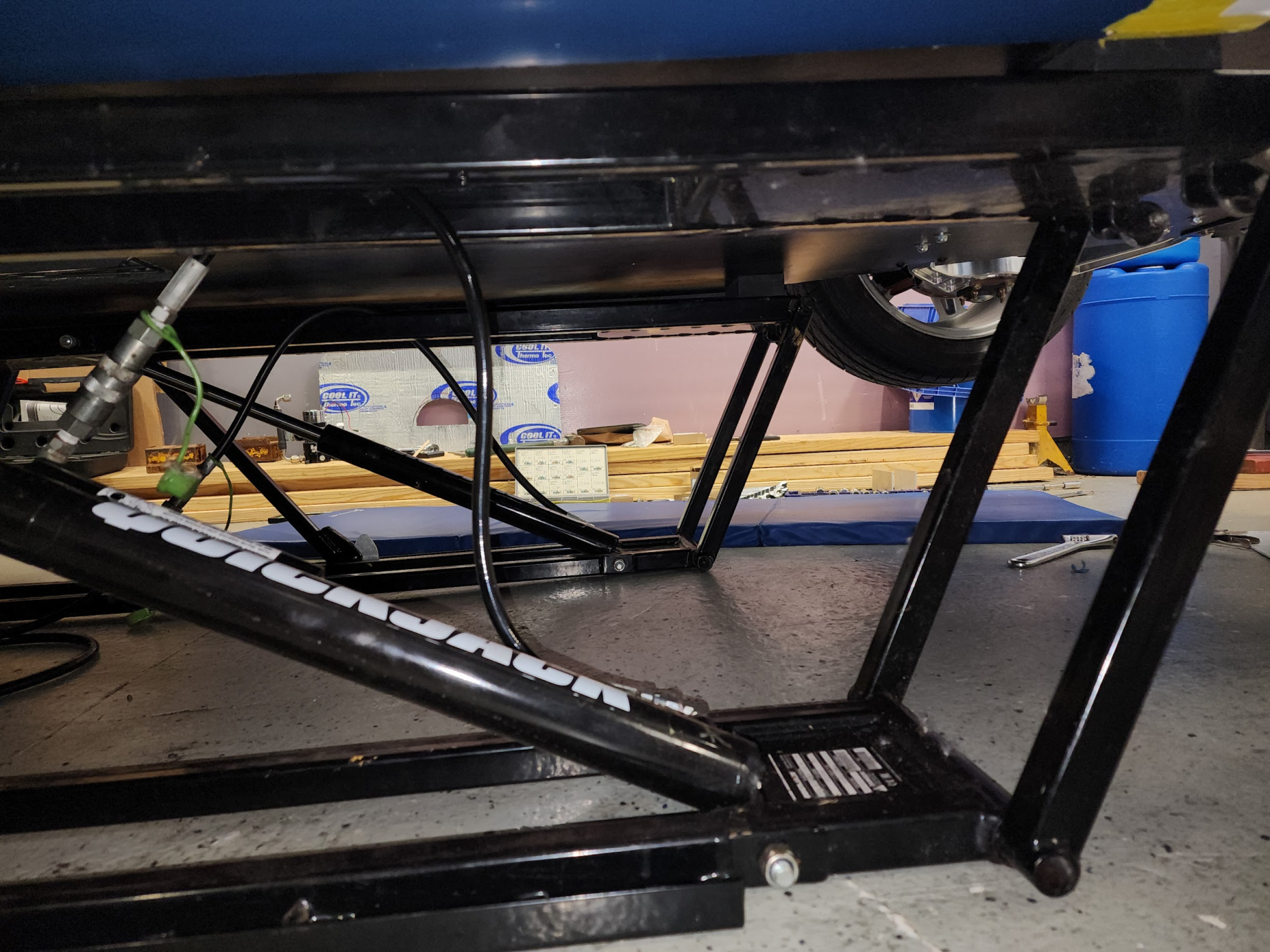

Robbie, my Quick Jack's 6000 and are longer and heavier duty then the 5000's and work great. I bought them on Black Friday sale for under $1500 free shipping. They come with two thickness blocks. I put them forward where the lower control arms meet at the frame and rears end up under the crossmember. Photos of model numbers.
