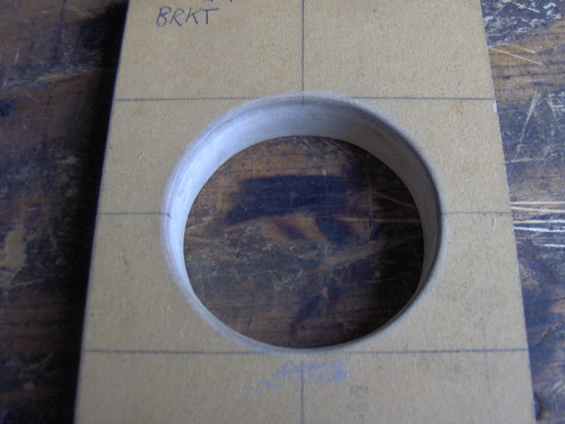

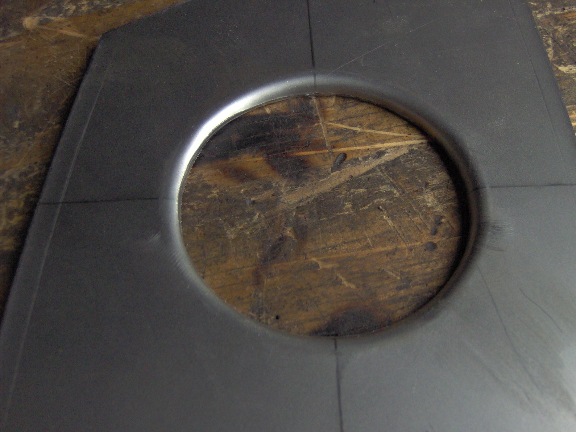

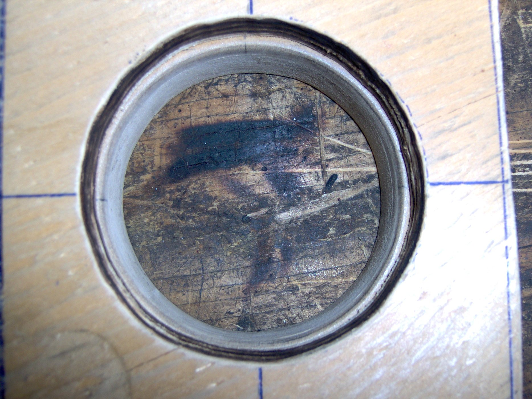

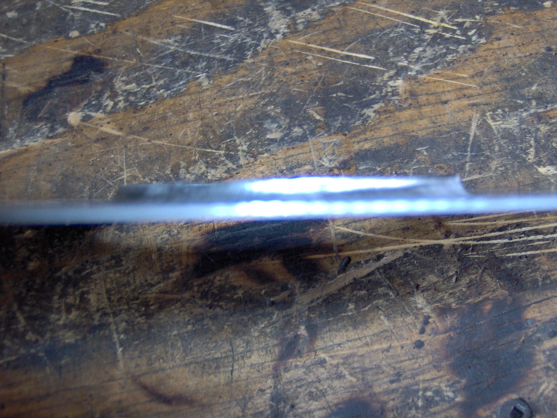

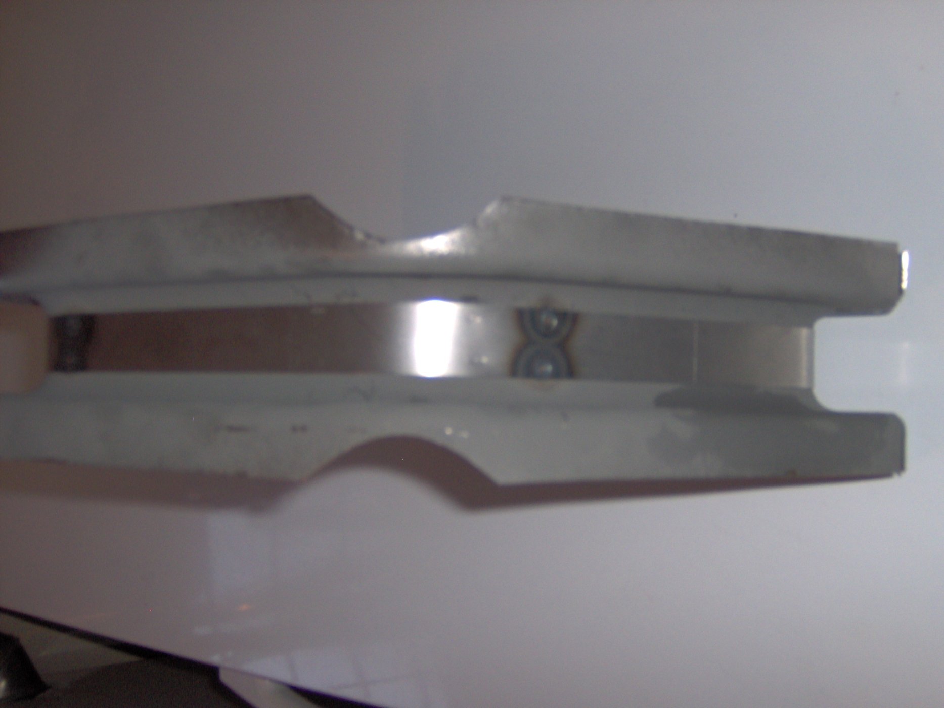

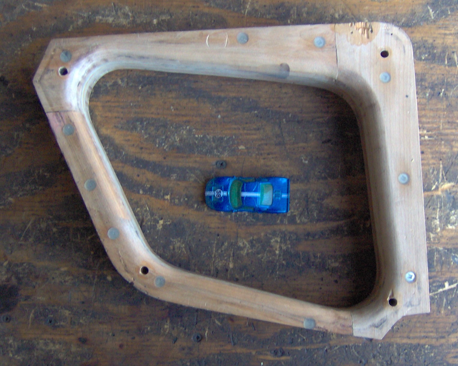

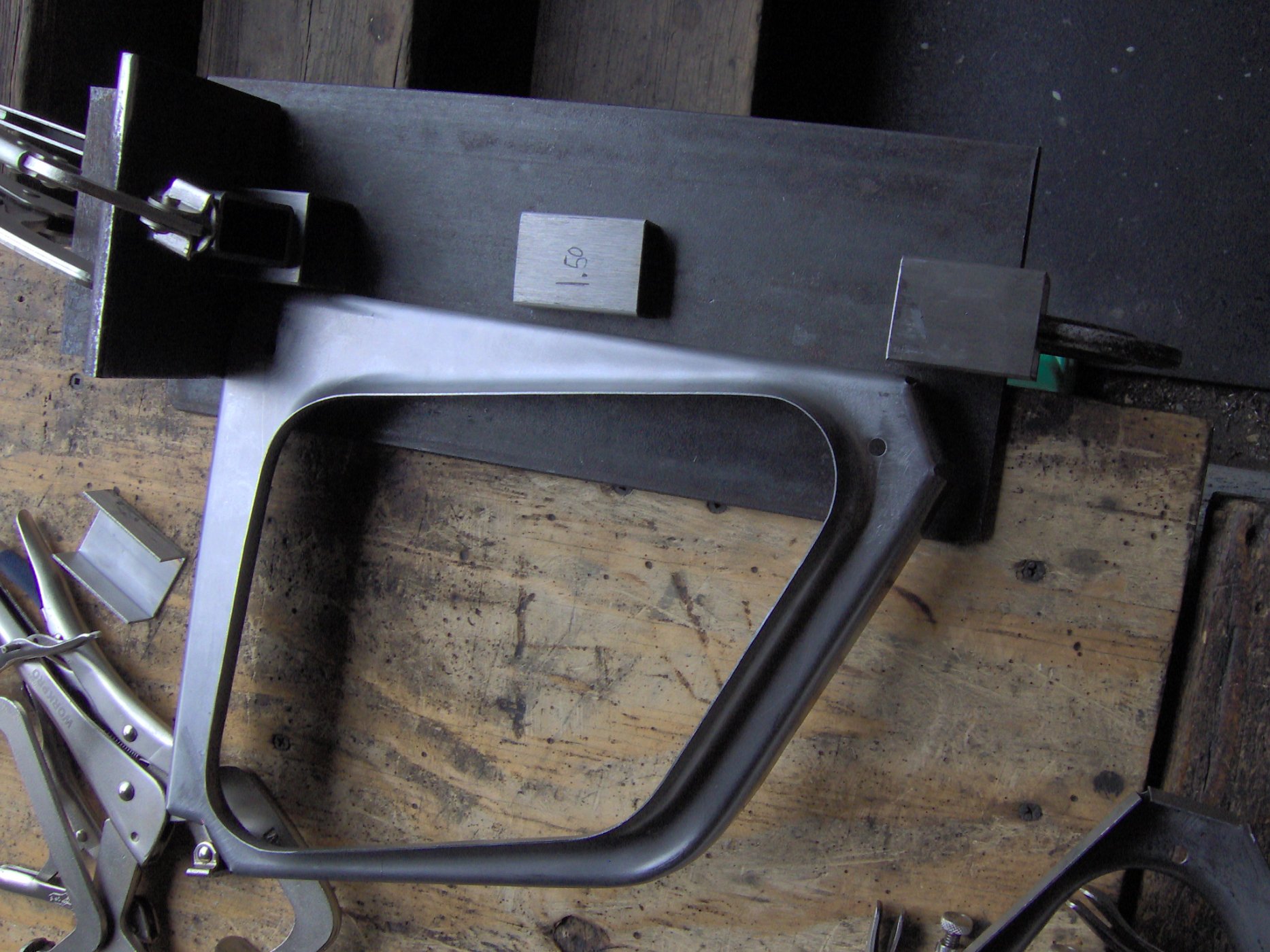

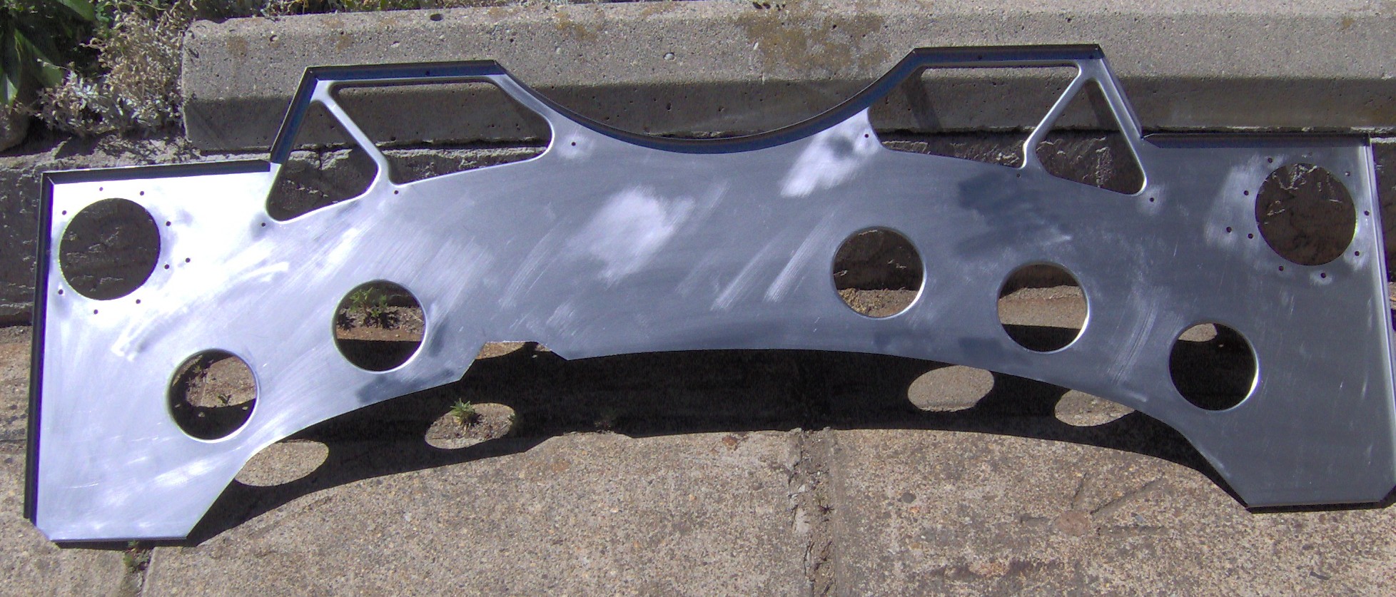

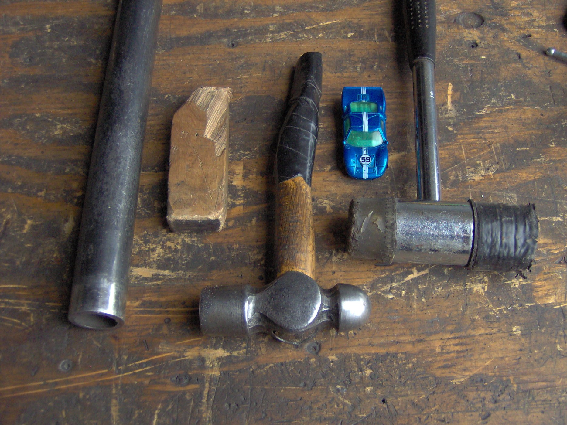

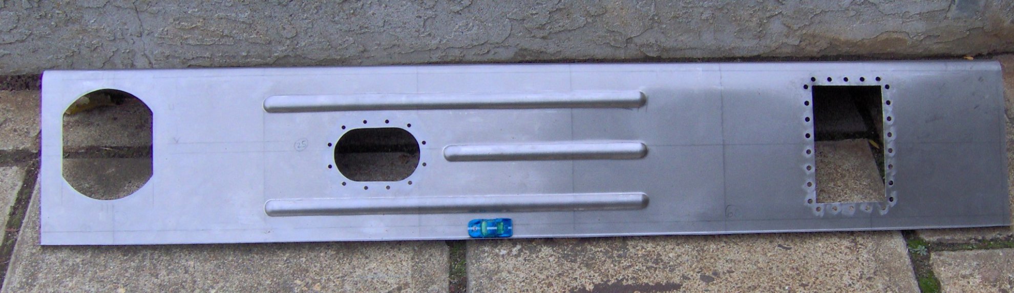

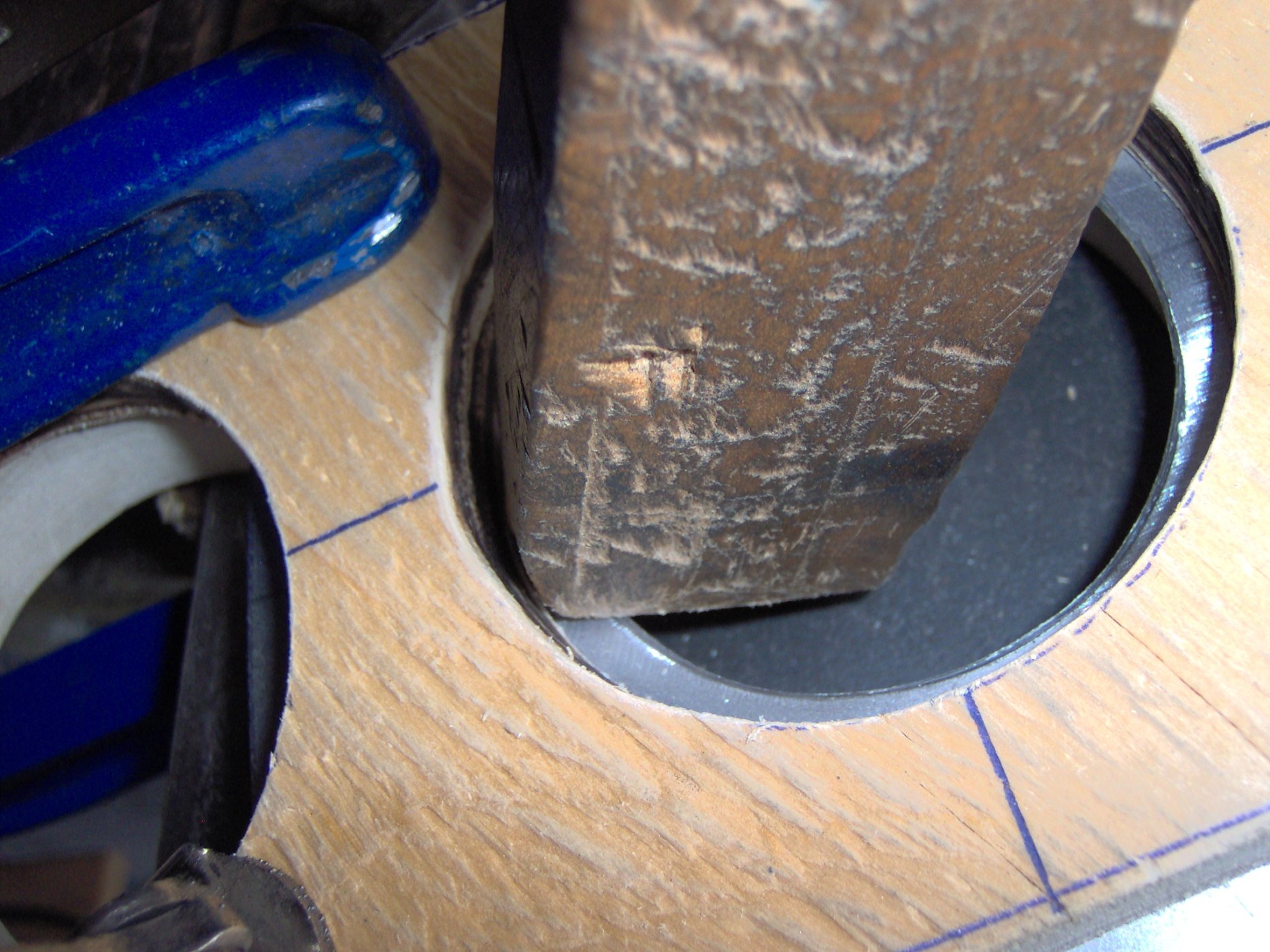

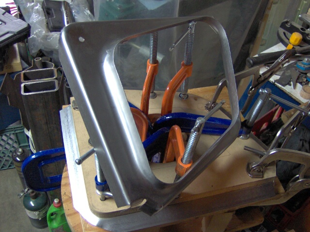

I have been asked how I go about making the lightening holes, so I will show how I do it with out dies.

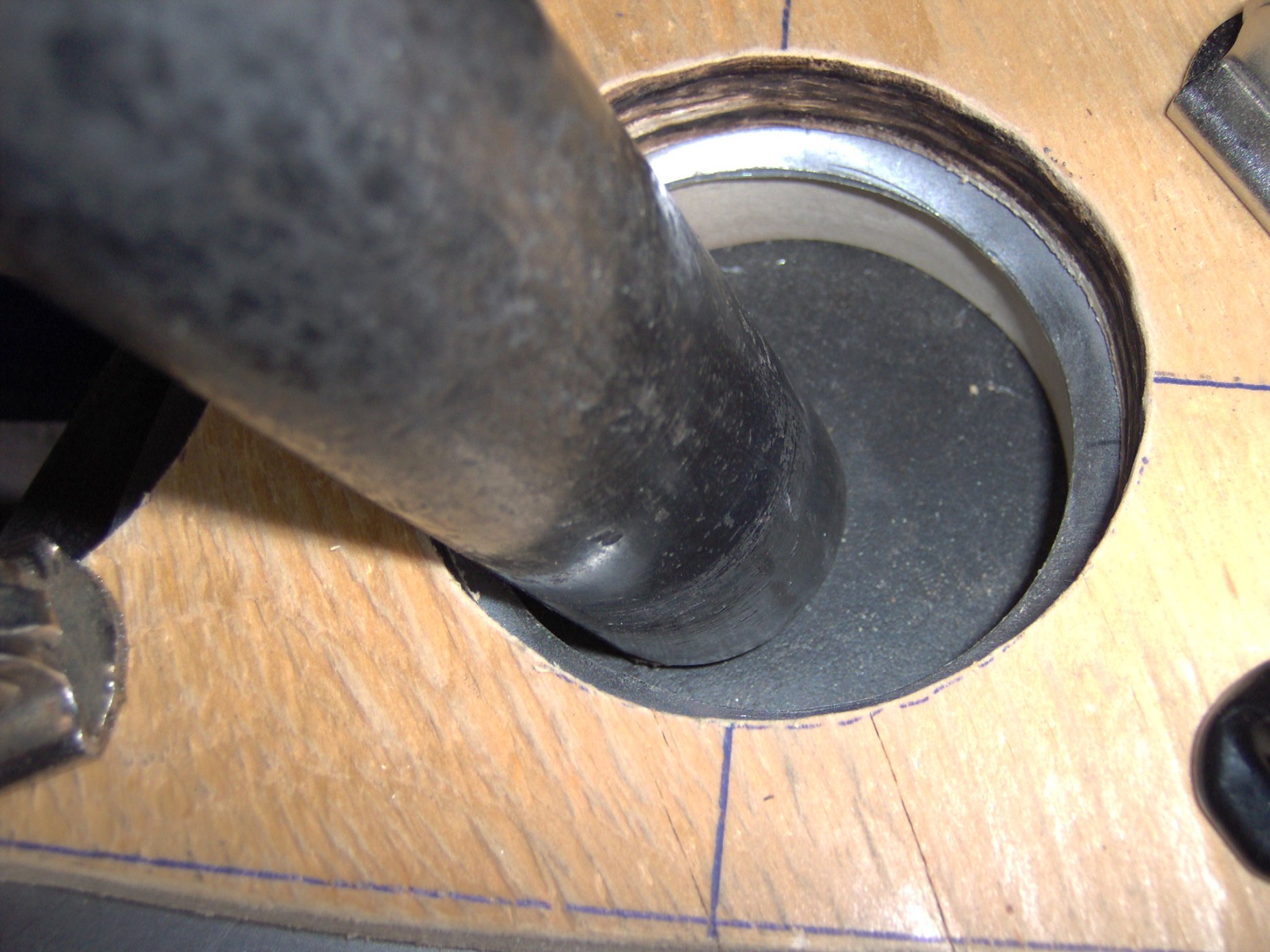

Simple tools needed ( Tools1 ),MDF the size you want with radius ( MDF-Radius2 ),Top Plate to clamp it all together ( TopPlate3 ), Hard wood to tap metal down all around hole ( Tap-Down4 ), I tap on the side of a length of pipe to bring down the metal and snug it up to the side ( Tap-DownFinish5 ), Top side of hole ( TopSide6 ), and a side view, not my normal finish work this was just quick to show how I go about it for now.
Very nicely executed Dave. Looks very nice to me. I'm sure we are our own worst critics.
Are you using anything special to radius your MDF template?
At some point when I was drawing the chassis up in CAD I started to realize that most of the holes were of a similar/common size. When you see it done like this you realize that it was probably due to the availability of common tooling. Either hole saws or press punches that would allow holes to be knocked out of the sheets.
Regards Ryan
Thanks Ryan, I use sand paper to radius the MDF or a file at 45 and finish with 150 grit.
The example was made with 20ga, I'd only use MDF for up to 18ga then go to a steel or aluminum for forming thicker steel.
David, have you seen the method that Ron Covel uses for setting up the bevels on the edges of his hammer forms? He just sands them in as you describe. Could be handy for some of the other details in the build.
Ryan
The sanding dust gets everywhere and is very fine so be sure to wear a good mask, I do all the wood work outside but the dust still makes it's way inside even with a fan blowing out.
For a large amount of material to be removed I use the 4 1/2 grinder with a sanding disk it hogs out the MDF very fast with a large dust cloud.
good tips David,
PS, I included that Ron Covell video as the method he explains works for instances where you have to vary the radius between two different profiles or transitions. This is something that you can't easily do if using a round over bit in a router.
