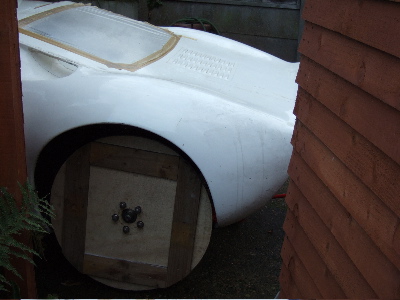

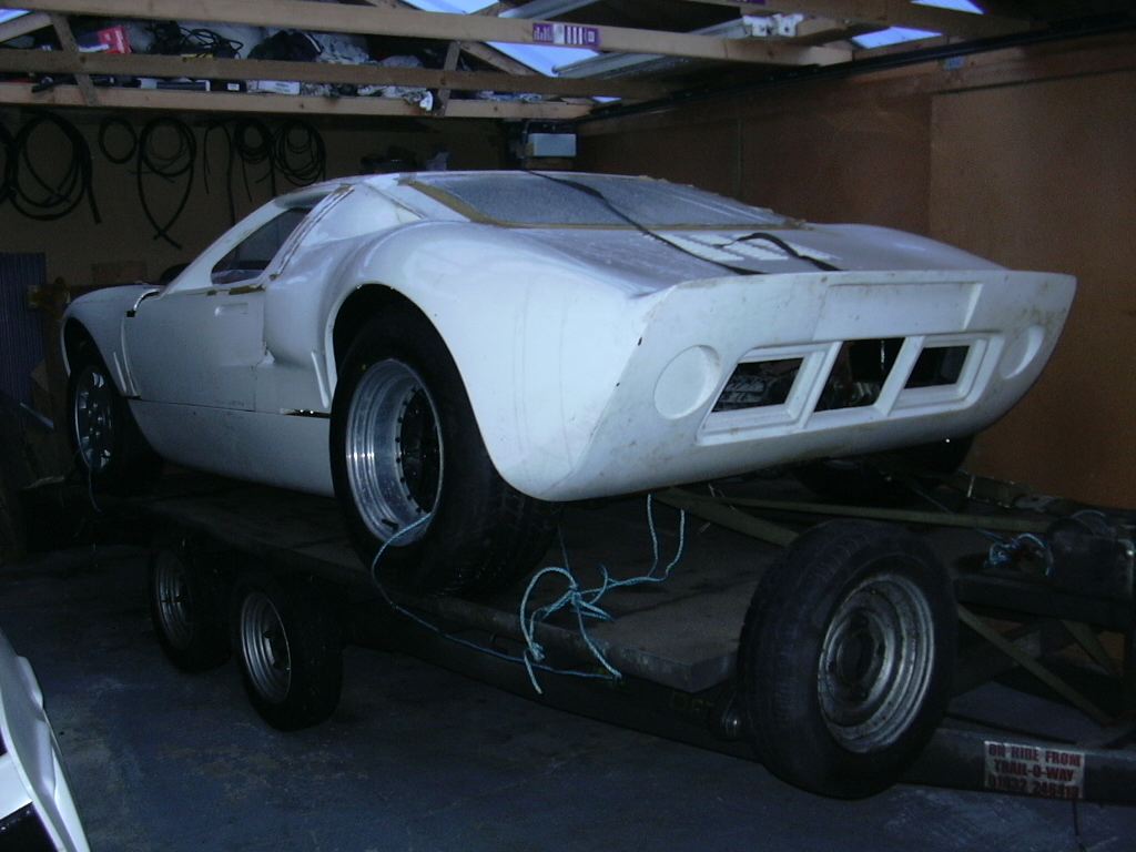

Bugger it all we needed was something to allow us to roll my car back into the garage when Paul's was at SVA.
Decided if we spin the car - swap the front wheels (they worked and fitted)
sttach a chariot wheel in timber - Roll it into the garage, remove the last rear wheel and place on axle stands.
We thought that this may be able to rake right hand bends but on lefthanders may battle for grip!

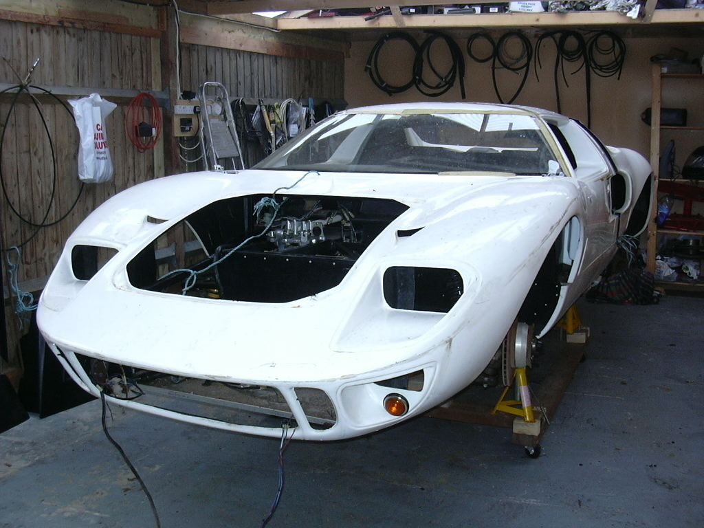

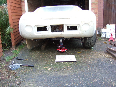

Got to Paul's As usual it rained when this car came out the garage

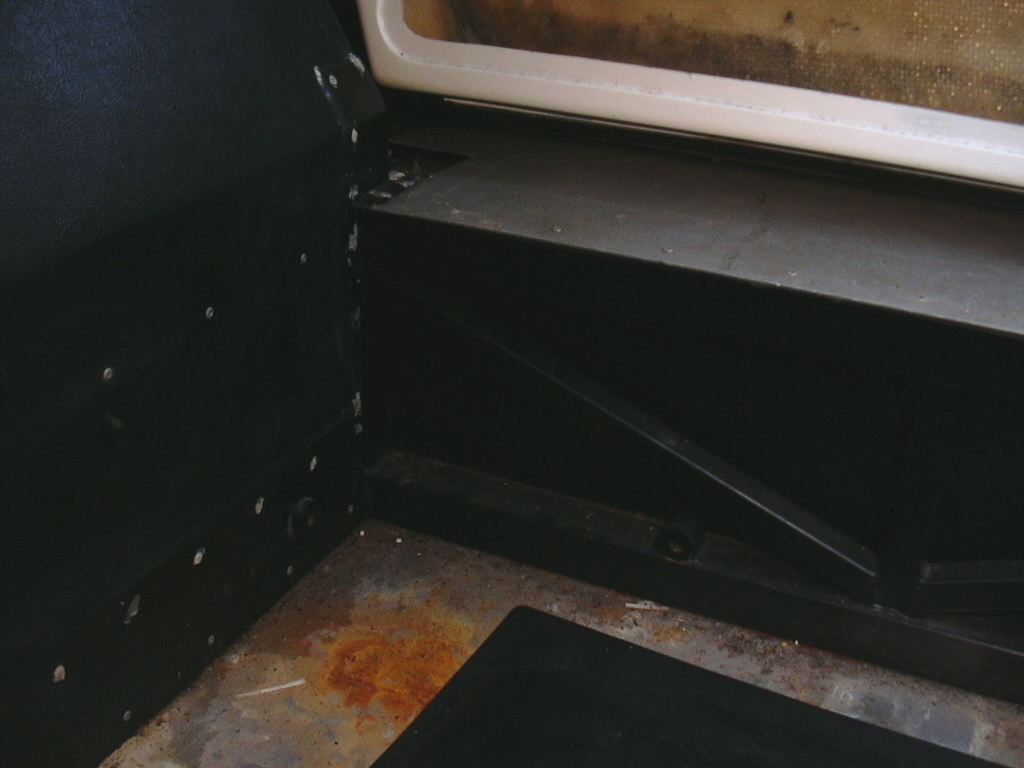

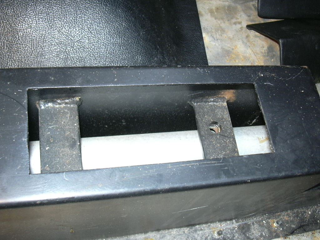

Pictures for SVA re Seat belt mounts (If any one is reading the SVA will want to confirm how the Belt brackets are mounted - photo evidence is acceptable)

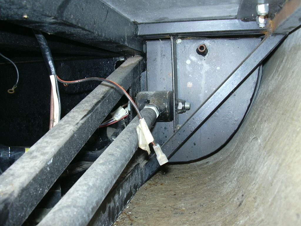

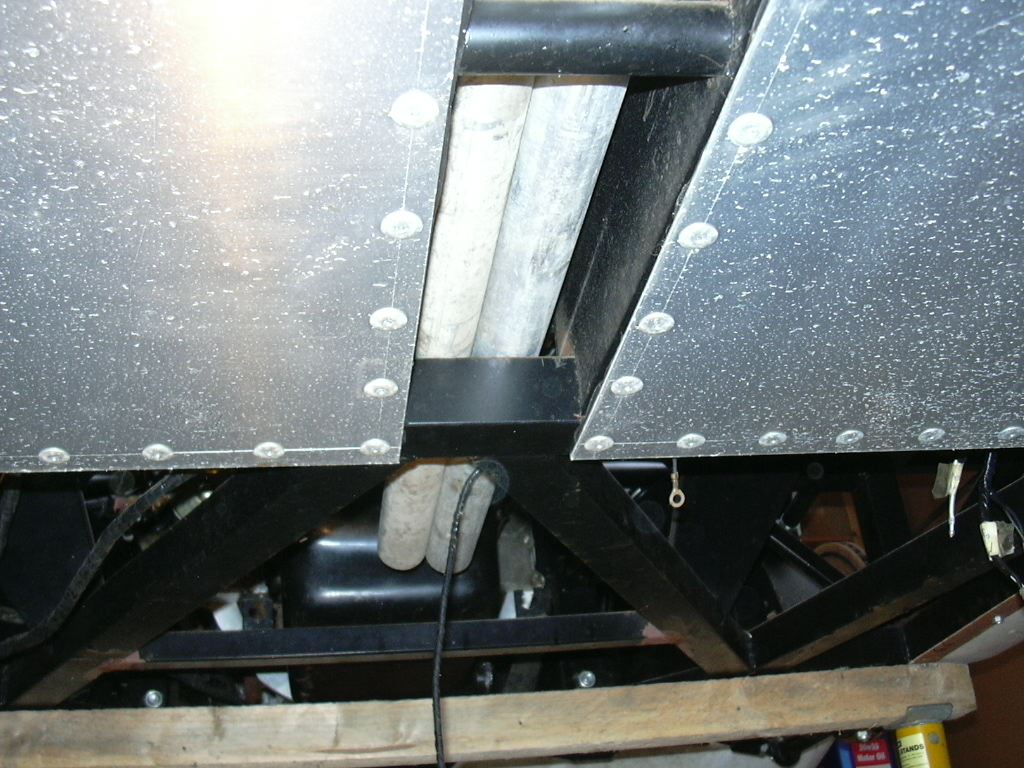

Up side pod from rear to "fitted fuel tank" Spot the mistake - It was a car ordered with EFi and there are no returns. First job is to remove them and get returns fitted.
Also had to remove the fuel filler caps as they stand proud of the body and will Fail SVA
These jobs took the best part of a day!
The Dax radius arm? in the above photo can be seen as one of the big differences to oher 40's as they go almost straight forward and inside the side pod. (Tornado and GTD go inboard close to the engine.
The dust is from 15 years of build so far (previous builder 14 years and in my posession 1 year,

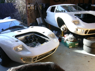

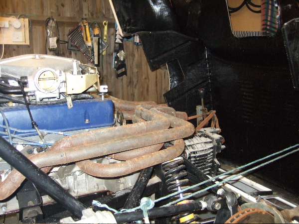

DAXNADO Paul's Tornado nostril on the Dax Amazing difference in thickness - the Dax is definately not a lightweight!

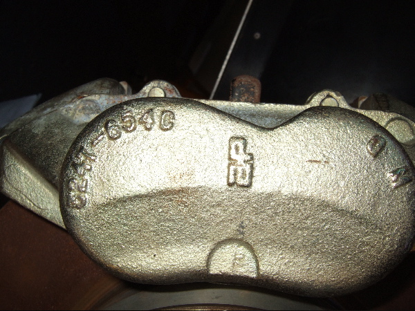

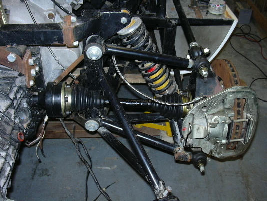

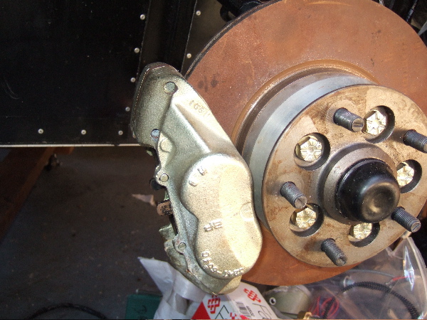

Front brakes AP units that bolt direct to Granada hubs
(I was advised off a Porsche 944)
Has any body used this caliper on a 40 and are they up to the job?
Paul has been working wonders this week
First got one drive shaft in - these are from VW transporter Mk2 no mods needed just clean up the CV and bolt in. One CV wa knackered so I have now hunted down the correct part.

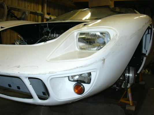

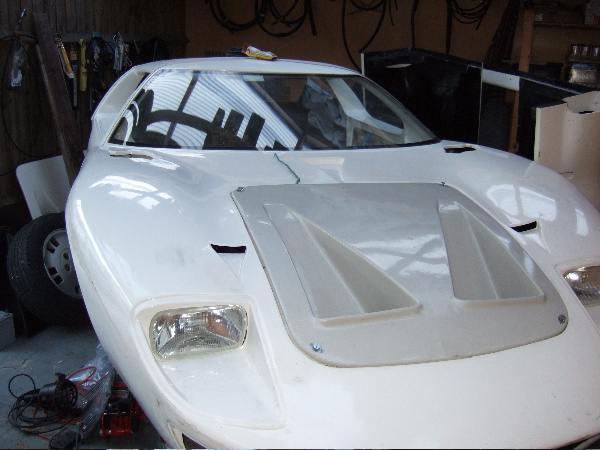

Front lights, indicators (to be removed for SVA) and driving lights fitted

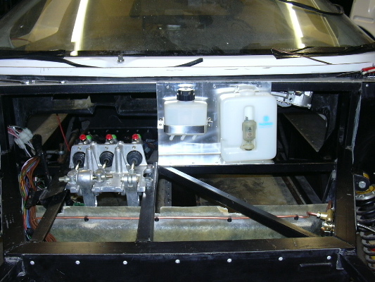

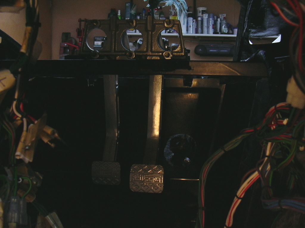

Bracket for the Fluid Resevoirs (Brake and washer) and brake pedal masters fitted (Double thickness windscreen as Paul's is on top when his car is at the painters. Also visible is the windscreen wiper mechanism not installed
