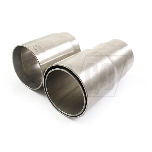

I would take the slip joints apart and repeal them. I would bet that is where the air is getting in and the O2 sensor will then say lean and inject more fuel which can n turn turns the whole system rich
To get a better seal they do make a double slip joint ….. picture a double skin pipe and the other part goes between the two parts
