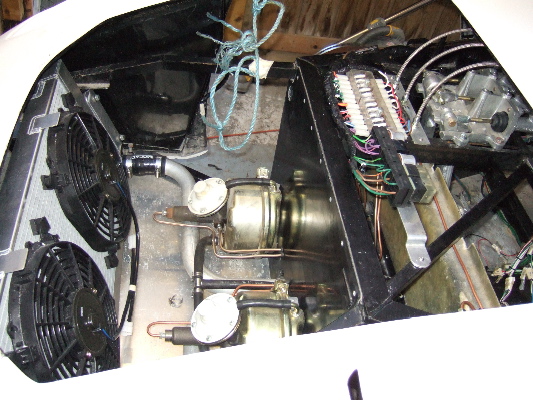

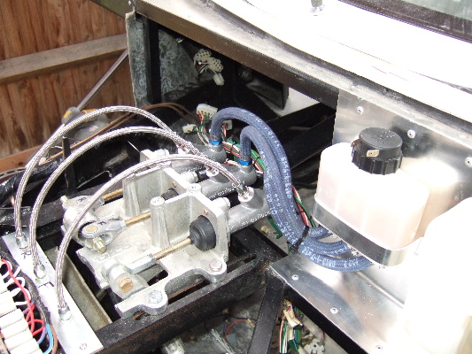

Brake Boosters fitted and plumbing started

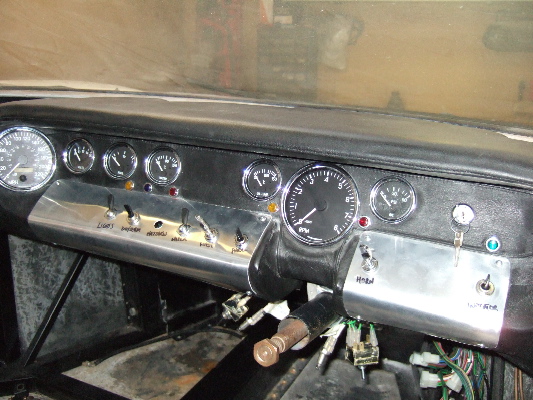

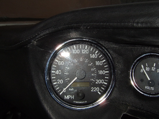

Instruments other than speedo fitted (ETB) instruments in their GT40 style. Yes I asked for the Chrome bezel - not original but I prefer it!

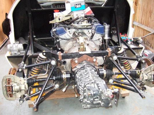

Dave Bilyk
Dave Bilyk
Ian, great to see the car coming along, and helps me know whats hidden under my panelling and carpets.
The rear suspension pic reminds me; with the car jacked up, and the suspension fully down, as I assume it is in your picture; Check that the driveshaft has some float. i.e slides either way into the CV joints. If there is no float, the roll pin through the inner drive hub may break as it did on mine. I had to adjust the rose joints to increase the track a little.
Dave
Ian Anderson
Dave
Thanks for that - easier to check now than break things later.

Ian Anderson
Pictures of this week's work
Firstly drive shafts fitted (the DAX uses a VW Transporter Mk2 unit in it's entirety - no modifications. Paul did say the Renault adaptors were slightly different to those supplied by tornado (Flange slightly further from gearbox center line)

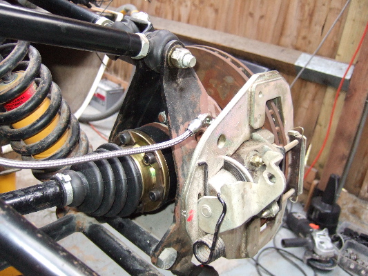

The Saab 900? has a handbrake that works on it's front wheels (the saloon car did not have a problem stopping with these as front brakes). The Front calipers were taken and used on the rear axle so this should stop quite well

Front end now looking good Rad, fans boosters, fuses and brakes

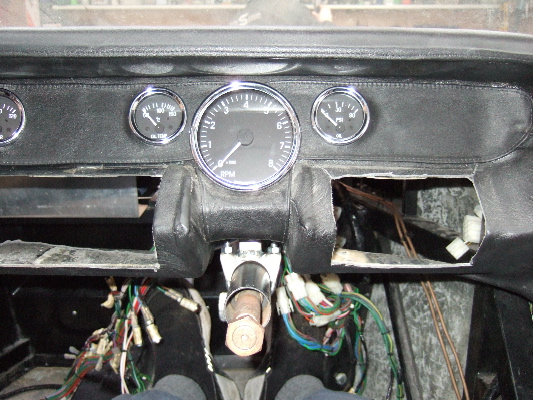

Ian Anderson

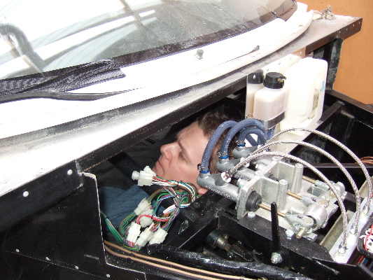

Steering column first fix being done - the rear bracket needs shortened to allow more knee clearance

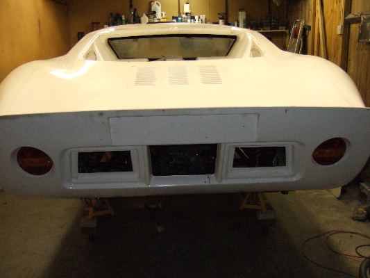

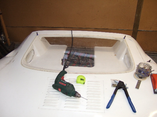

Rear Lights fitted, rear clip re installed, and under rear clip heat mat coated. Also Clip hold down started.
Ian Anderson
In the last picture it shows how low the Rover lump with EFi sits - rear view should be a lot better than in some cars!
