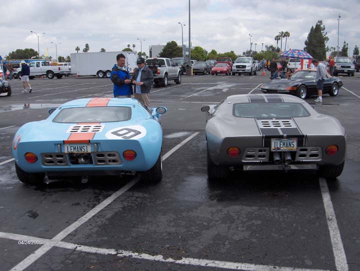

Alex,
Ian is correct on the flares. If you look through the books you'll notice differences in cars depending on when photos were taken. You'll see this on all the cars that saw competition - differences in side windows, marker lights, radiator vents, rear clip vents, mirrors, latches, etc. If you are trying to duplicate a particular car the best you can do is duplicate it "at that moment".
When Lynn was looking at windows latches for the side windows I think you can easily fine in one book, the Allen book, three different styles and types of hardware to accomplish that task. In that same book you'll find at least two, and I think three, different types of wide flairs. So, make your pick!
I'm not sure if RF does those on the SA cars right now or not, but I'm sure they will shortly since the demand will be high. I like'em without flairs, but eveyone has his/her own preferences and the flaired ones are awesome cars to look at too.
The only disadvantage to the flares is the side mirrors are pretty useless unless they are extended out more to see around the flares. If being period correct is not all that important to you Al, then I would do as Chuck did and put on the Mini Cooper mirrors. I think they look great and compliment the roundy shapes of the MK I.

Is there a wider wheel/tire available from RF to fill up the additional space when ordering Gulf flares on a turnkey?
If Ron's car in the photo above is an RF, does it have standard RF wheels, tires, rear suspension? - it looks very nice from behind.
