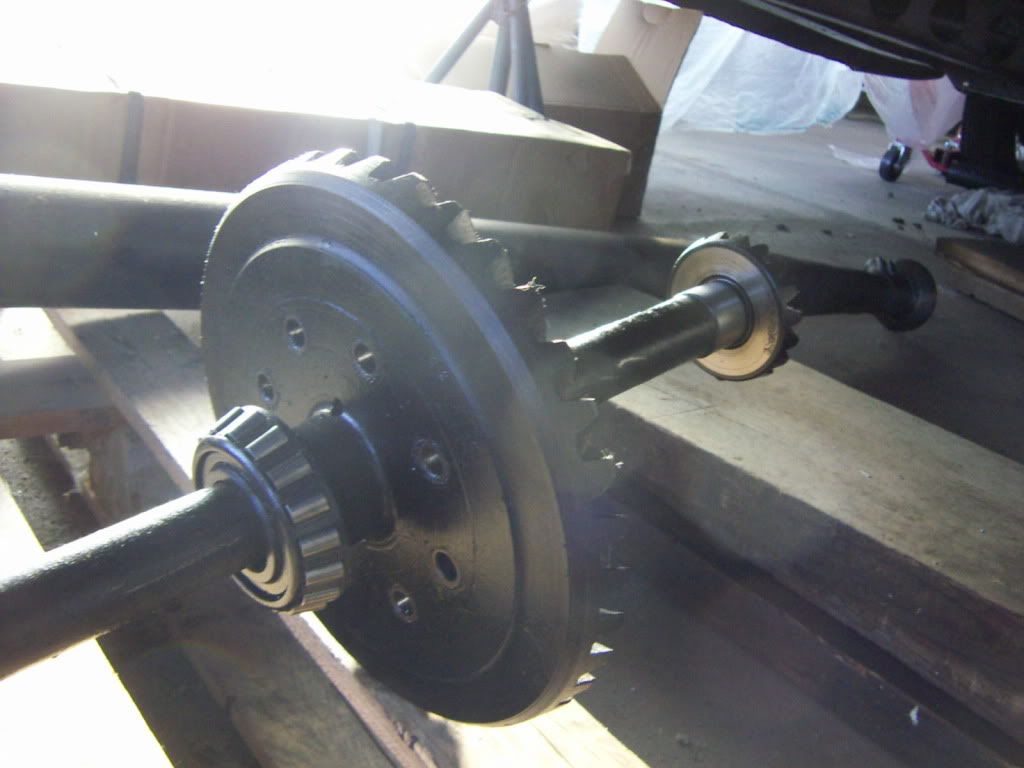

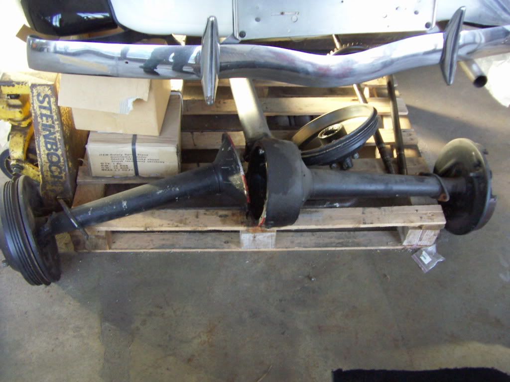

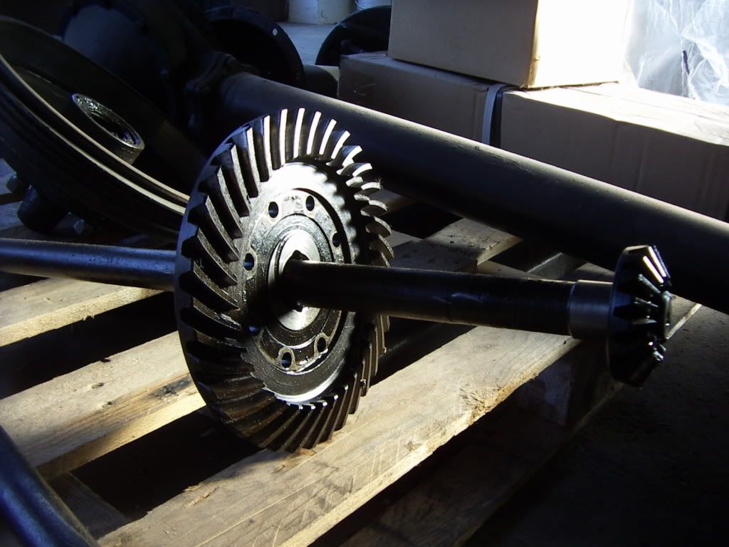

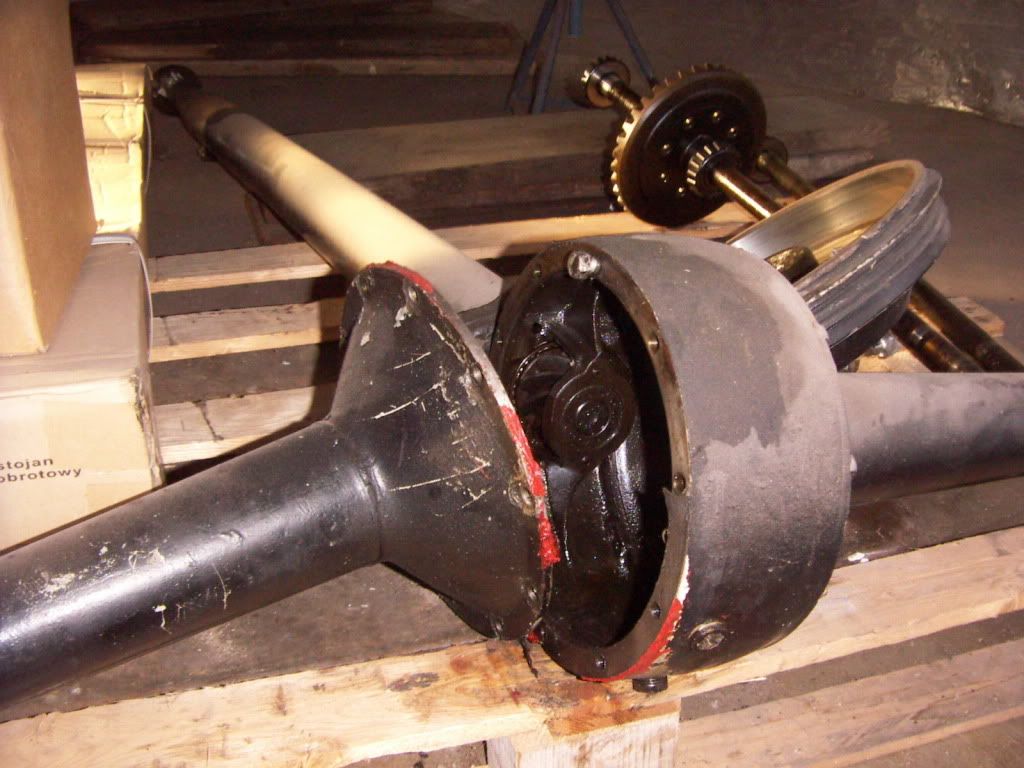

Do you need the housing, or the piece the fellow has in his hand? The axle housing looks like it is just disassembled, not broken.

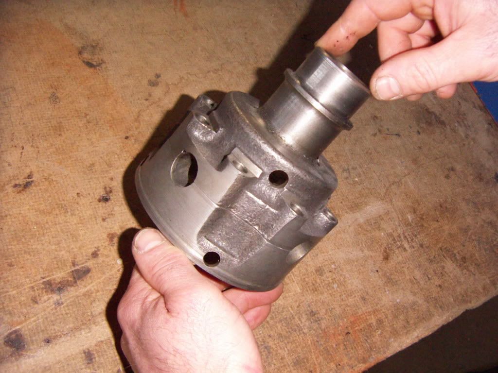

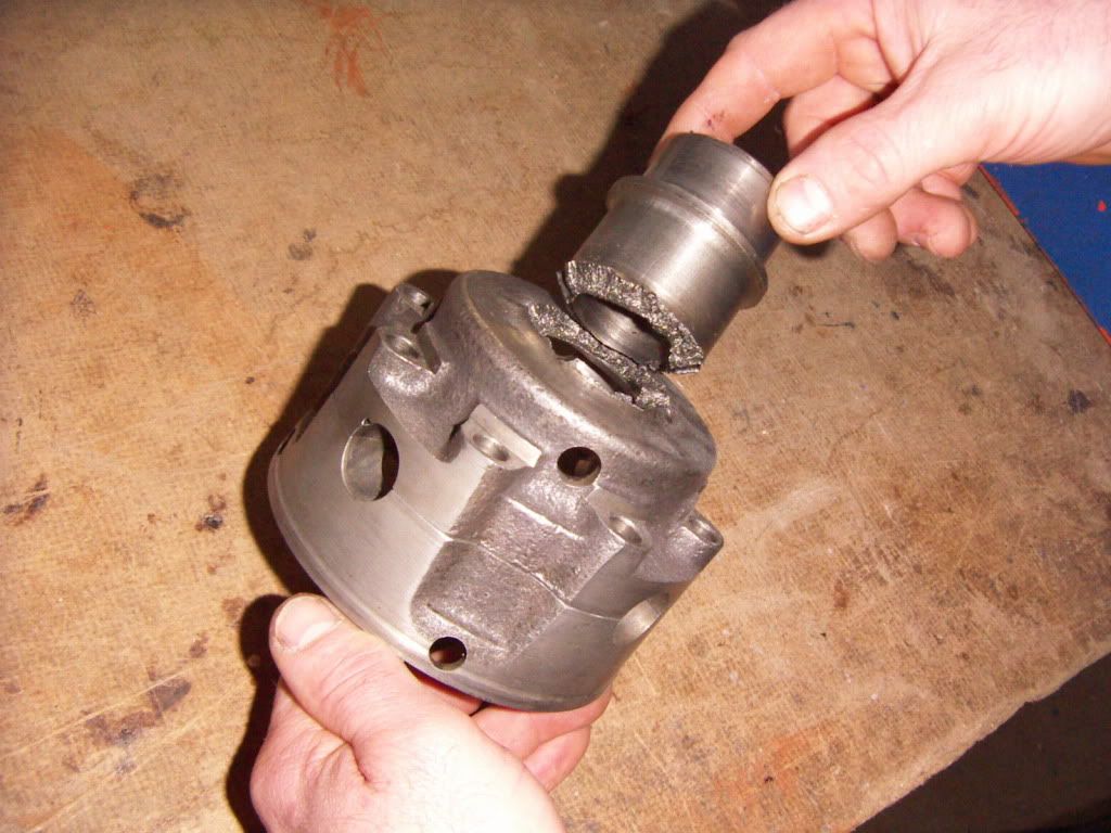

The part that's broken is called the "Carrier Housing" or Carrier for short. It will more than likely not be compatible with anything modern even though it shares the 9" ring gear (crown wheel) diameter with relatively modern Fords.
Hi Ron
we would just need the parts in his hands, the rest is ok
Randy
i have written down the part number somewhere, i just need to find that hiding note
