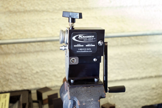

Cam dropped by today to do some bead rolling for his 1.5" aluminum tubing on my nifty little bead roller. It does a nice job raising a robust 063 bead.

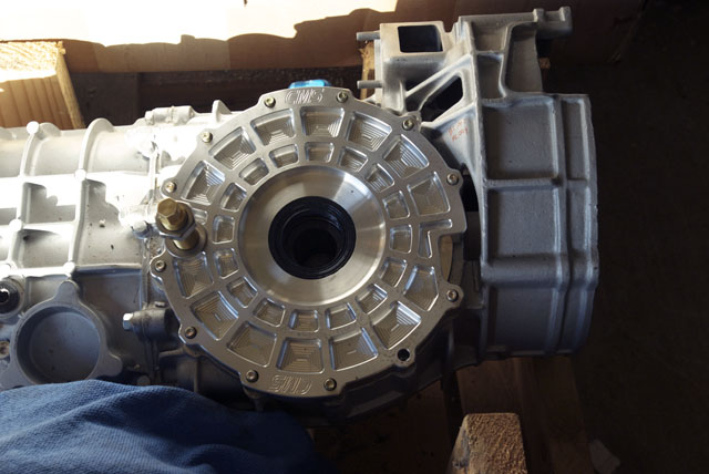

Installing my billet side plate for the G50.50.

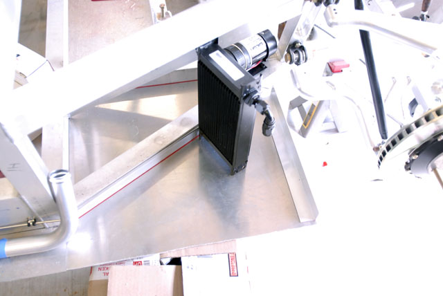

Mocking up oil coolers, pumps, Accusump, fuel system. Changing out the wheel studs for longer ARPs and tall open lug nuts. Mocking up brake cooling hoses. Now just waiting for the engine to return so that I can deal with the dry sump upgrades.

Doc, that is a nice tool, thanks for the beads! You've got some trick parts for your SLC. Who works in the garage in a white sweater? Ohh, it's Christmas time!

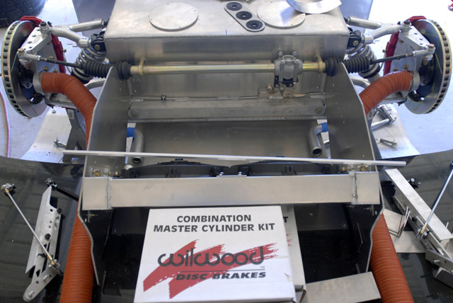

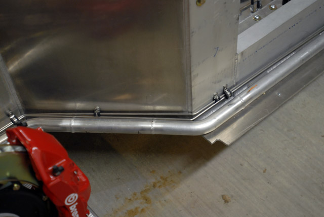

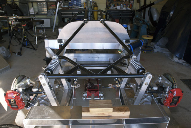

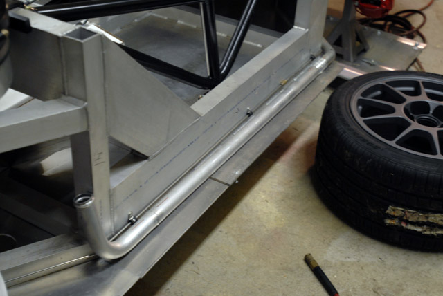

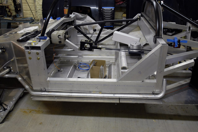

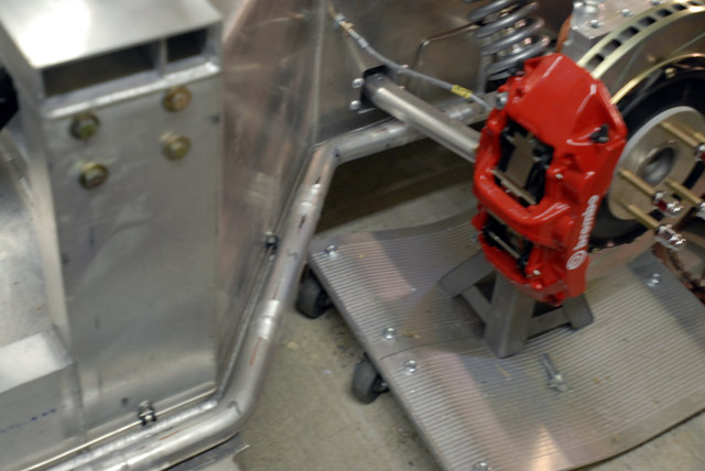

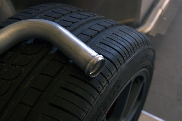

I'm going "turtle slow" I know. I made 22.5" extensions to the belly pan right and left and will work on wheel tubs to complete. Brake duct spindle flanges installed in the front....crude but effective. TIG welded 6061 aluminum tubing for the coolant tubes. I'll wrap with high density foam for insulation.

I haven't looked very carefully at the coolant tubes that came with the car - are they aluminum or stainless? Going with aluminum makes a lot of sense considering the radiator and block are aluminum and the lighter weight is always good. I'm jealous of all of you that can weld - I've never done it. I wonder if a tube bending shop could do a continuous tube? I'll have to look into that.

The tubing is supplied as Stainless in segments. A continuous tube would be a great way to go if you can find (A) the tubing in the appropriate length and (B) the right shop. It might take a few return trips to the shop to get it right. Be sure to bead roll the ends first!
I took the tubing to a REAL TIG pro. He said "don't be ashamed, 0.65" tubing is very tricky". Made me feel good.......

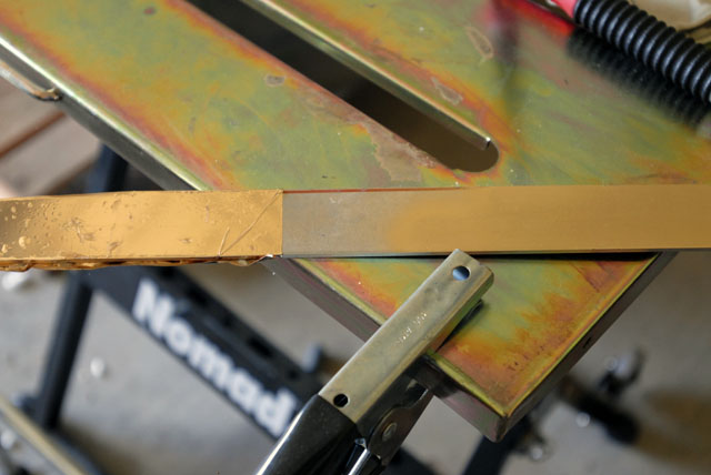

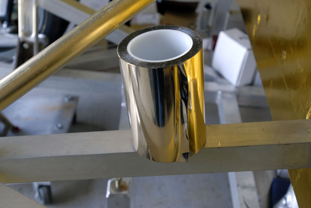

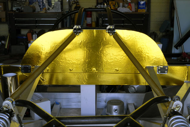

Just a couple of photos of heat reflection attempts:
One on the firewall uses the typical Gold mylar foil/backing sold by virtually every supplier for racing use. Yes, I know I didn't do a great job but looking at the DP's, I'm not too far off! The second one is a roll of mylar tape, 6" x 72 yds using an acrylic adhesive. It is highly reflective. The third is a strip of aluminum with metallic gold paint on the right and the mylar tape on the left after applying maximum heat from my heat gun till you can't touch the aluminum. The bubbles were intentionally left under the tape to see what would happen. Remarkably, even the gold paint held up and reflected some heat (based on the imprecise "palm of hand test"). The mylar tape did just fine. I shot high heat on a "free edge" of the tape and could see it shrink but not burn.
I have painted the diagonal rods with the gold as a base and will try the tape over this.

Hi Doc, great to see some good test results. I decided to overlay my bulkhead with Kevlar on the engine side and a heat insulator on the inside. Looking to powdercoat the diagonals gold too. Some heat protection, but mostly asthetic.
Cam,
I believe I'll use the foil tape on the diagonals. Since I have 72 yds!!! on the roll maybe other box tubes, fuel cell, belly pan, dry sump tank, breather cans.....? Just kidding :thumbsup:

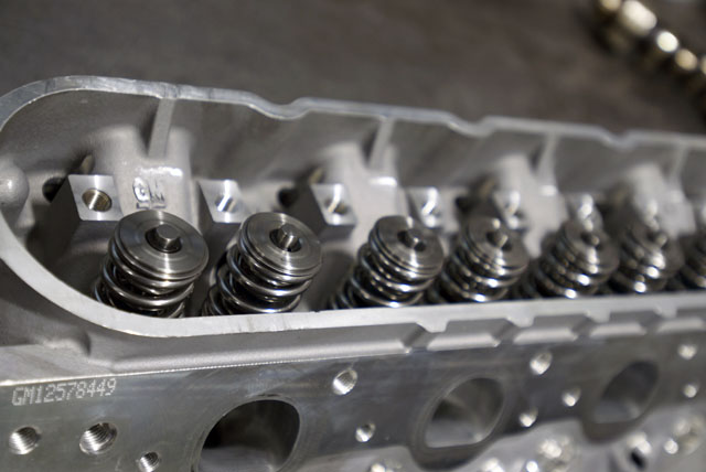

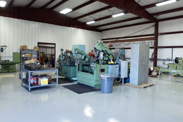

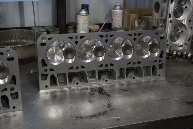

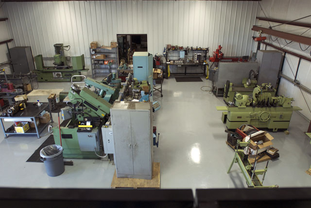

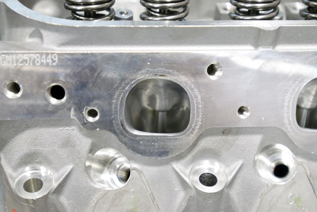

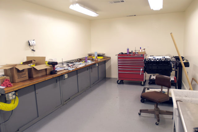

Just so you know that there really is a LS7 being built for me by Mike Malone of MachineWorks :thumbsup::
His shop is huge, I'm only showing the main machining room and the clean room. The porting and chamber polishing job is beautiful and satin-smooth! He has completed the milling for the Jesel rockers, is finishing up the cam indexing, etc. Interestingly, the Katech timing chain doesn't fit as precisely as the LS7 chain on the billet sprocket set and it is not seamless like the LS7 chain. So he is checking around for a different "Uber-chain".

Hi Cam,
Yes, Mike has his new shop just south of Greenville on Hwy34. I can attest to his workmanship as he did my Viper heads in the past. That Serdi machine is top notch for head milling. Not shown in his main shop is an even larger lathe out of the picture on the right near the one shown!

Your friends machine shop is imaculate, good to see:shy:

Hey Doc. How about some closeups of your brakes? Especially the rear caliper mounts. I have ideas........that are not completely formed yet. A look at yours would help I think.
Very nice work by the way.
