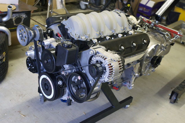

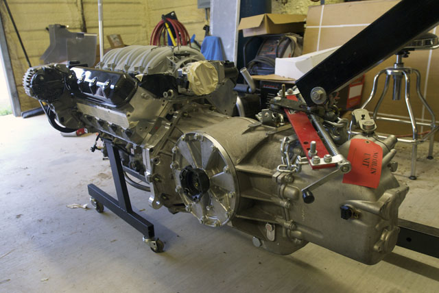

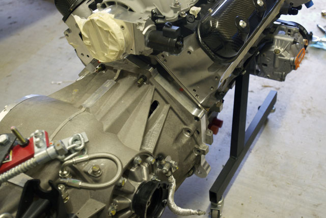

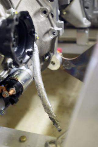

I managed to stab the Ricardo into the LS7 this weekend solo. Sore biceps, one scuffed knuckle and hardened nuts.... (for the bellhousing bolts)... is all it took. As usual, precision alignment is most important for success. I used calipers and patience with a touch of nudging to get the job done.
I am trying to get the engine dry fitted this month. Most of the SLC guys know I'm getting ready to move to San Angelo, Texas for a new Radiology position (about a 260 mile relocation). So, I'd like to make some progress on the build before it goes "dormant" for some time until I can build a shop on the new property (build coincidental with the new home I hope).

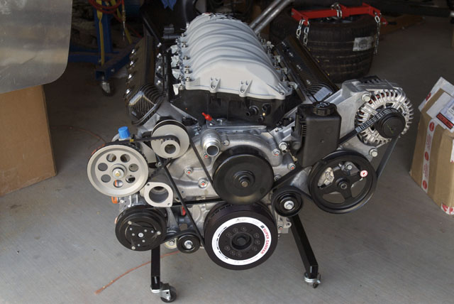

One more thing: Notice that the engine and Ricardo are balanced on those MotoFeet engine stands after the installation! That was most important for my ability to manipulate the transaxle while keeping the engine steady with no help.
Looks great! Is that a GM A/C Compressor? Sanden? What's the pulley for above the A/C next to the water pump?
Yep, the GM compressor. I believe that will need to be replaced with the Vintage Air unit.
The extra belt wraps around the Aviaid external oil scavenge pump.

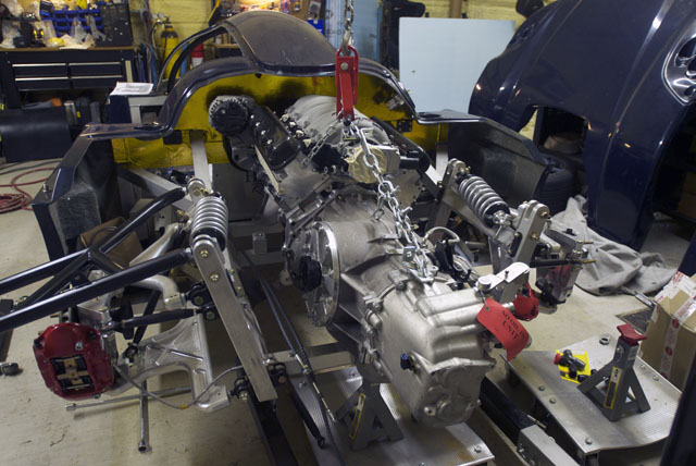

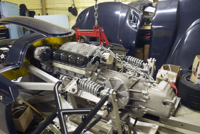

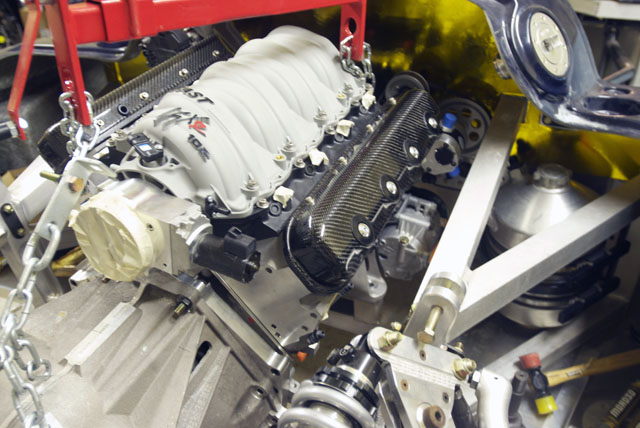

OK...D-Day for first test fitment.
Cam, I know you warned me about the alternator location! This will have to change to the CTS-V lower alternator location in order to fit without interfering with the chassis upper bar. I am showing the LS7 front serpentine setup with the upper alternator bracket.
The Aviaid accessory oil pump and pulley will fit.
The rear transaxle-frame bolts are very close to the Ricardo bell-housing such that a nut may interfere with the bell-housing.
But, all in all, not a bad first attempt.

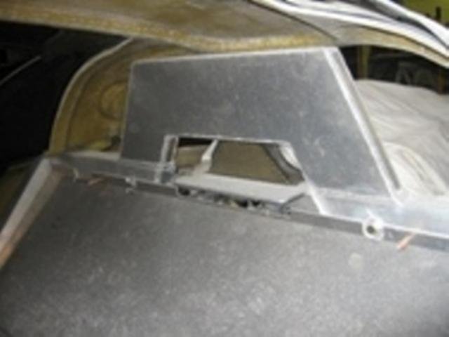

Quoted from Cam's thread, I didn't want to jack his thread with questions about your build.

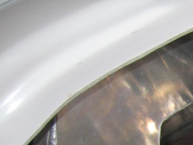

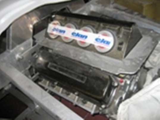

BTW, I got the fuel cell back from Harmon Racing and from Fran....added a tube through the cell where there was just bladder showing....much better.
Is the tube removable?
If so, how is it secured?
If not, how do you plan on servicing the bladder if/when needed?
I'm on the verge of redoing my cell for several reasons. One of my problems is that because the rotary sits lower, the shifter cables cannot make the turn out of the firewall. There are several solutions, one is moving the engine back but I don't really want to. The other is to angle the pass through tube in the fuel cell towards the drivers side as both cables will be routed that way anyways. I'm also considering a bladder setup but have concerns about the pass through tube and serviceability.
