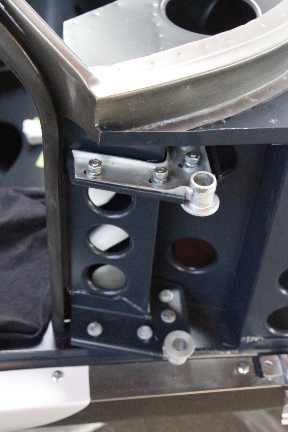

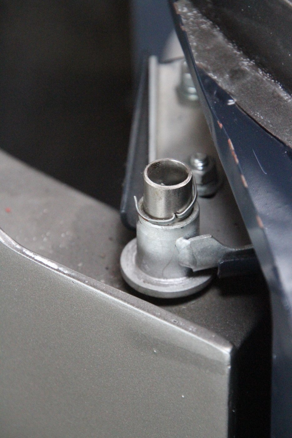

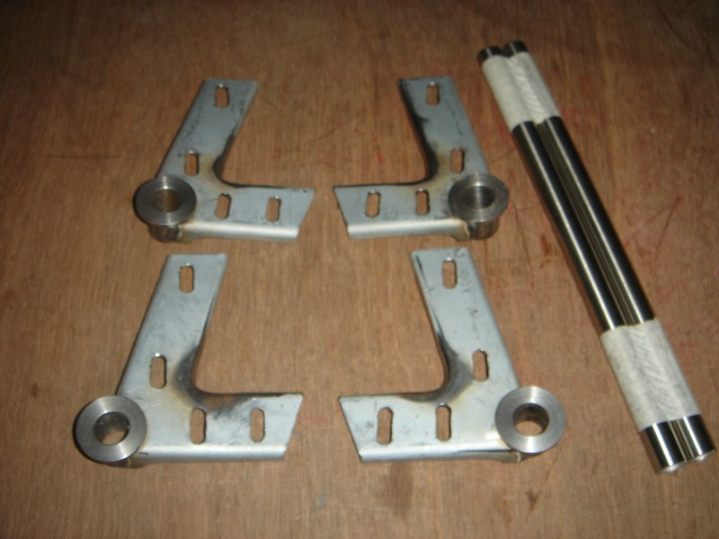

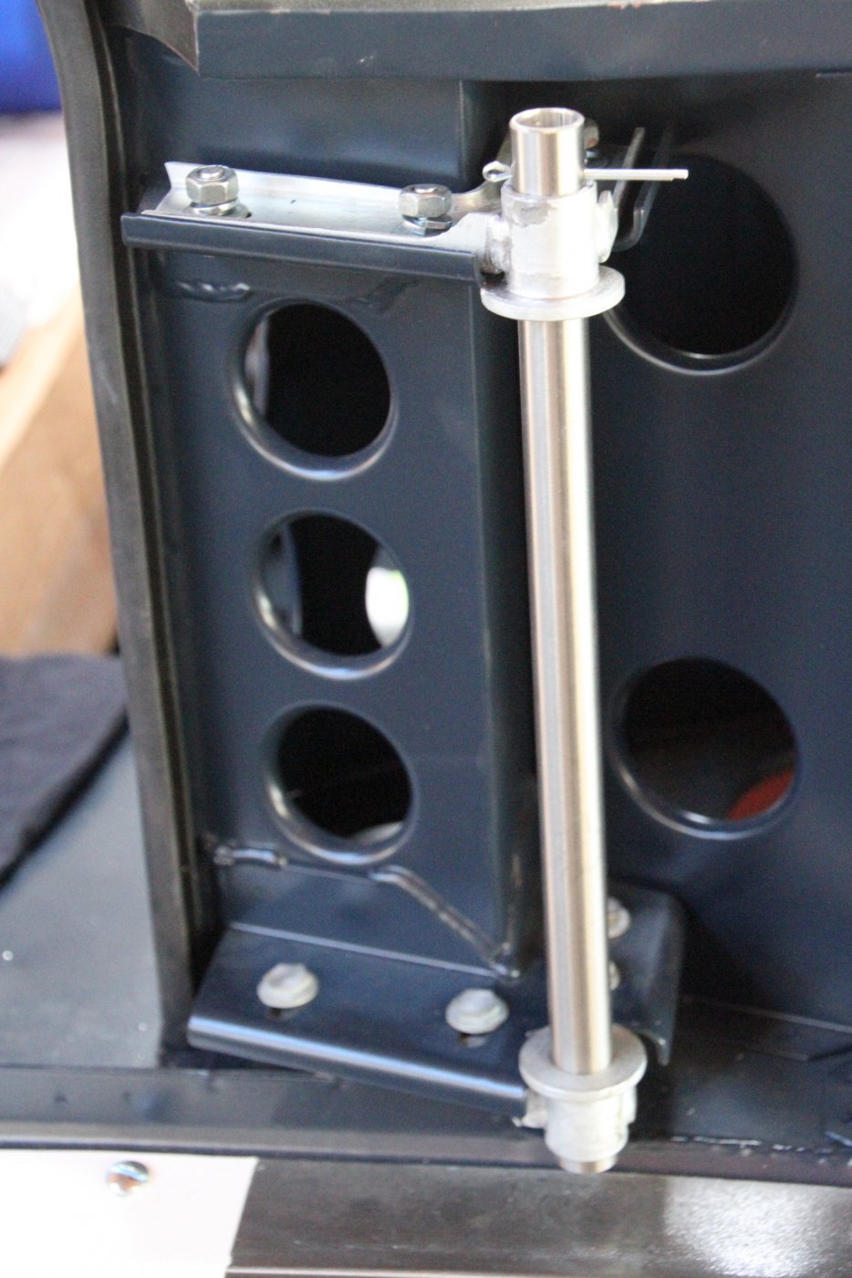

The original hinge is a pretty simple affair, with a tube sliding through a corresponding tube bonded within the door. Adjustment is by loosening the nuts holding the upper and lower hinge mounts.
