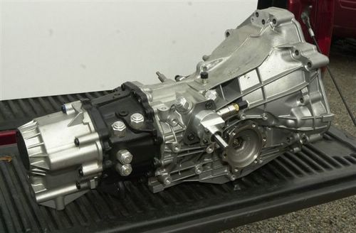

2. Another RF related investment of mine (that is fortunately not at risk) is a new Audi 01E six speed with Quaife LSD, modified for right hand drive, right hand shift by Jerry Jansing. I'm wondering if anyone has determined that is it not practical to use this transaxles in an RCR chassis, and if anything prevents the use of right hand shift?

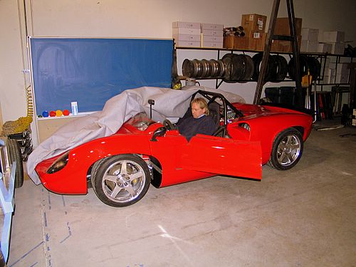

I was in Detroit yesterday afternoon visiting Fran's shop. As a degreed mechanical engineer, all I can say is wow. I was utterly impressed by the design, manufacturing processes, material selection and especially the attention to detail present along with the continuous process and product improvement evident in all of the vehicles being produced in his shop.
I should be clear that I am not making a comparison between RCR and any other manufacture's products (I am not qualified to do so). What I am comparing is what I thought of the RCR product before and after being there in person. The photos on the website simply do not do Fran's work justice.
Basically, I walked into the shop and immediately was struck by the well organized, clean and extremely well stocked assembly facility. After getting a tour of the facility and an in-depth introduction into RCR products by well informed and clearly skilled fabricators, I met Fran.
Even taking into account that (to me) anyone with an English accent automatically sounds authoritive, intellectual and well informed /ubbthreads/images/graemlins/ooo.gif, Fran quickly showed his extensive engineering and design skills as he ran me through the car and it's systems. As a result, I would have been similarly impressed even if he had a Brooklyn, NY accent!
Executive Summary:
Walk in, touch the product, talk to Fran about what I would like and Bob's your Uncle, chassis #24 is mine :-)
I forgot to mention that I sat in Sandy's car for a size check. Plenty of legroom and comfortable seats - of course the rest of his car is also very cool <Sandy, I did not step on your new seats with my dirty shoes, I think Fran used some old GT-40 blueprints as protection, showing his continued concern for the customer :-)

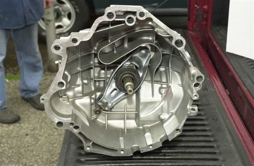

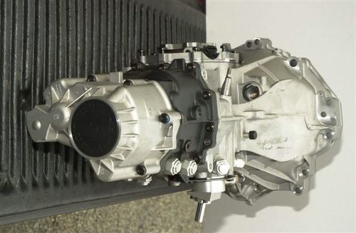

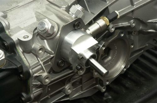

I also forgot to mention that I just got some photos of my RHS 01E that Jerry Jansing modified. Thankfully, it turns out I will be able to use it in our RCR!
1 of 4
