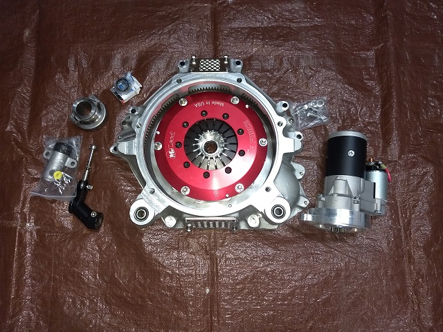

David,

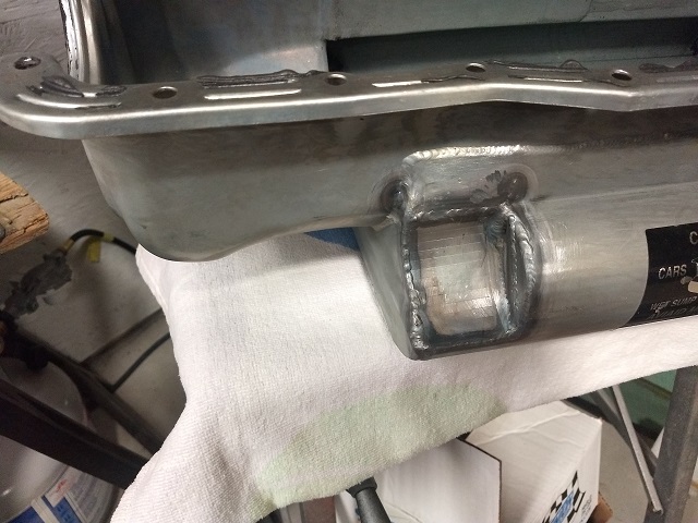

I purchased the complete SBF kit from them for my RCR40, 363sbf w/ZF tranny. Although I haven't had a chance to do a test drive yet, it seems to be really nice stuff and everything assembled together easily. The only modification I had to make was on my oil pan to make clearance for the starter motor. Nothing hangs below the chassis on my car. Bob Wood at Safir was very easy to work with.

Rod, Thanks for the reply. Looks like good stuff. Same kit I am getting. I think my pan will be fine as it is not rounded. It also comes with a cross member for mounting at the bellhousing? External slave cylinder mounting machined into the bell housing? What is the Black thing that resembles a water hose end? Thanks for sharing.
