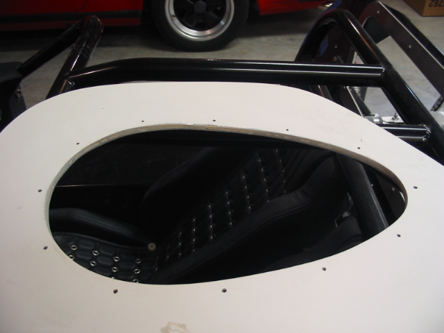

Dwight: Sorry for the delay in responding. Just had a chance to look at the inside of the roof of the GT, not something I notice much.
The gap between the liner and the top of the door was not significant, I would guess around an 1/8 or 3/16. (Memory fades with time). As noted in the book, gently securing the bubble with a couple of screws draws the two together reducing the gap further. Closing the gap with filler and sanding smooth the edge completes the process.
The finished thickness from the roof top to bottom of liner is around 1/4 all the way around. It really looks good. You won't have any problems.

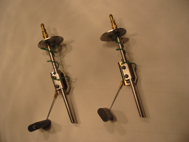

just looking over some of my note and found something you guys can help with.
The fuel tank sending units, are they a three wire or two hook up. I have a shielded 2 conductor cable (black & white) to the dash but there is a blue wire terminated on the sending units. When I traced it out I found it butt splice to another blue wire (the other unit) and then cut, dead end. Do I need a third wire?

Couple of pictures attached.
View of the opening for the bubble after inner liner glued to outside panel. You can see the seam and how tight it comes together. Hope this helps.
The sending unit has one wire. The second would be the ground. Each sending unit wire would go the the separate gauges. It has been five years since I wired it, but my recollection is that a short wire was connected from the sending unit cover plate to a chassis ground to assure a good ground connection and then the fuel gauge ground was joined to the common ground buss behind the dash. In other words only one wire per sending unit to the dash. No need to shield the sending uint wire since it is not RF sensitive.
Compare yours to the picture attached. If you have a different type of sending unit the wiring may be different.

I do not know what units I have but here is a picture of one of them. The terminal post are labeled send, neg, post,
the blue wire was ran into the frame "box" behind the driver seat and abandon. I have not traced the two conductor under the dash to see how it is hooked up.
Dwight
Chuck
Definitely different than mine. Do you have the Classic gauges? Could those have inductive pickups rather than mechanical floats, hence the need for a power source?

I did a search and found a diagram. Small picture and I'm wearing bifocals, but I think the pos post on the sending unit is fed from a hot circuit behind the ignition switch. That wire also feeds the dash gauge (meter).
The neg is ground and the send post is connected to the gauge (meter) I think the "S" terminal.
It may be a few days before I can remove the gauge and check it.
Thanks dlindemann
this is the information I need.
