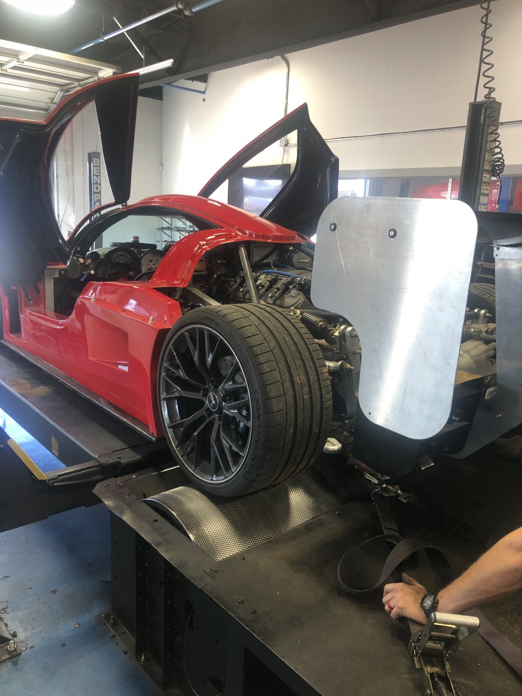

I went into the dyno day today just seeking a conservative tune. I didn’t have any idea as to what was in the car. Was it tuned for race gas or pump gas? What was the timing like? Well it turns out that it was a very aggressive tune. We spent a majority of the time street tuning for drive ability. It is kinda strange driving around a busy area with quite a few police watching you and them not even looking twice. This tuner is well known in the area. We didn’t even have the rear clamshell on the car so no brake lights and the police could have cared less. They know this guy and know if he is in the car it’s alright. We then did some dyno pulls. To get WOT afr’s in line and transitions nailed down. I can tell you that racelogic traction control does work on the dyno. First couple of pulls it kicked in and bumfuzzled us. Tuner asked if it had traction control and the light came on in my head. Why yes it does. Tried a couple of pulls at higher timing settings and gained very little so we backed it down. Now to start working on the chassis and brake side of things. Making some titanium skids for the bottom of the drop floor. Should make pretty sparks like f1 cars.

How about a full picture from the side with those C7 Z06 wheels? Looks great on the dyno.
Do you still have the CCW wheels?
I've got 2 sets of the CCW wheels but they have OLD tires on them. I had this set of Z06 wheels sitting around with fairly fresh rubber so I threw them on to drive on for now. I'll get a side shot up when I can.
