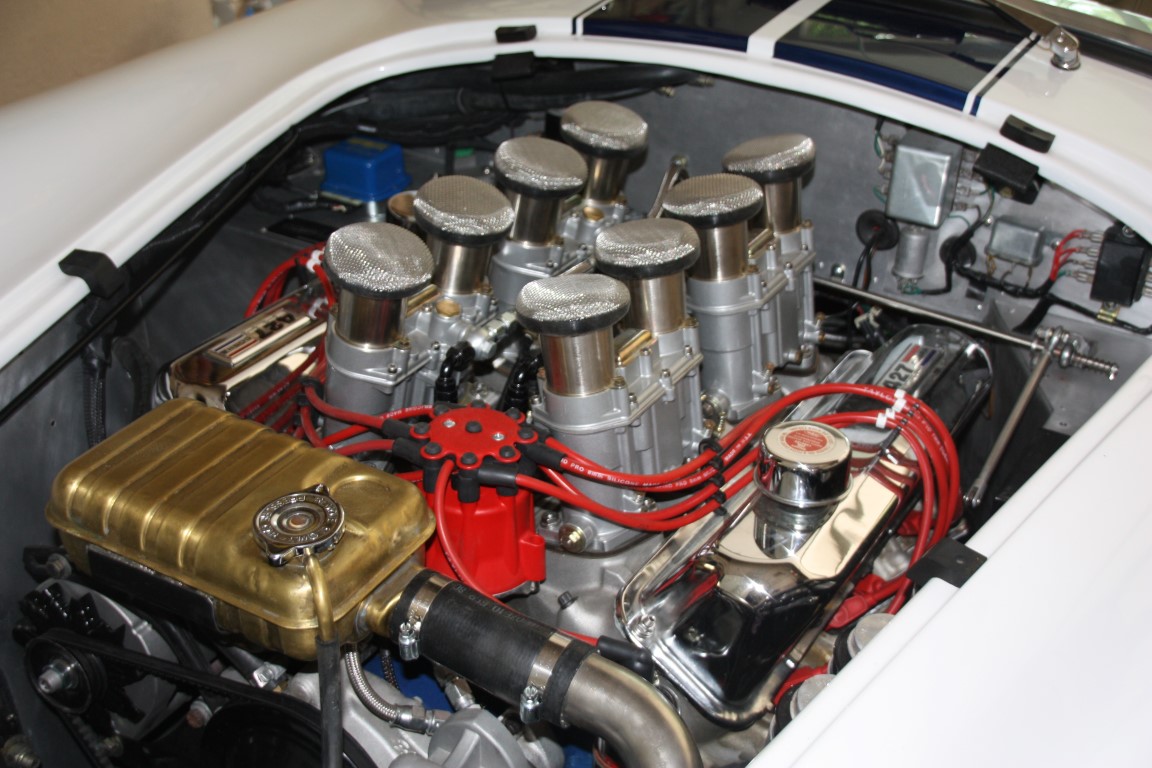

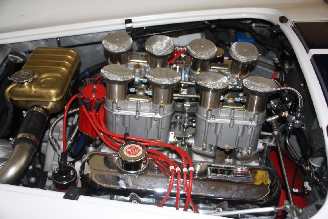

I know this is a roadster but the setup would work very well in a GT40. EightStack and Performance Electronics is a great combination. Great old school looks, great performance and starts like a dream. and the icing on the cake, my first cruise netted me 16.5 mpg - and I haven't tweaked the ignition tables for economy :thumbsup:

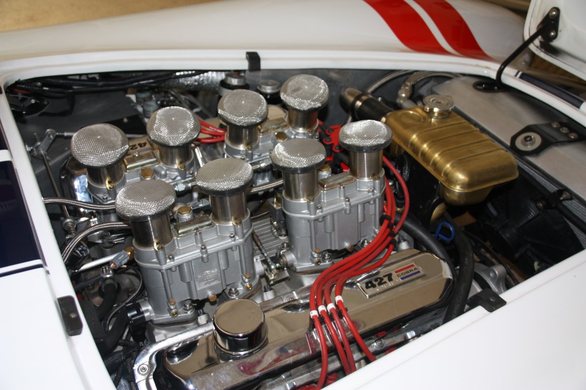

The only challenge I found with the EightStack set-up is you can't fit decent air filters on the stacks. I changed my stacks so I could use better K&N filters to protect my engine. They don't look quite as period-correct, but my I'll accept that to extend the life of my engine.
