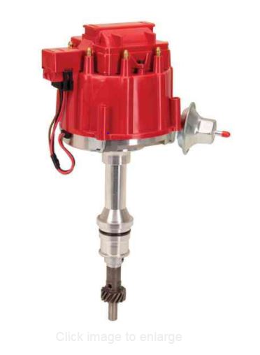

I have a basic Holley double pumper on there for fueling, and a basic ignition system with a regular HEI electronic dizzy and integrated coil (see pic) and vacuum advance.

It won't look as fancy as the 8-Stack systems, but I'm planning of using a FiTech EFI system on my build. Single unit EFI Carb with built in ECU and most of the sensors. Self mapping. Most will do basic timing control with the correct distributor, either a locked out MSD or a TSP Pro Billet small cap. I’m aiming for simple, reliable systems with minimal tuning. Hence liking a self tuning system, and avoiding complex multi throttle body linkages, separate ECUs etc.
Forgot to add: the small cap is quite a bit smaller than the HEI dizzys which should hopefully help you.

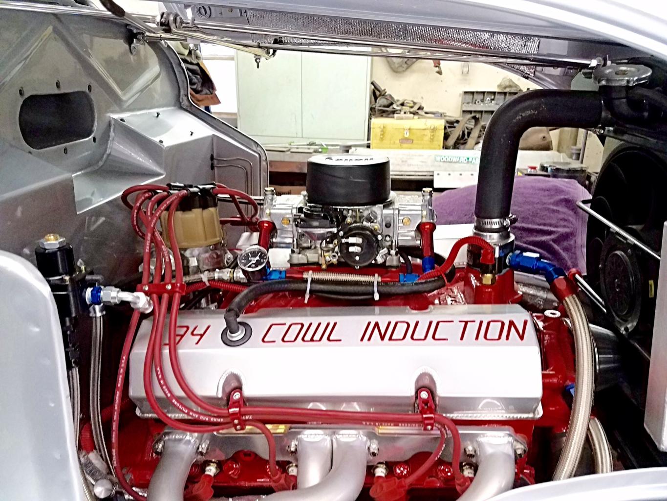

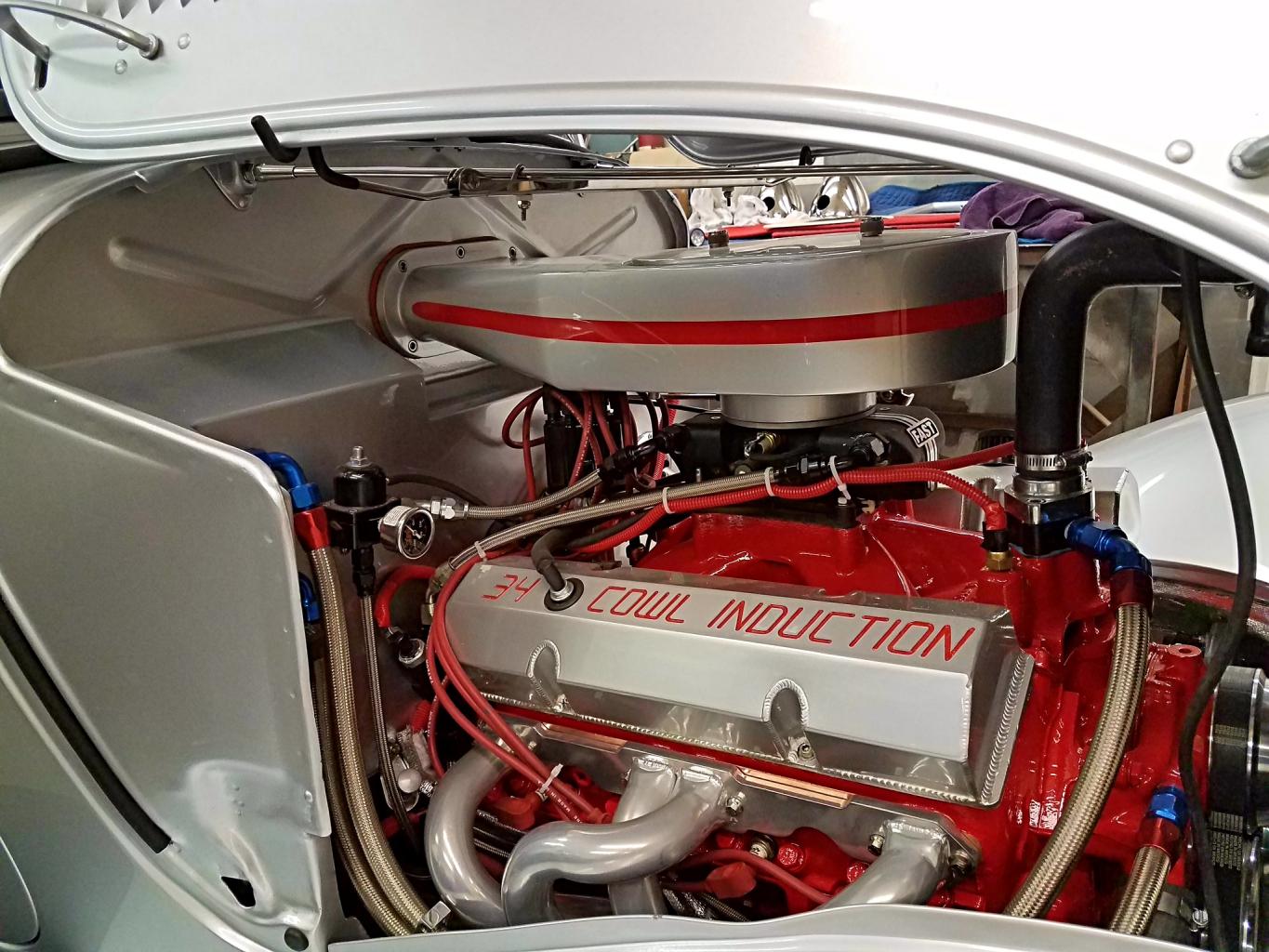

We just threw in the towl on an EZ-EFI Fast 2.0 system.
It was flakey at best and many times would come up with communication errors and just shut off. The tech support line was absolutely NO help whatsoever, insisting that the problem was noise related etc etc... I re-wired the unit to hot/grounds precisely the way they recommended on 3 different occassions - none of which produced any different results.
The system we bought was complete with their fuel system and distributor. They refuse to replace the ECU (it is still within warranty) and at this point - even if they DO agree to replace the ECU, the customer has lost so much money ($3500 in parts alone) and confidence in the system that we just removed it and installed a Holley carburetor and aftermarket distributor.
My thought is - if the system is so doggoned "touchey" in terms of noise / RF interference - it has absolutely NO place in a car...
I would post pictures but unfortunately the website seems to be refusing uploads right now...
Suffice to say - this is a 6 figure street rod build and no expense has been spared in its creation.
Trying again (had to re-size --- odd....)

Tom --
I think these posts are totally relevant to any EFI / Ignition recommendations.
We have another customer that has the FAST 1.0 system and it has been rock solid and a great performer with a pair of DCOE look Stack Injectors on a small block Ford.
The last wiring change I made on this car was a twisted pair home-run for both ground and 12v from the battery in the trunk - which we also replaced because the original battery was only 12.5v and FAST Tech support said we did not have enough juice ((BS)). Being familiar with aircraft systems, you know that the only way to get better than twisted-pair is Shielded Twisted Pair.
The big plug on the ECU had a couple of females that were not totally seated. One was not used, the other was for the high speed fan.
I programmed the system with some pretty basic settings for the displacement and found that it was giving waaaaaay too much fuel for a prime squirt and cold run - so I backed both of those off to -3... Much better starting after I had to replace the spark plugs due to being flooded too many times and was not sure of them even after torching them...
Started and ran good until about the time it went into closed loop mode and then it would die just like you switched off the key. Odd... plugged in the hand held display to watch it. It still died about the same time - no more than 2 minutes into the run it would die. The Hand Held flashed "Comm Error" and then went blank.
From there we went through umpteen different wiring routes, then finally re-wiring. I even tried shielding the wires with HVAC aluminum tape - no difference.
Let me tell you, working inside the console and under the hood of this car is not a lot better than laying on your back under the dash of a GT... Very little space.
In my opinion the ECU is hosed. FAST is not convinced.
I am convinced that given the preponderance of similar evidence I have found on dozens of forums all exhibiting similar issues that the FAST 2.0 was rushed to the market and is buggy..
We have even talked with Brian Macy about this system.
The carb works really well and sure simplifies the electrical system of this car...
I am reading really good reports about the FI-Tech unit... I may pick one up for the next EFI car..
