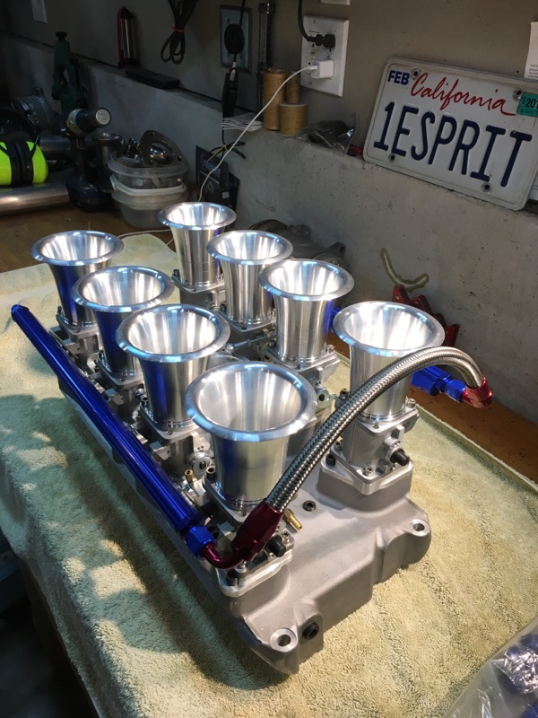

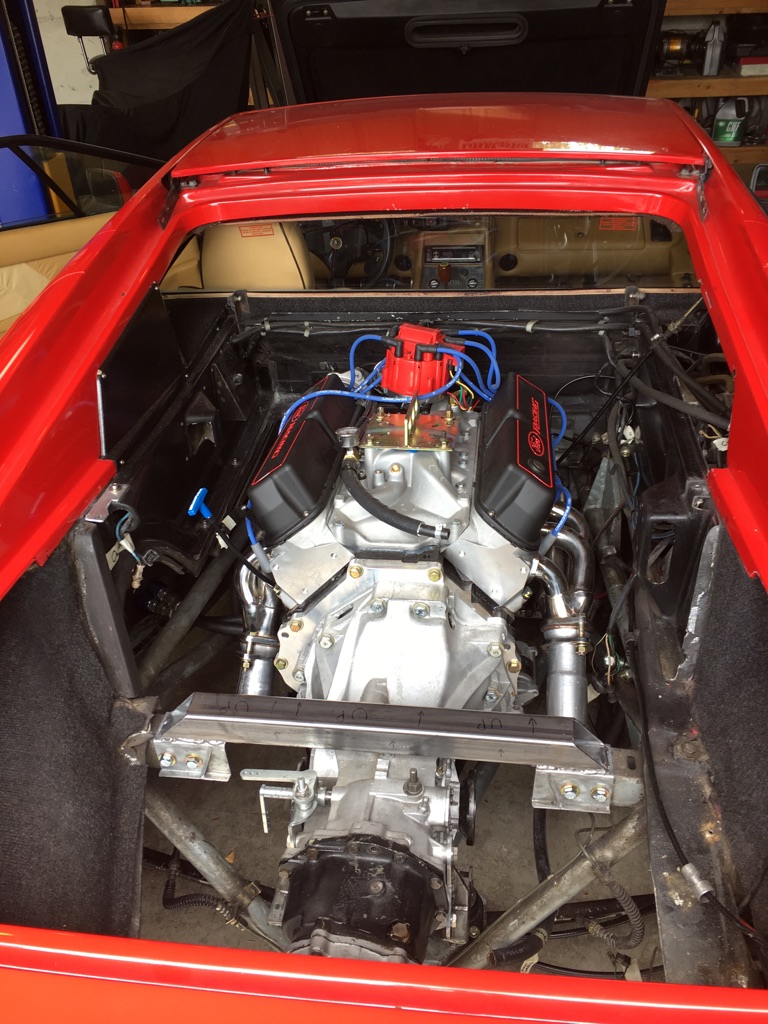

I have to replace the large (huge!) HEI distributor on my 347 with something smaller to clear the new injection manifold and TB's going onto the car. The HEI dizzy is just way too big to clear.
So, what I'm looking for is either a small sized distributor ignition system, or a distributor-less ignition system. Generally, I'm looking for something 100% dead simple, user friendly, and dead reliable. I don't need infinite tunability or complex programming. My little brain can't handle it.

I would get the recommendation from the maker of the intake manifold.
I had to polish away a bit of the casting on my Weber intake to clear the small MSD distributor.. it was only about 1/8-3/16" ...
Thanks Randy, yup, checked with them - they were quite helpful but essentially recommended a distributor-less system. That makes sense, just trying to weigh the different options.
Alternatively, I think I could squeeze a small dizzy in there....perhaps try that for starters just to keep things simple. Looks like I'll probably have to remove a bit of material too, like you.

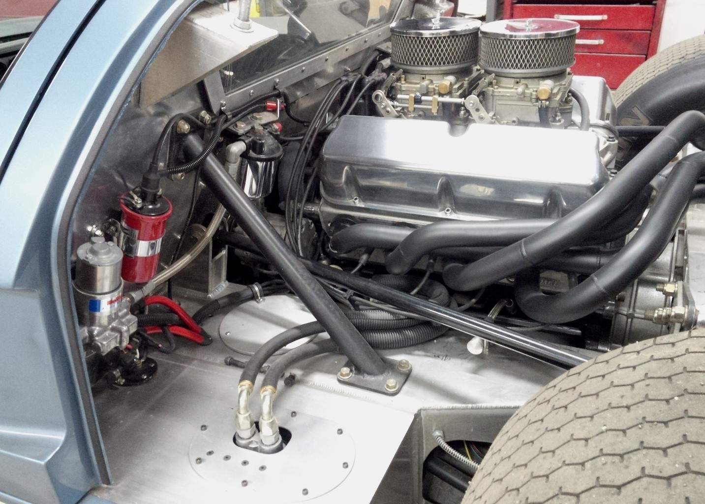

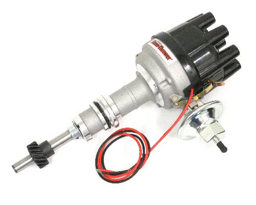

Hi Cliff, check out the Pertronix "Stock Look" as cast distributors. On GT40s it's much easier to install (firewall clearance) with the engine already mounted. I used one in this RCR GT40 to replace the Ford dual point distributor. The Ignitor III version comes with built in multi-strike spark, rev limiter, timing assist for easier starting and vacuum advance. No need for the weight, wiring and hassle of a separate spark box. Just put one in a Cobra with 347 along with a MSD Atomic EFI system, works excellent.

After a lot of thought....and re-thinking....I ended up adding the FAST dual sync distributor here. This distributor is plug and play with my FAST 2.0 EFI system with crank/cam positioning. I've done a lot of research on the FAST 2.0 system and while there are some mixed reviews there's a lot of really, really good reviews. It's tough competition out there with Holley and Fiteq along with others. On the ignition side there's lots of good competition as well....as was pointed out in this thread....from MSD, pertronix and others.
The FAST 2.0 EFI system looks good, and relatively easy to set up. I have quite a bit of experience with EFI so I understand very well all the concepts and functions of the various sensors that tend to go along with EFI.
