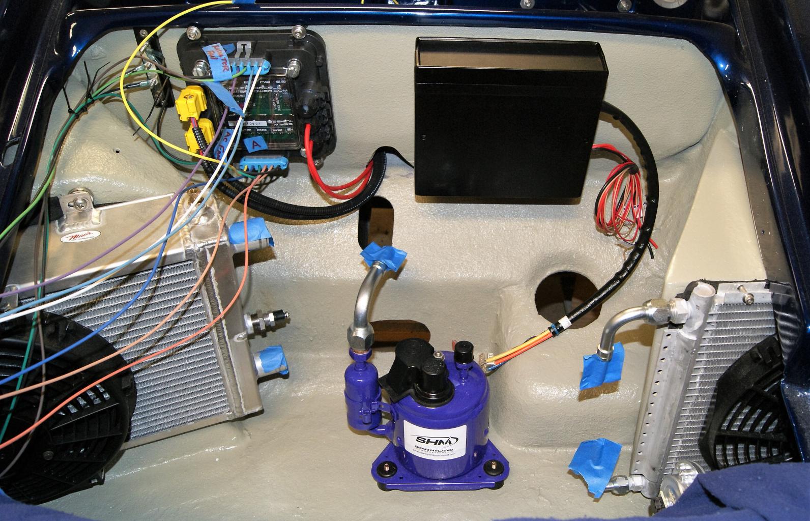

Well, it only took me 6 months to get back to working on the car! The electric compressor and associated controller are mounted in the front boot of the Europa. I also did my first DIY AC hose using the E-Z Clip System from Vintage Air/Aeroquip - very slick. More hose work tomorrow, need to hook up the dryer with trinary switch, etc.
Dave L

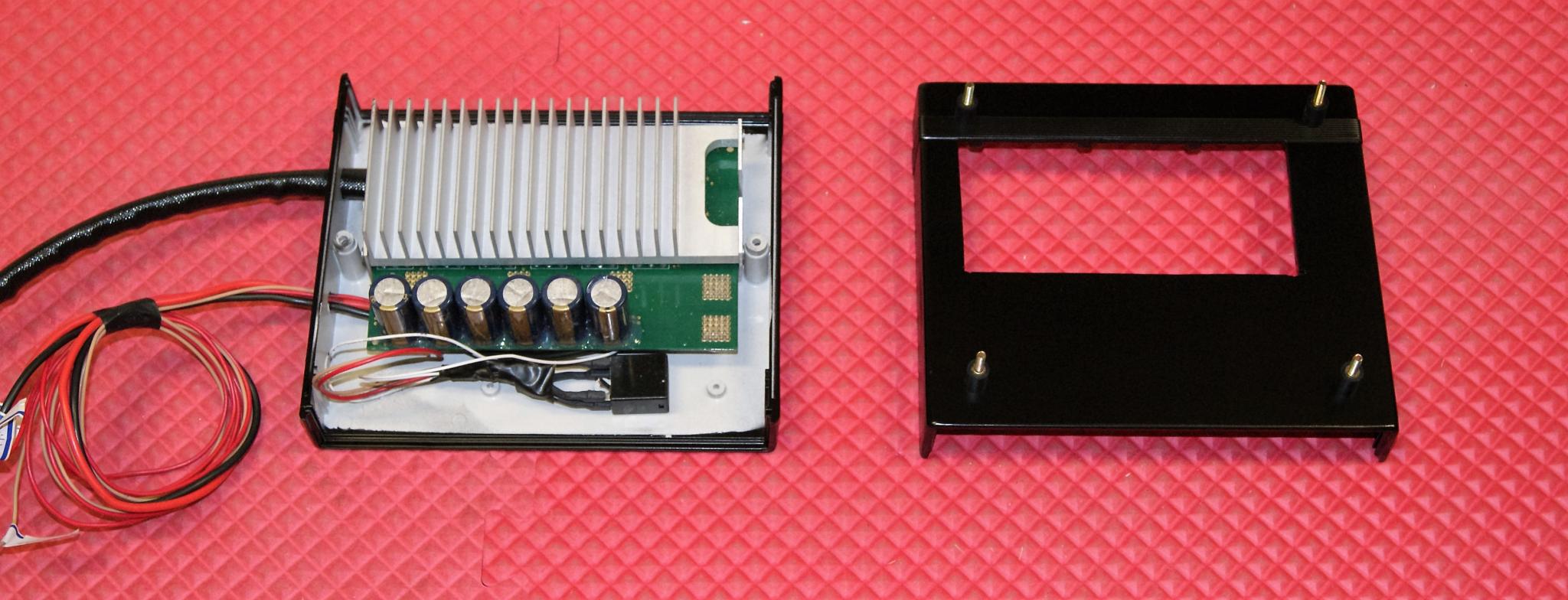

Looks really nice Dave! Did you paint the Lizard Skin or use something else? Very clean and sanitary.. Love it!
Merry Christmas to you and yours....
Let us all know how well the compressor works. P.s. is it a DC compressor or a/c like a 3 phase with a motor drive to control frequency?
Dave Lindemann
Thanks Randy. It isn't Lizard Skin, just battleship grey paint that my painter had around. Merry Christmas to you as well - AZ looks like fun!
Rod - It is a DC unit. I'll post how well it works once I finally finish the car!
Dave L
Okay -- I thought that part of the car was sprayed over at CH with Lizard skin... It looks really nice! AZ is working out pretty nicely! Thx!

49 amps draw pretty hefty
That's going to really tax an alternator
From what I've been able to determine, electric compressors are rated at start-up current which is high. The unit I purchased is 33 amps, 49 amps is really high. However, running current is supposed to be much less - I just haven't been able to determine how much less. I spoke with Jay at InfinityBox and he said the 25 amp output of the PowerCell should be fine for the unit I purchased. Time will tell.
