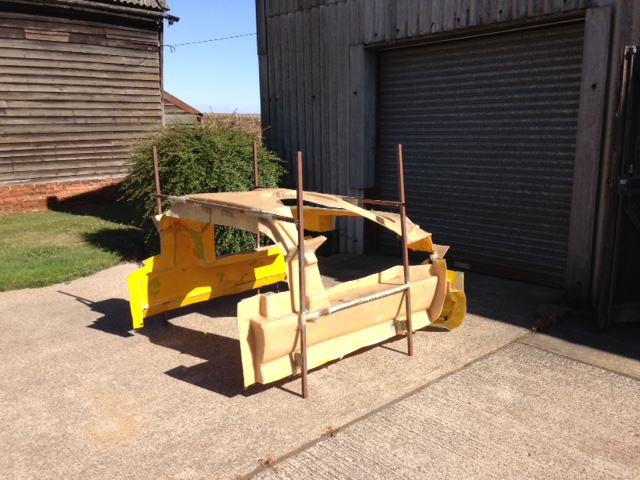

Hi, my name is Triton, i bought the ebay vx220/gt project off ebay (for my sins) What the guy has done is pure genius, to make a one piece central spider tub to bond to a vx 220, with intergral sill pannels. he did it using an old central spider and sills and moded it to fit, then made the mould to replace the mock up. I have bought the mould too. Its a lookie like i know, but when finished should be fun to drive, and turn a few heads for the price of a Cat d vx220 and body panels. The central tub will accomodate doors front and back clams from the usual contenders. I will post some in deapth details and photos once i have my head around the project. I think its the most genius non gt40, gt40 replica around today. It makes me smile at least

The project is way cool, i've just seen the full centre tub mould assembled with lower sills attached and to fit vx220/40 for the first time, it looks well!!! I cant comment on dimensions untill its here, but will let you know as soon as. He thinks the clams came from an abandoned tornado kit from a while back, but could also be KVA.
NT
Hi guys here is a photo of the 1 piece bodytub/sills mould
vx 220 wheelbase 91.7inch, so a bit closer than an elise
more info as soon as i get to grips with it
