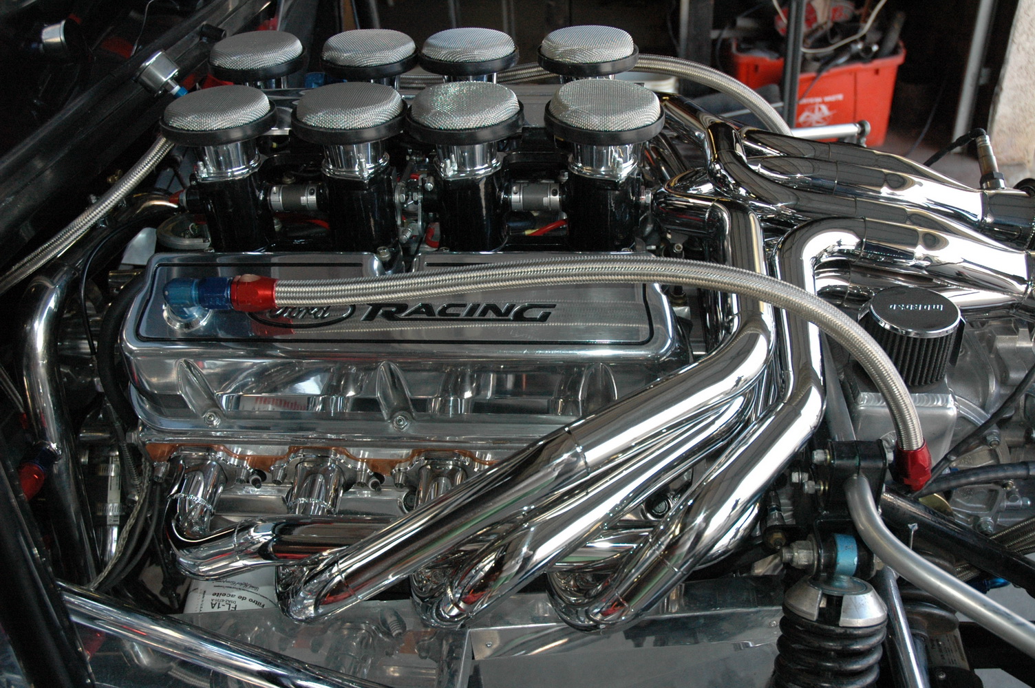

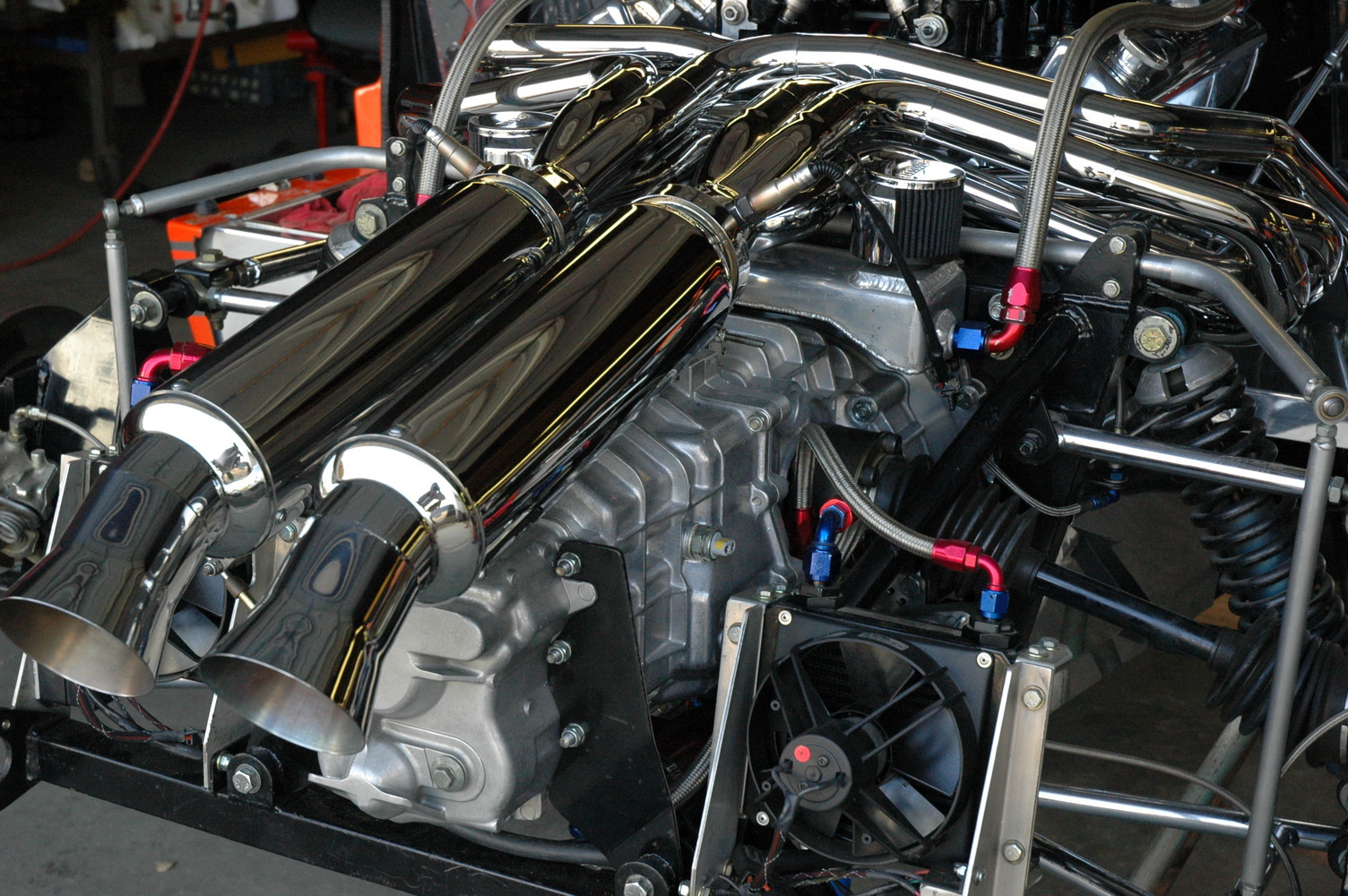

Then Will, your wish will look something like this and Allen, the G50 attached has been most reliable mated to the the 427W (Kennedy adapter)

I think your fantasy engine with specs you note is going to be quite a bit more than a slightly heated up 390FE. A quality stack injected setup is going to run you what? 4 to 5k alone? 2k for the block? More? Yes, if I had an unlimited amount of money I would want something different too, including a 15k transaxle.

Fe will fit, Adapterplate will be delivered with the KIt, G50´s will survive a max 450 lbs ft 390.
If you go higher it calls for modification or the stepup to a turbo version ( G50/50, G50/52, G96/50 order the 930 4 speed which would also be a good visual match to the original carcraft t44.).
Headers need to be custom made ( Kit comes with 302 fitting exhaust system).
