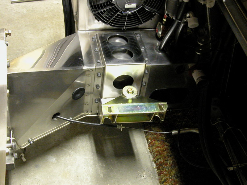

I have CAV#66 and I am aware of the problem. The motor mount bushings are small and can wear out quickly. I redesigned the mount system to look more like the original mounts. I also wanted them to be ajustable both up and down with shim washers and front to back.
I will try to attach a picture.
Ken
