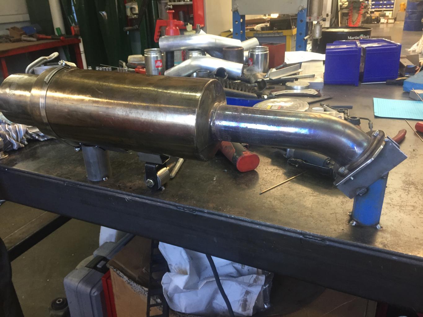

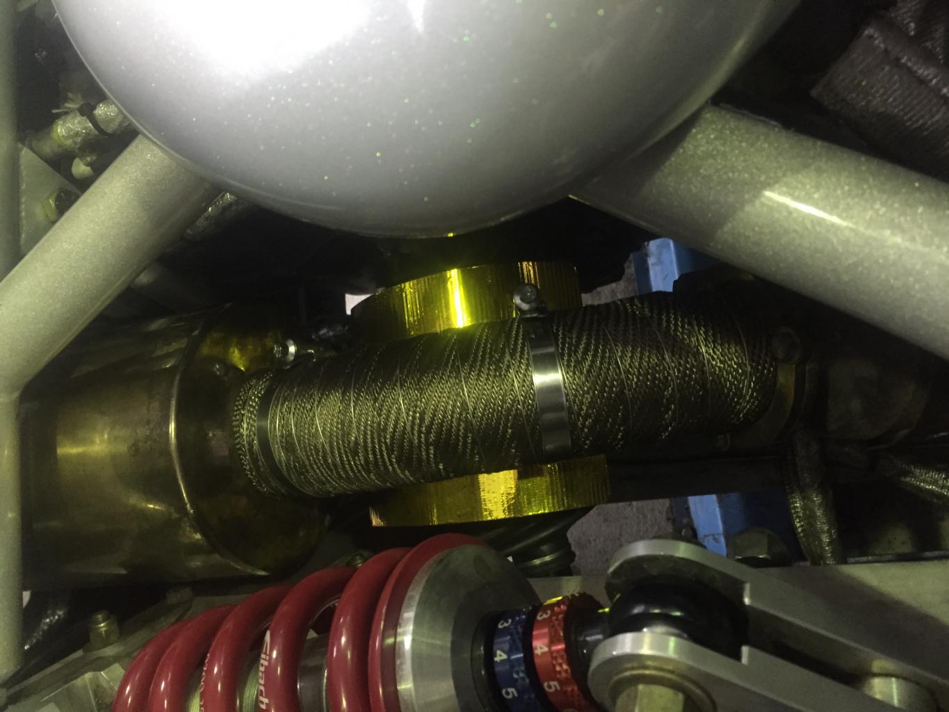

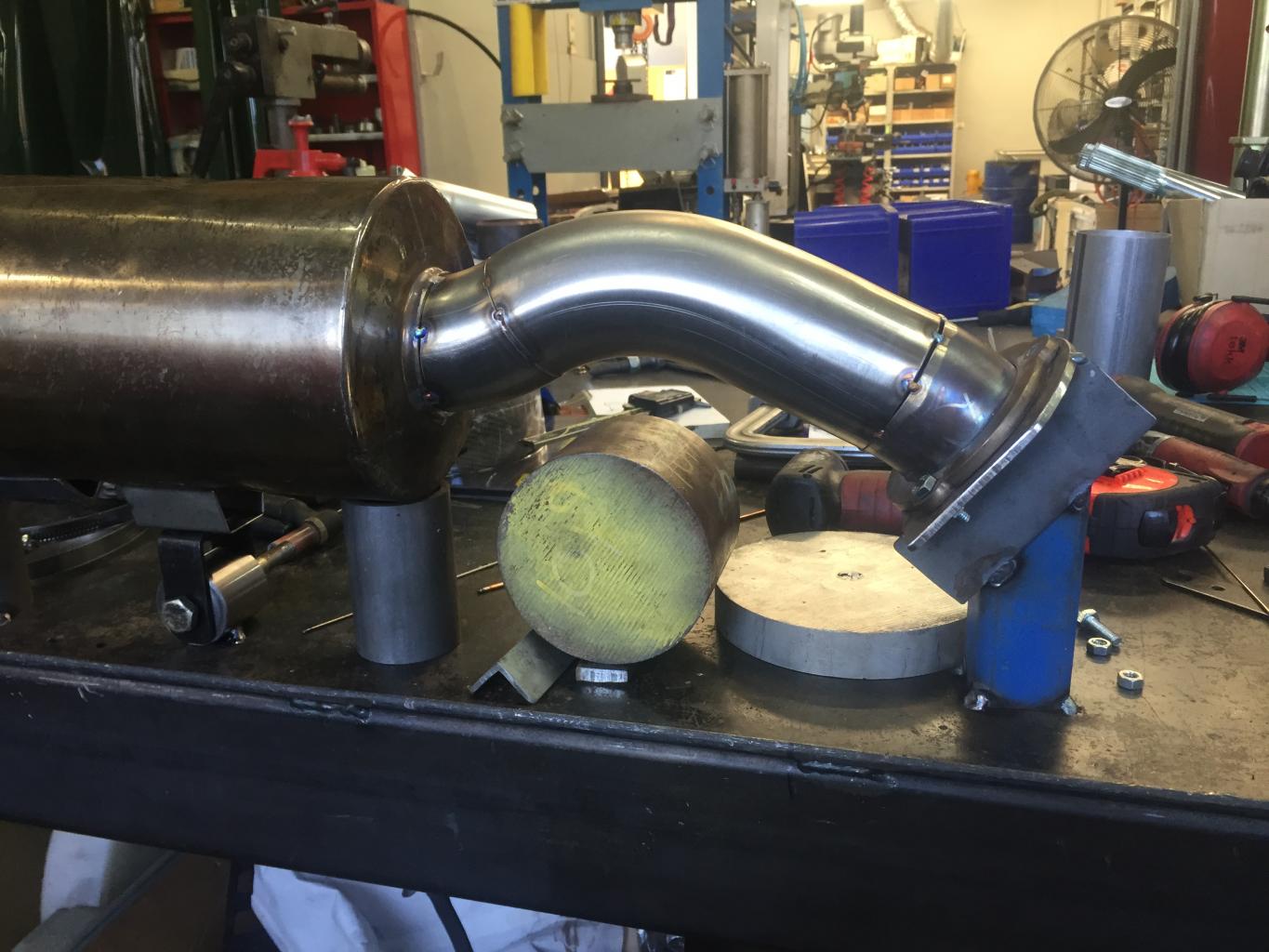

The only work performed recently on the SLC was an alteration of the exhaust systems as it ran to close to the transaxle CV boots, like a fingers width, and was damaging the CV boots. Pics attached of a new bend in the exhaust and heat shielding installed. Plus a couple of shots from a drive last weekend.
