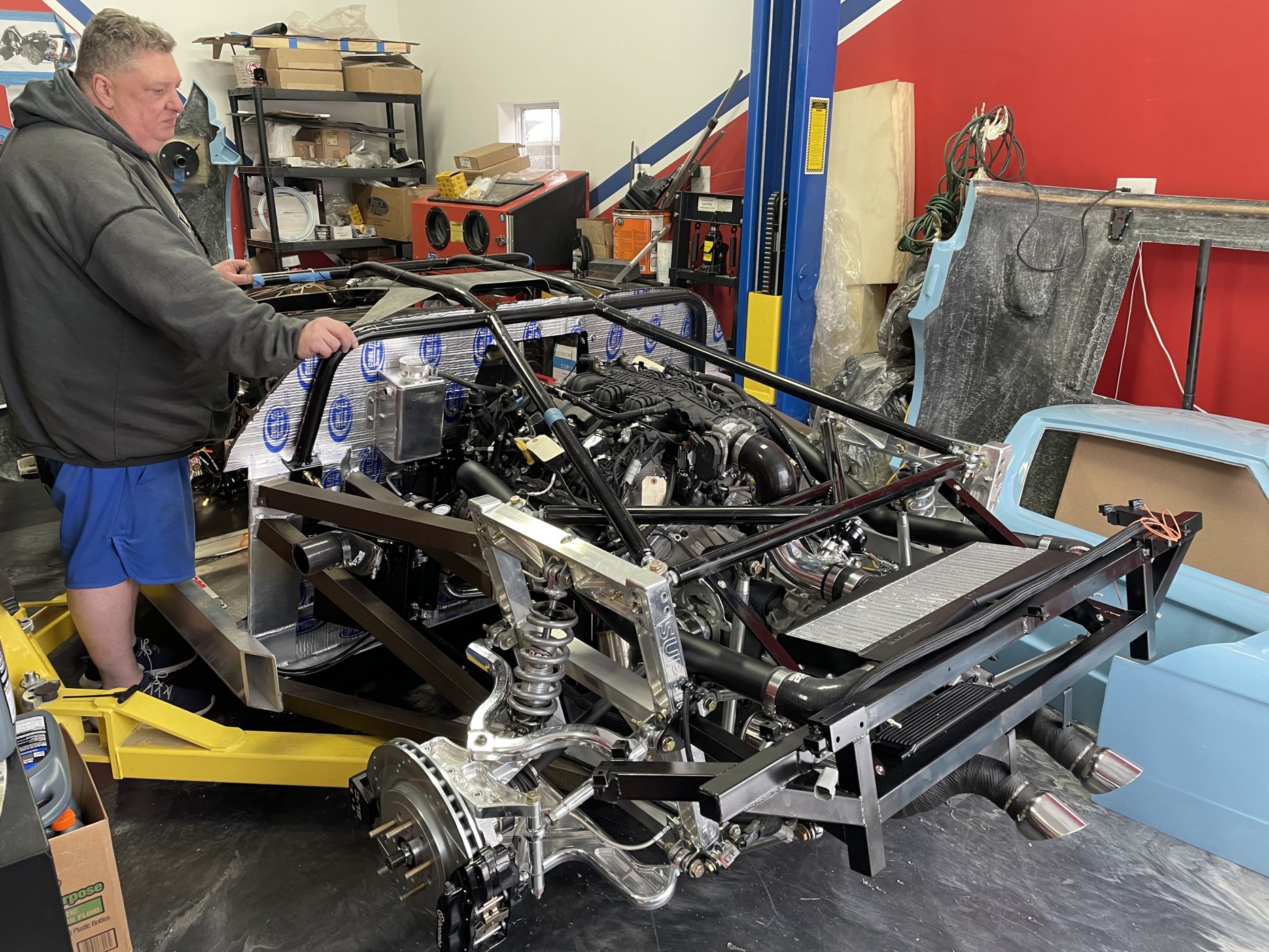

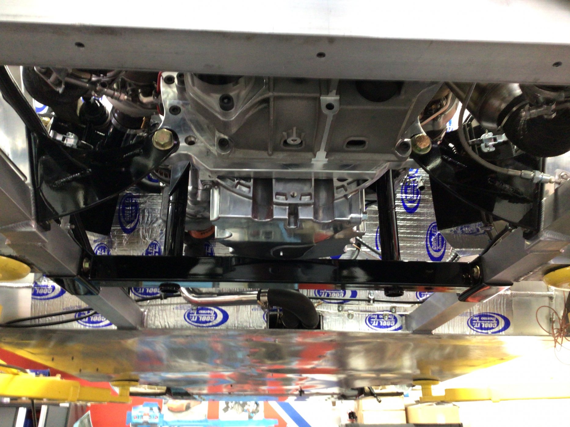

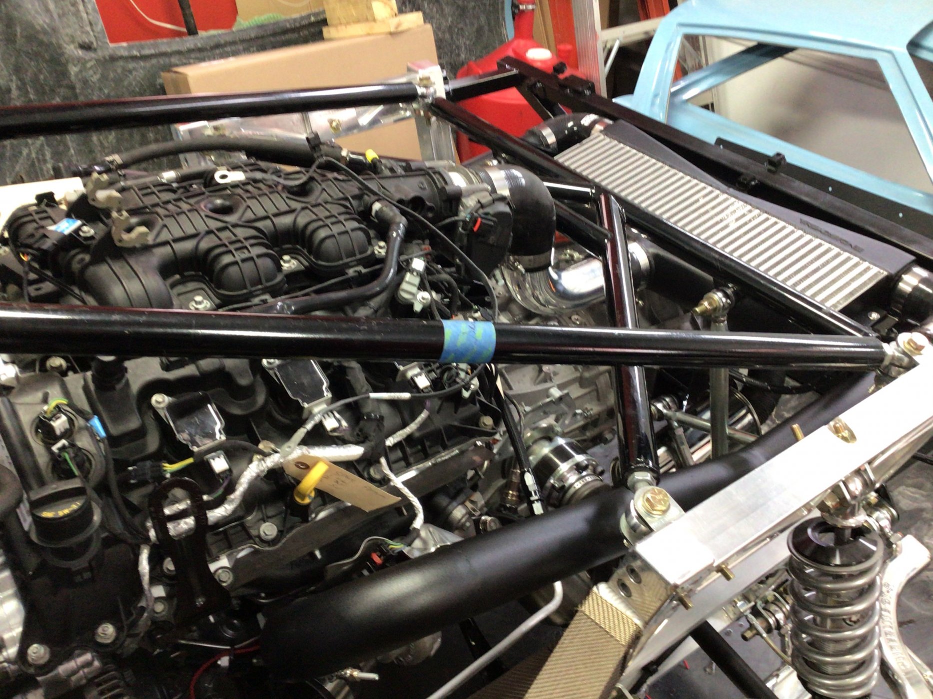

So she is slowly coming back together all I need is time and that is short when this working thing keeps getting in the way but you know the old saying will sell no wine before it’s time

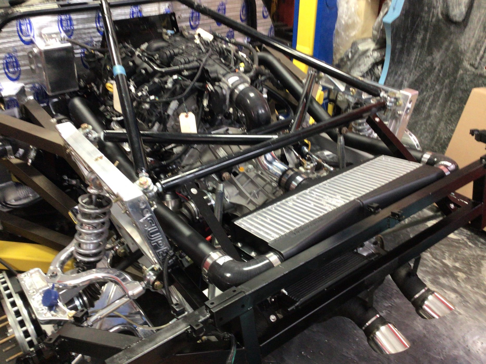

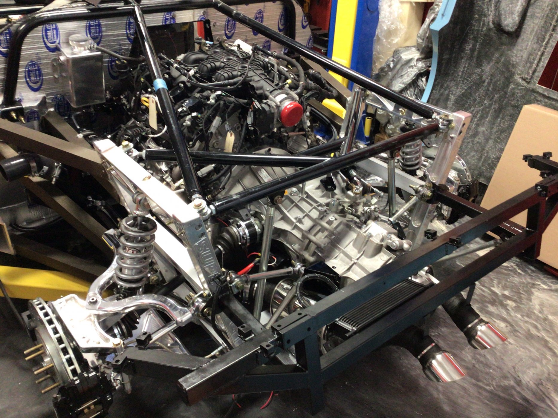

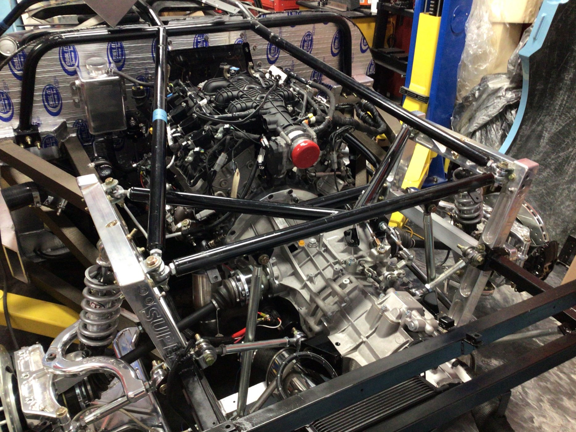

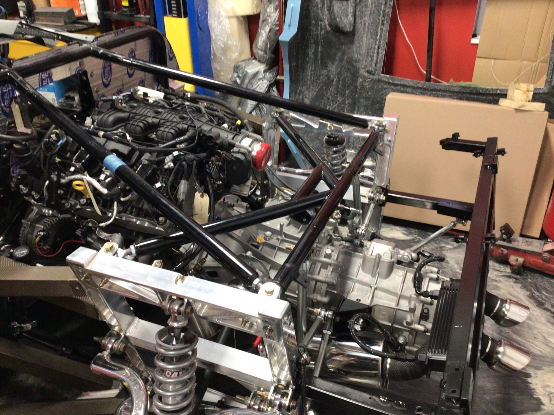

A couple more things added between snow blowing

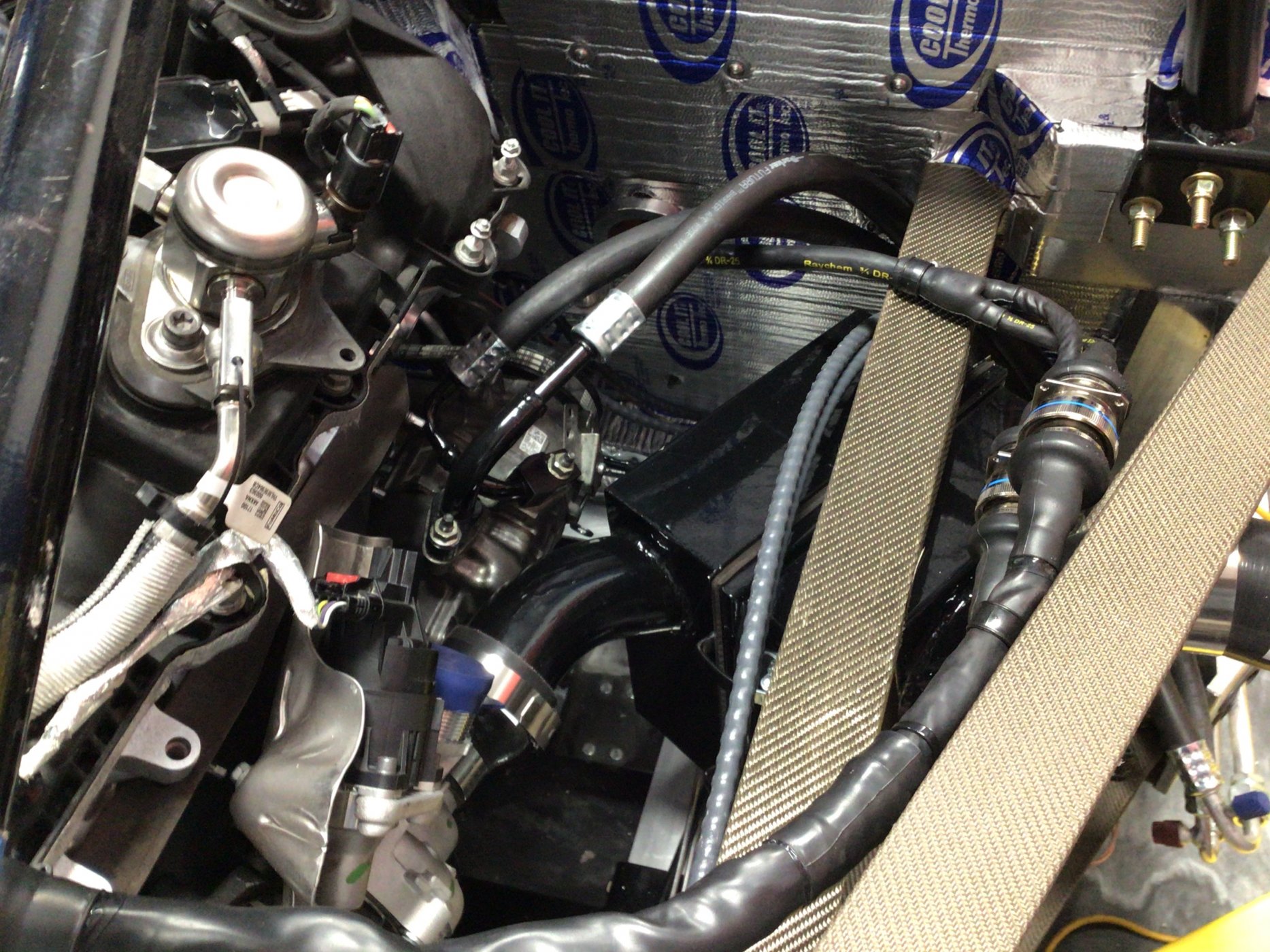

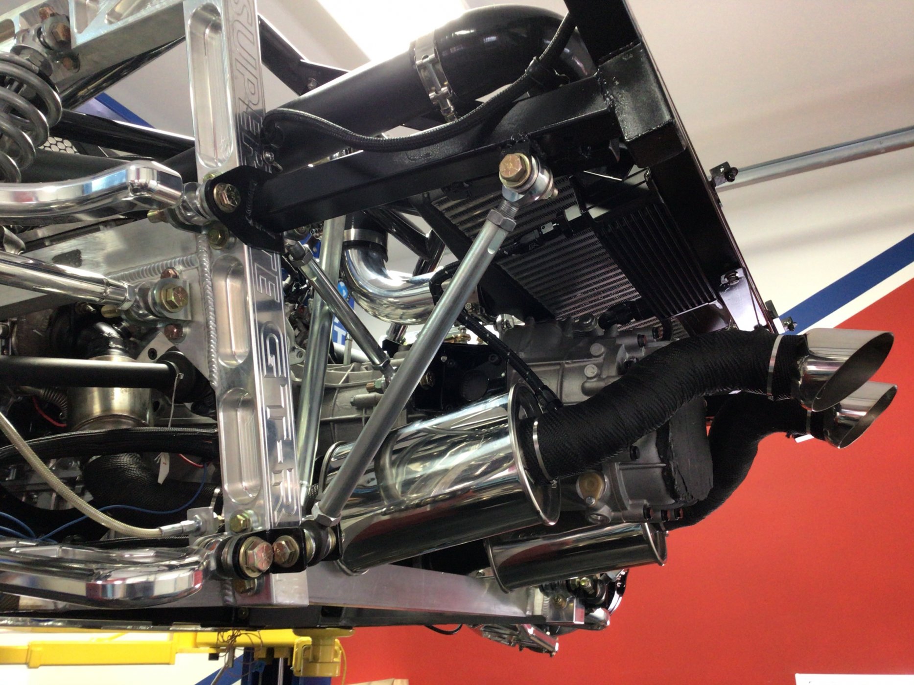

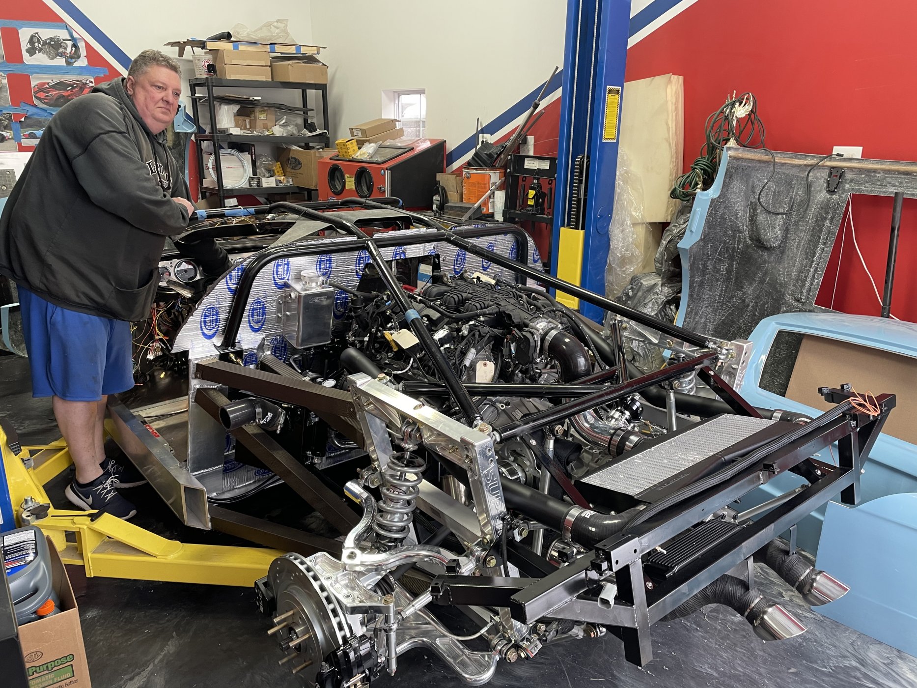

Ok so I had a good day I wanted to see if I could get the car fired up for the first time and we’ll she ran on the first try. No with all builds there is the occasional leaks or wired sounds so I am going to need to do a once over. I will post the running engine once I sort out the bugs

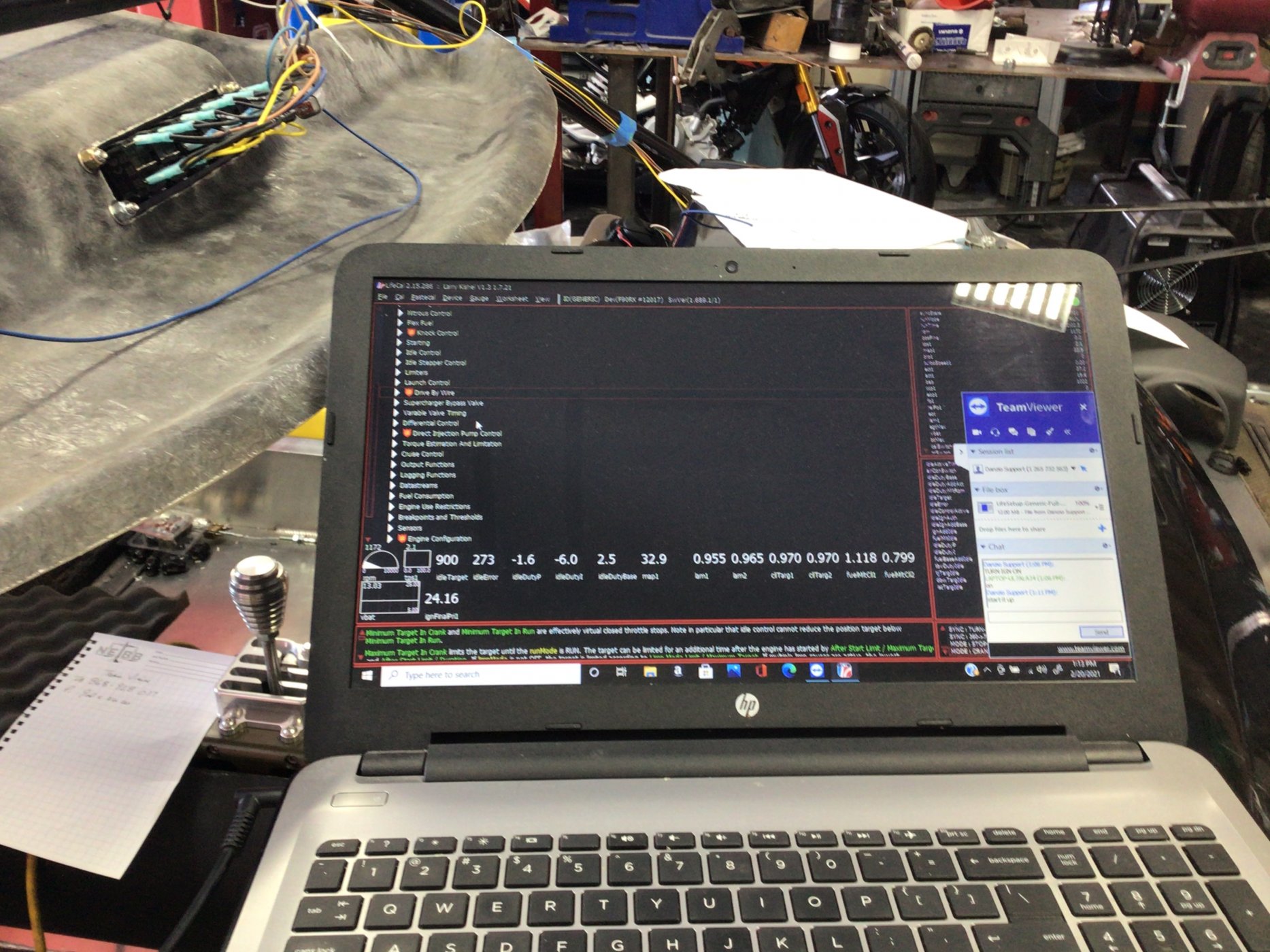

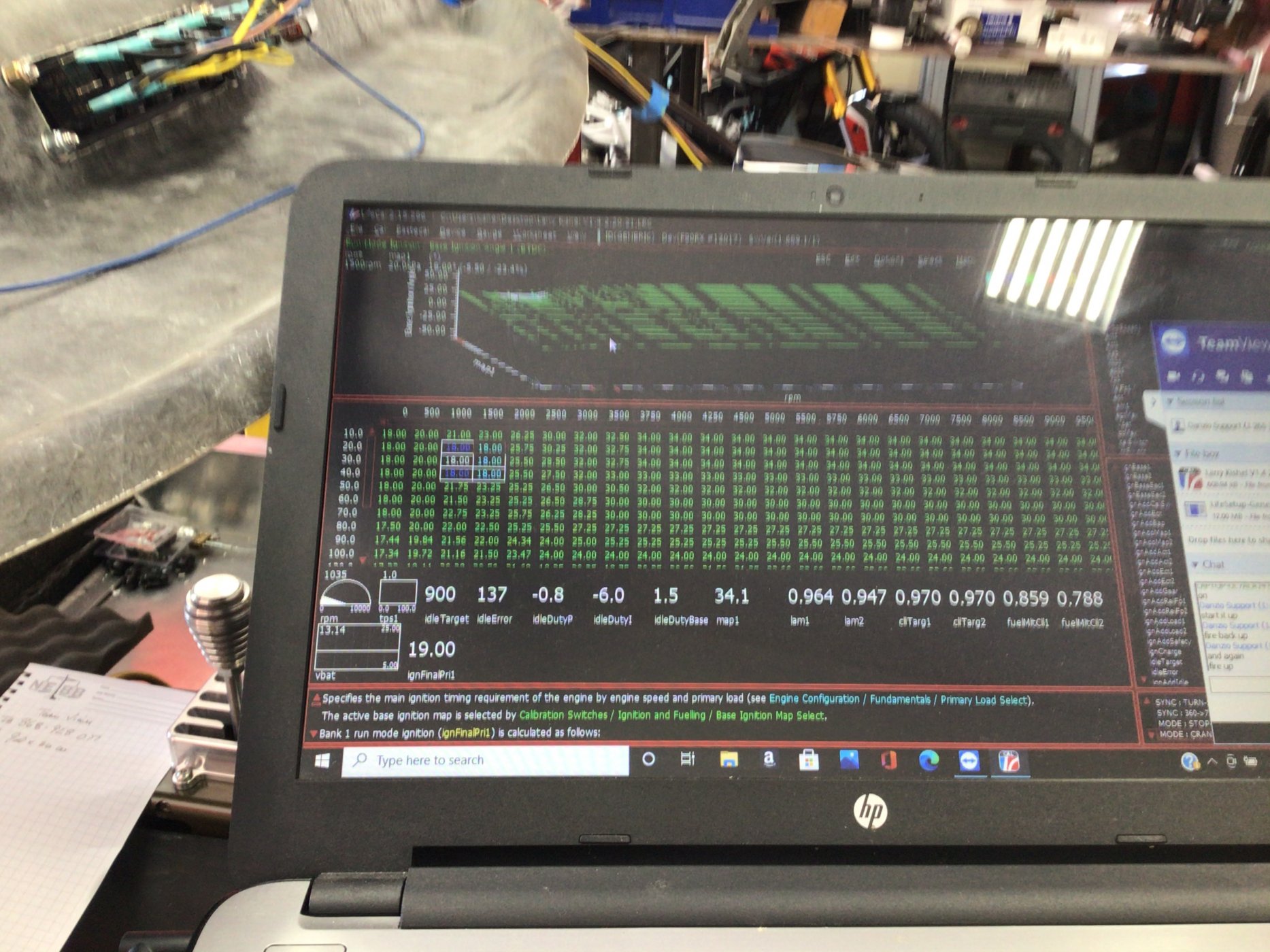

Sometimes I do like modern technology so today I had Chris from Danzio Performance log in from California and do some tweaks to his program so she is running perfect
The above is the motor running after the tuning from Danzio in Calf she sounds good I was able to drive in and out of the garage today so I am happy now time to finish up a few more task and off to Allans for paint and final touches

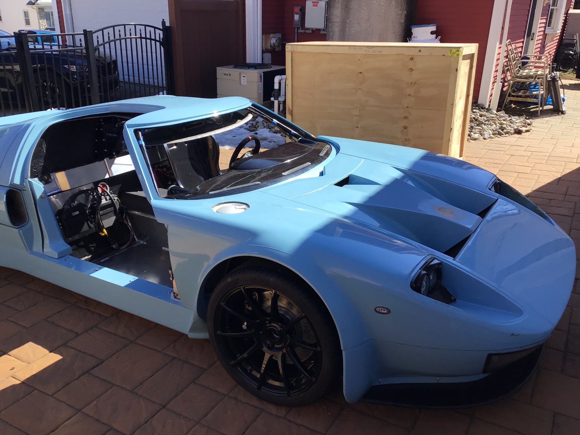

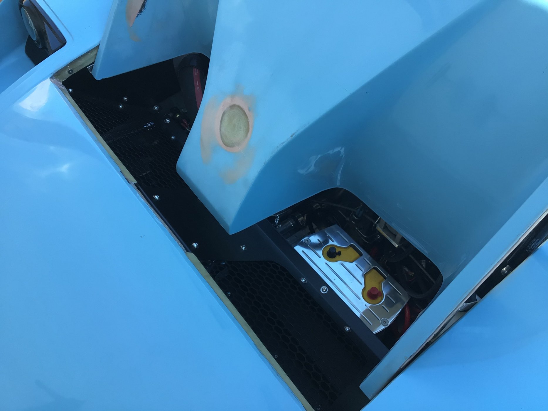

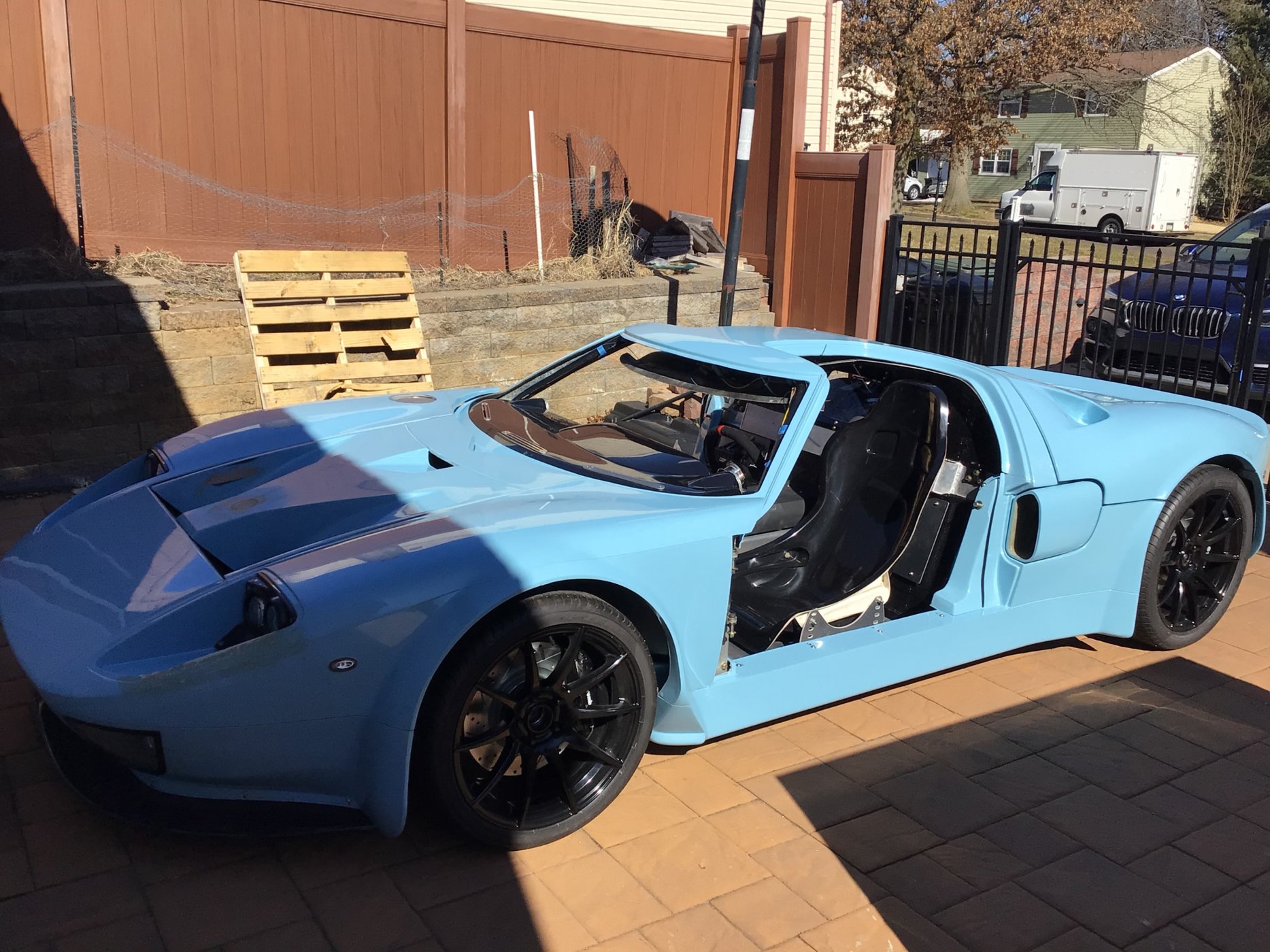

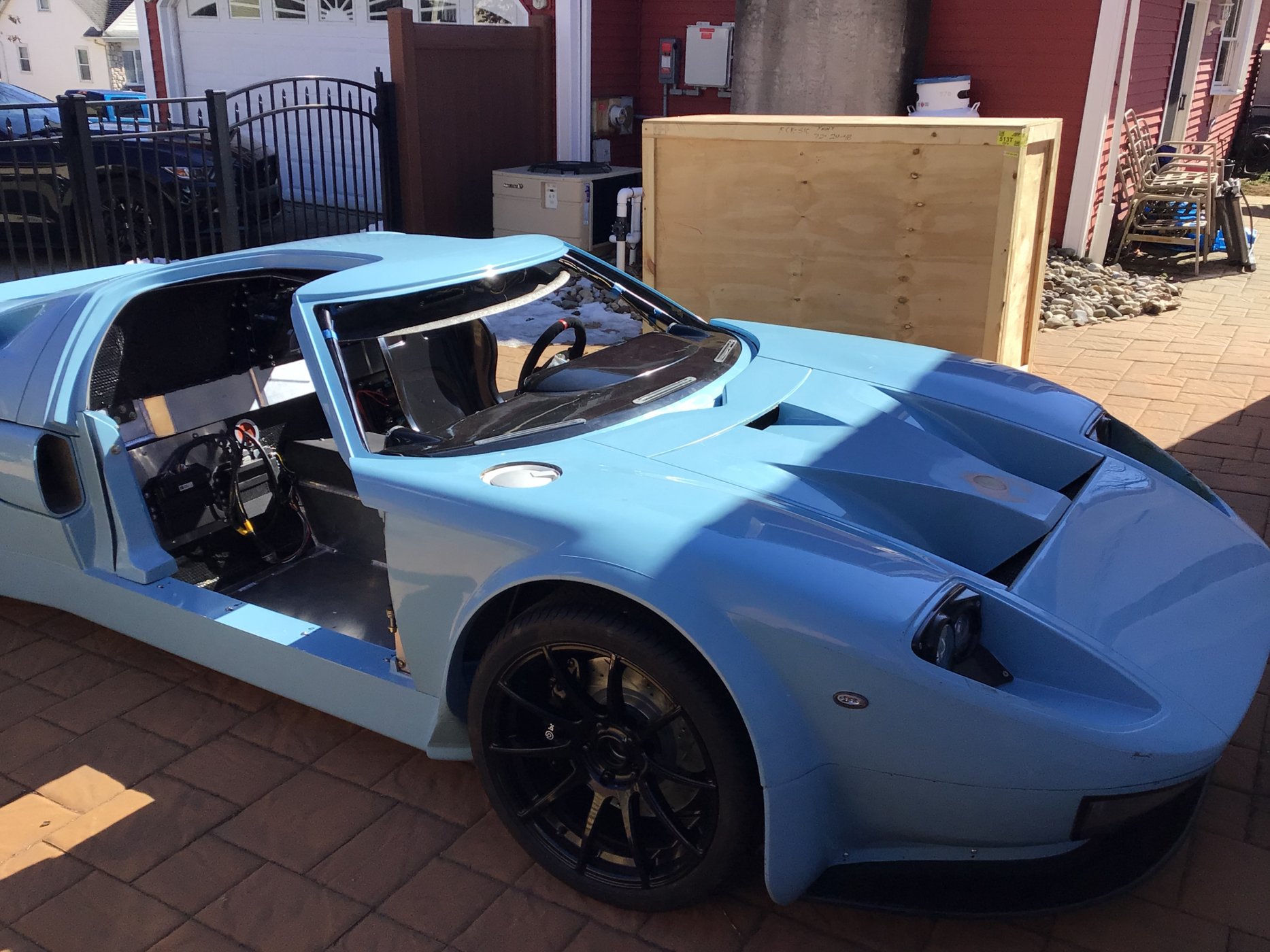

So I was able to take the car around the block a couple of times today she felt good I think a few tweaks here and there we should be good. I did go into the throttle a little just to here the turbos kit in wow I think this will be one fun car to drive.
