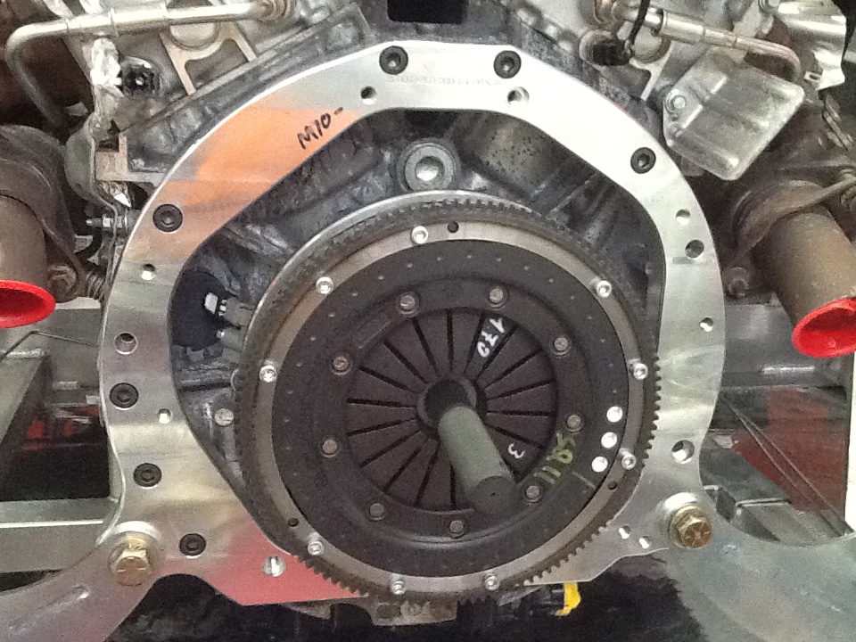

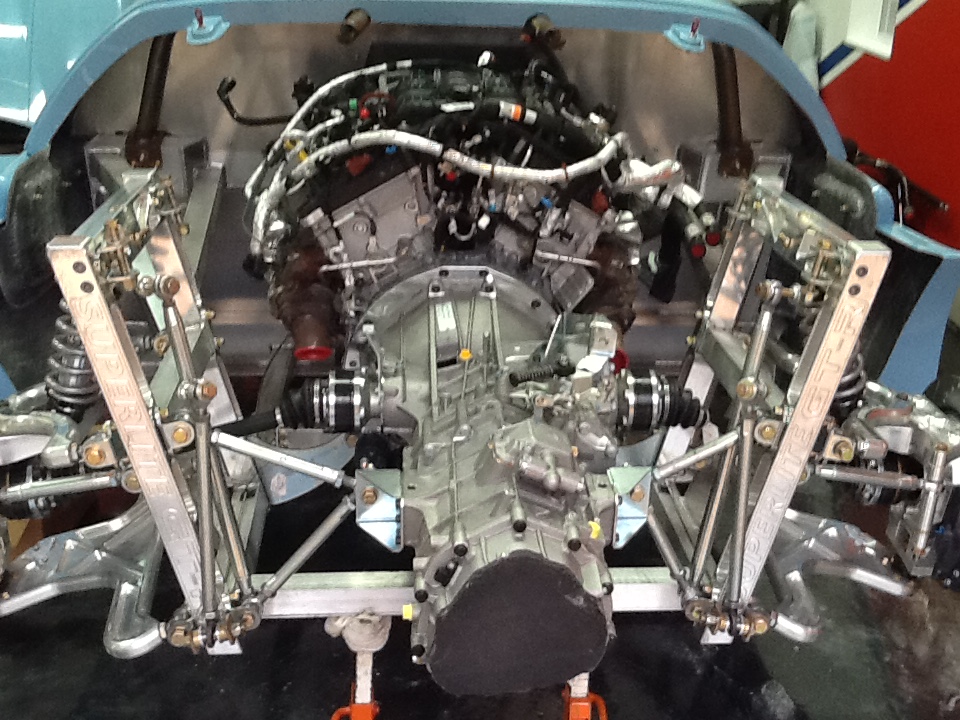

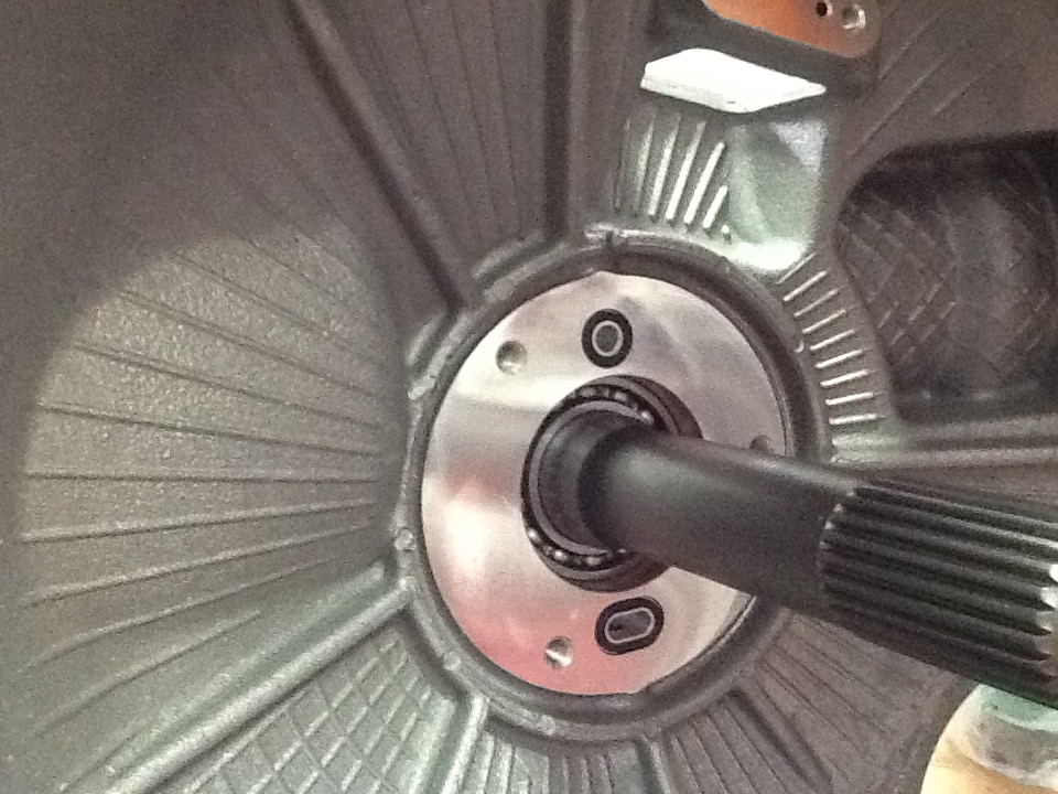

Well I finally was able to get back into the garage today, I installled the new 3.5 Ecoboost Twin Turbo motor and the clutch and Graz Trans now I can start planning the air intakes and exhaust systems
