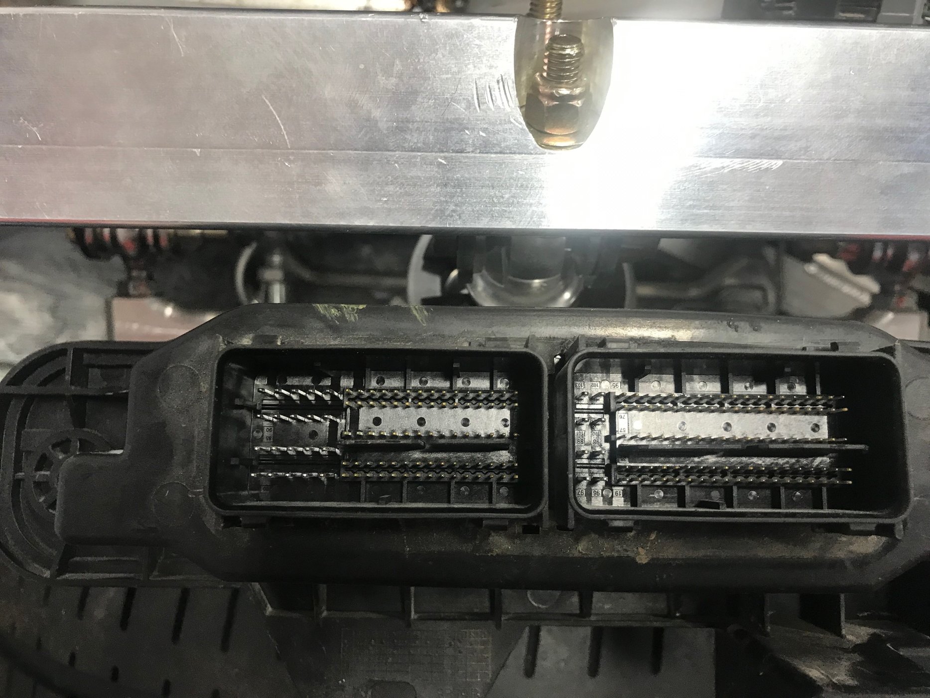

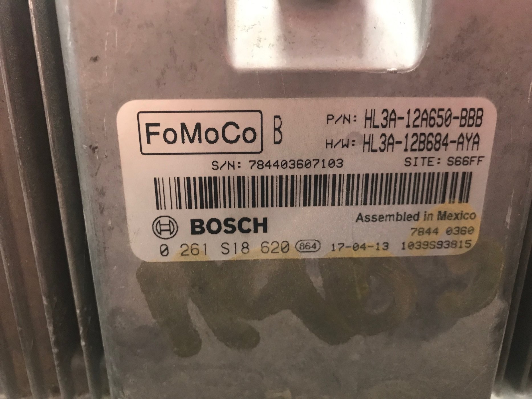

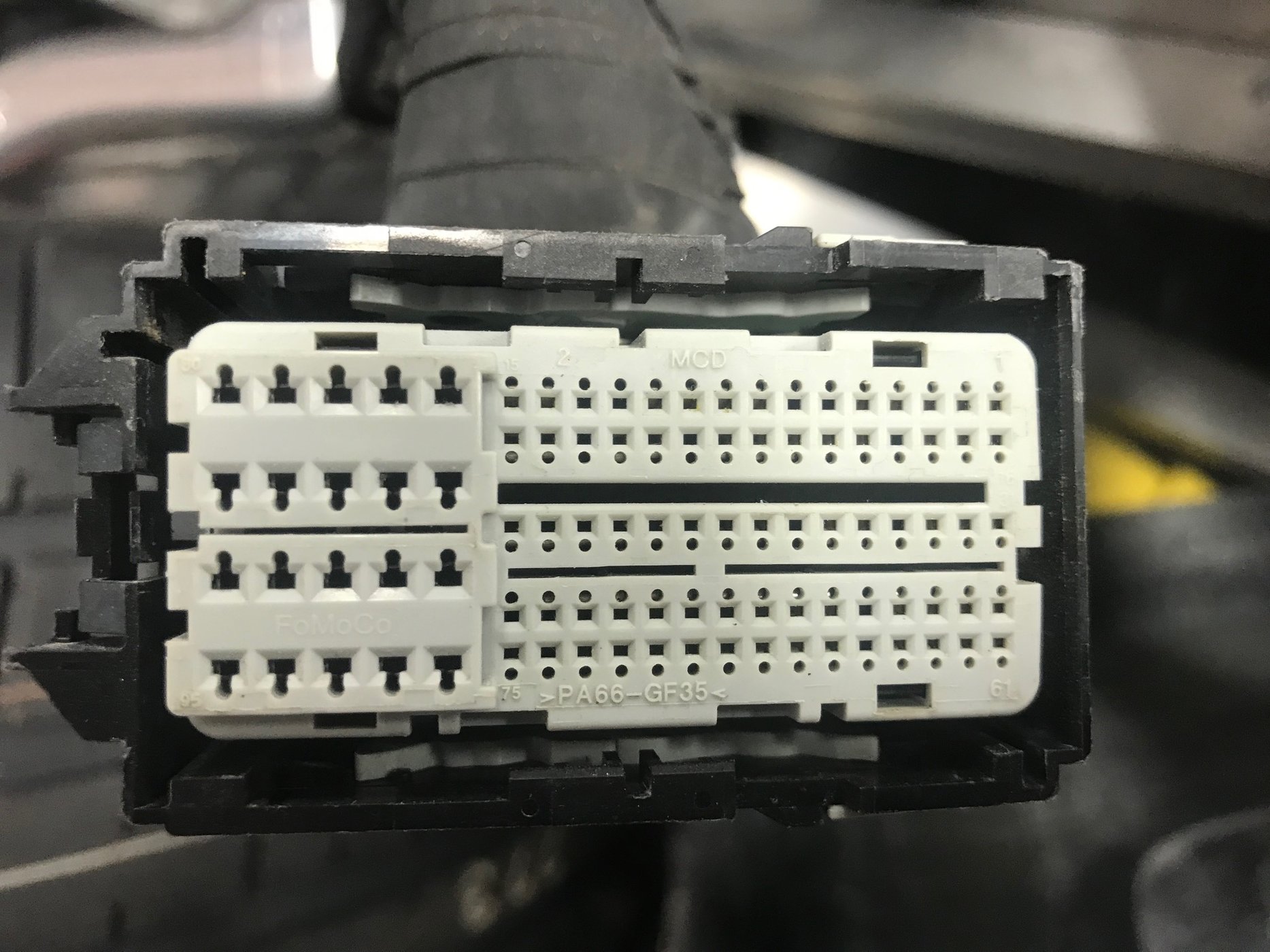

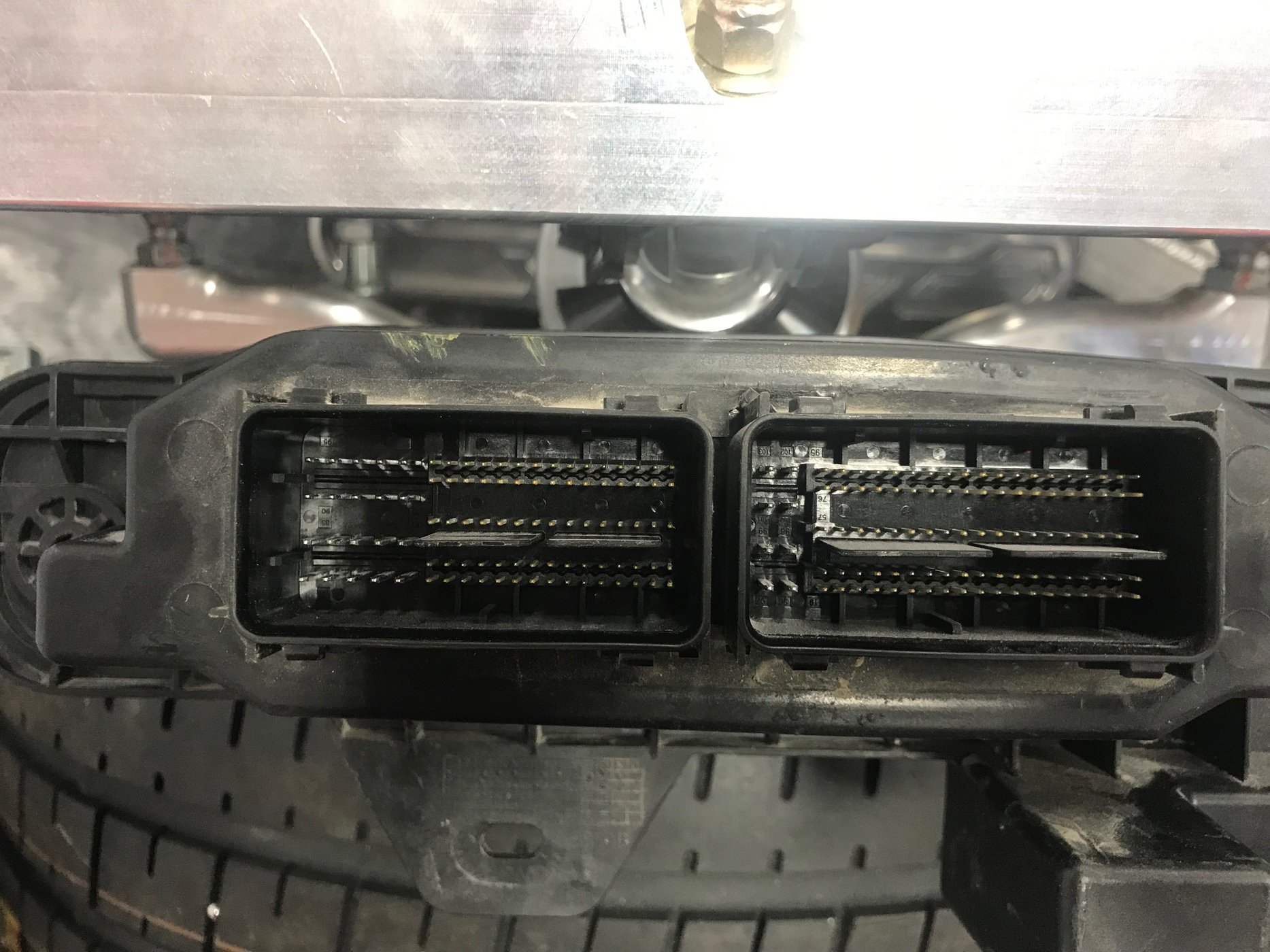

Allan let me know if this works this is the 2017 Ford F 150 Donner Truck PCM with Connector.
The PCM has two ports, which is what I expected. Now I have to look into whether we can run using only one port, since you only seem to have one plug at the moment, or if we have to track down the other half of the harness.

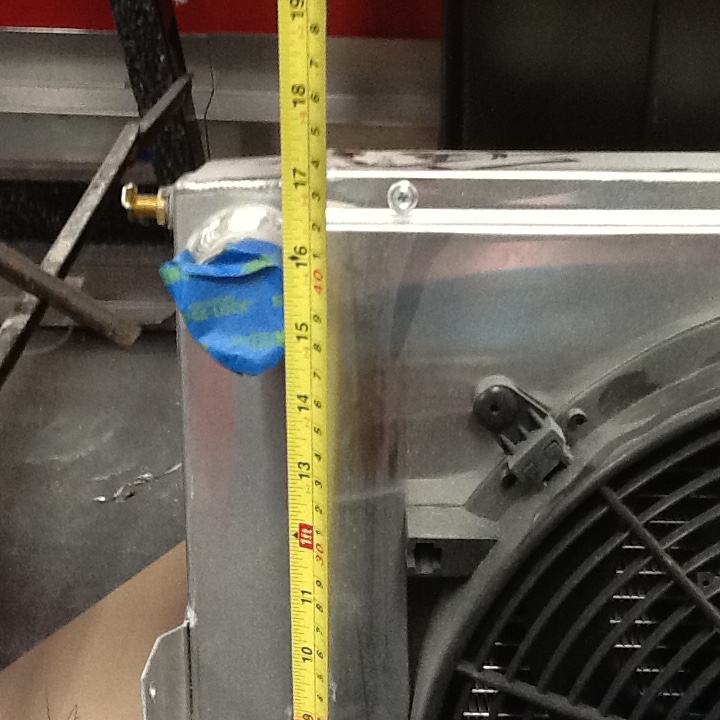

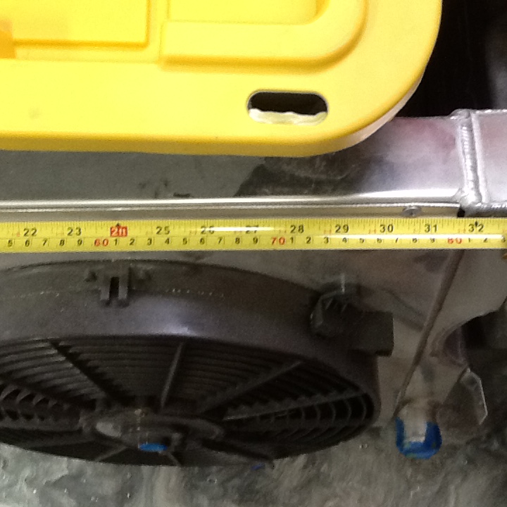

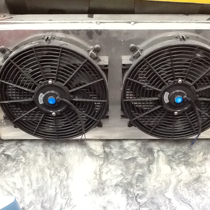

Could I ask a favor Larry. Can you measure your fan shroud for me? Or at least the size that will be required to cover the rad core area.
Are your fans 13"?
Ken it appears the shroud is 32 "" wide by 16 "" tall by approx 1"" deep an has two 14"" dial fans I hope this helps
