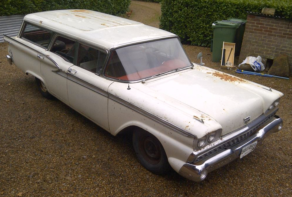

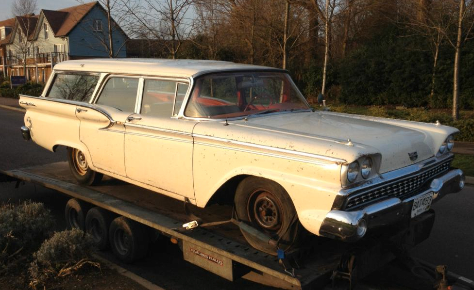

Ok - firstly this is not GT40 related, However I'm currently helping a friend with a newly acquired 'tow car' which I picture below. The car is a 1959 Ford Country Sedan although I'm nicknaming her 'HMS HOOD' as dimensionally I think its similar in overall length! (and possibly weight!)

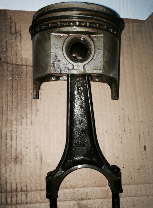

Anyway, the fitted motor is seized but she came with a spare reportedly from an Edsel but I'm not sure at the moment. The block is marked 352 34, which I think many blocks were marked with. It is a top oiler with hydraulic lifters and 2 bolt mains. Oh and it weighs an absolute TON!!
Not had a proper chance to measure things but it looks to be 4" bore (4.05?) and about 4" stroke - which I think makes it about 410 ci and I am guessing that is also reflected by the 410 markings on the pistons?? However, my book does not seem to show the Edsel being fitted with 410s..?

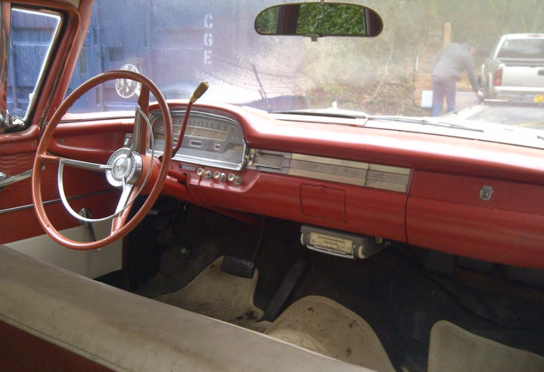

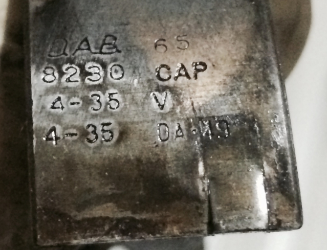

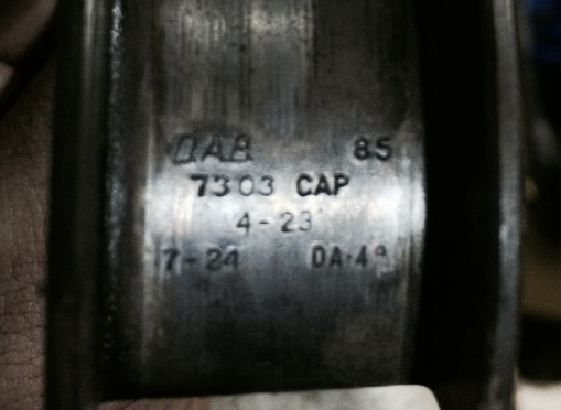

Here's a few pictures, of car, interior, some parts and the glovebox contents (apparently it has not been used or run for years!). Also, can anyone spread any light on the markings on the main and big end shells? are the 65 and 85 date codes? or do they mean something else.?
