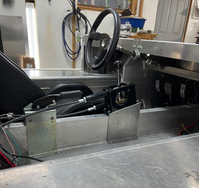

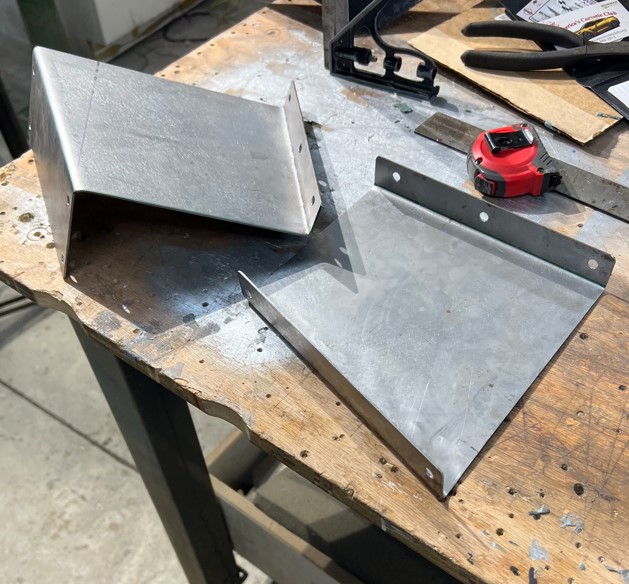

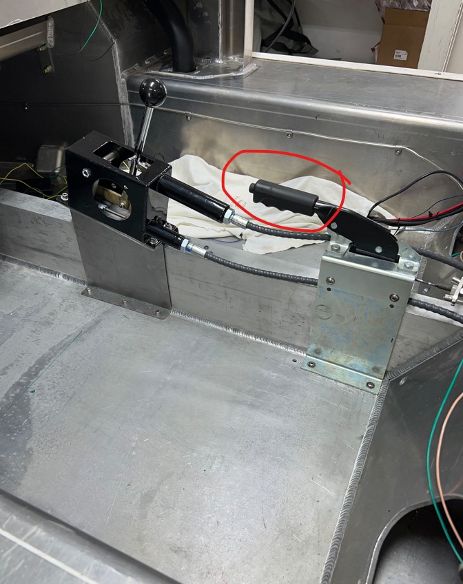

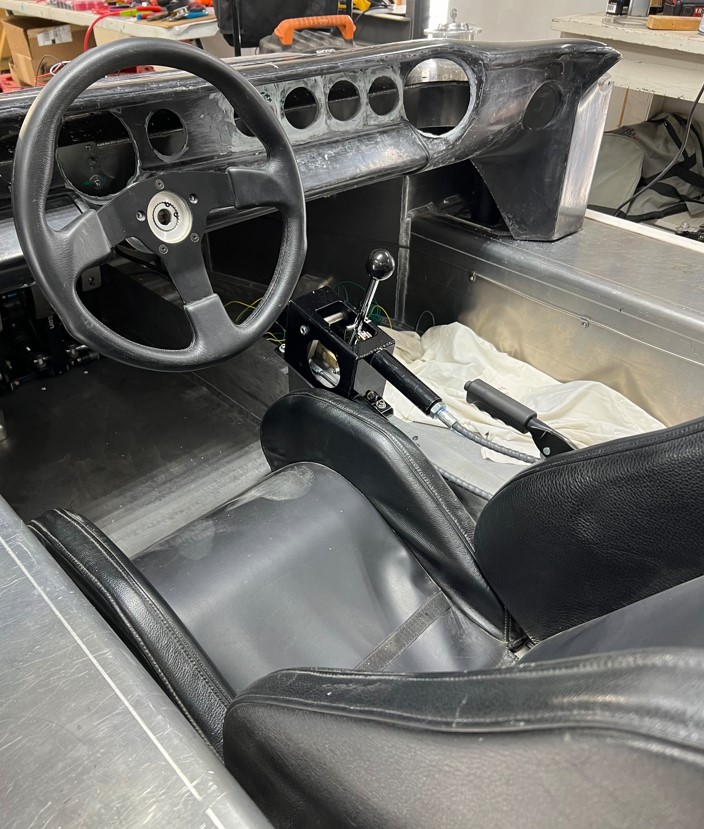

Today I finished mounting the shifter and routing the cables to the Quaife QBE62G transaxle. The challenge was getting the RCR provided shifter to clear the e-brake. The solution was to mount the shifter box on a slight angle. You cannot bolt into the tunnel due to coolant and A/C hose clearance issues. Bending sheet metal and mounting to the floor was the best option.
