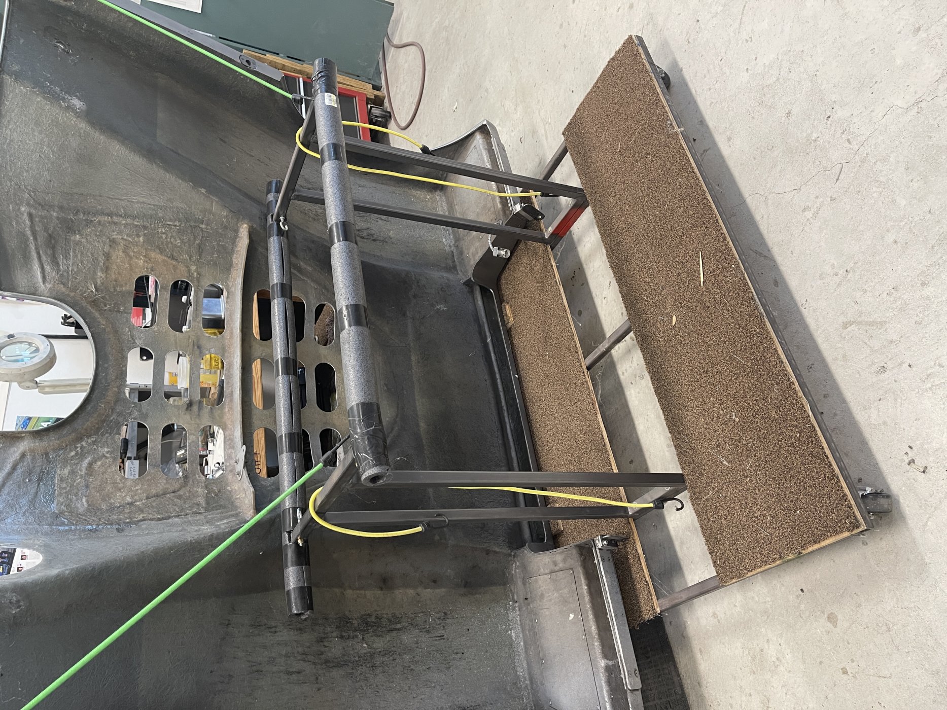

Pat, for front and rear storage, I am going copy a solution shown to me by Howard John. It’s a cart he welded up. That’s an SLC rear end in the picture, but he also uses it for his GT40. For the spider I am going to make a wood bracing frame from 2x3s and hang it on a wall along with the doors and rocker panels. Looking forward to following your build progress. Cheers, Randy

thanks! I was worried about storing them vertically. I figured I needed to have them laying on a brace like they would sit on the car.

I think that the front and rear are more likely to deform if left laying down since the span of unsupported fiberglass would be greater in that position, especially at open end where they join with the rest of the car. I think it would also be safe to hang them from a wall or ceiling if the opening is down.
