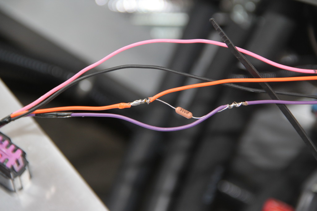

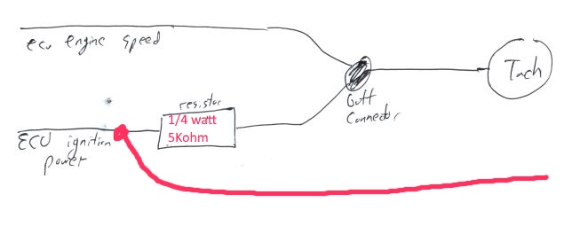

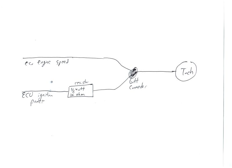

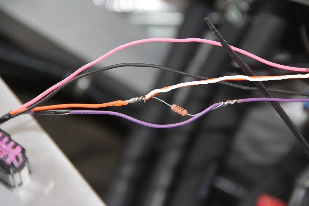

I tried to get a tach signal without the pull-up resistor - does not work with the Koso; added it back in and it now works fine. This suggests that my original wiring was all correct and all these problems were caused by a simple short in the speed sensor wiring.
Also, it seems that the Koso has no problems with 12 volt signal wires so I don't know what the tech guy at Koso was feeding me that got me paranoid - the gauge was not fried after all.
