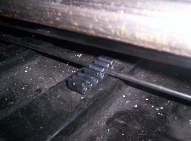

Could you try and use these sort of clips.
I used them all over my car to secure the brake pipes.
