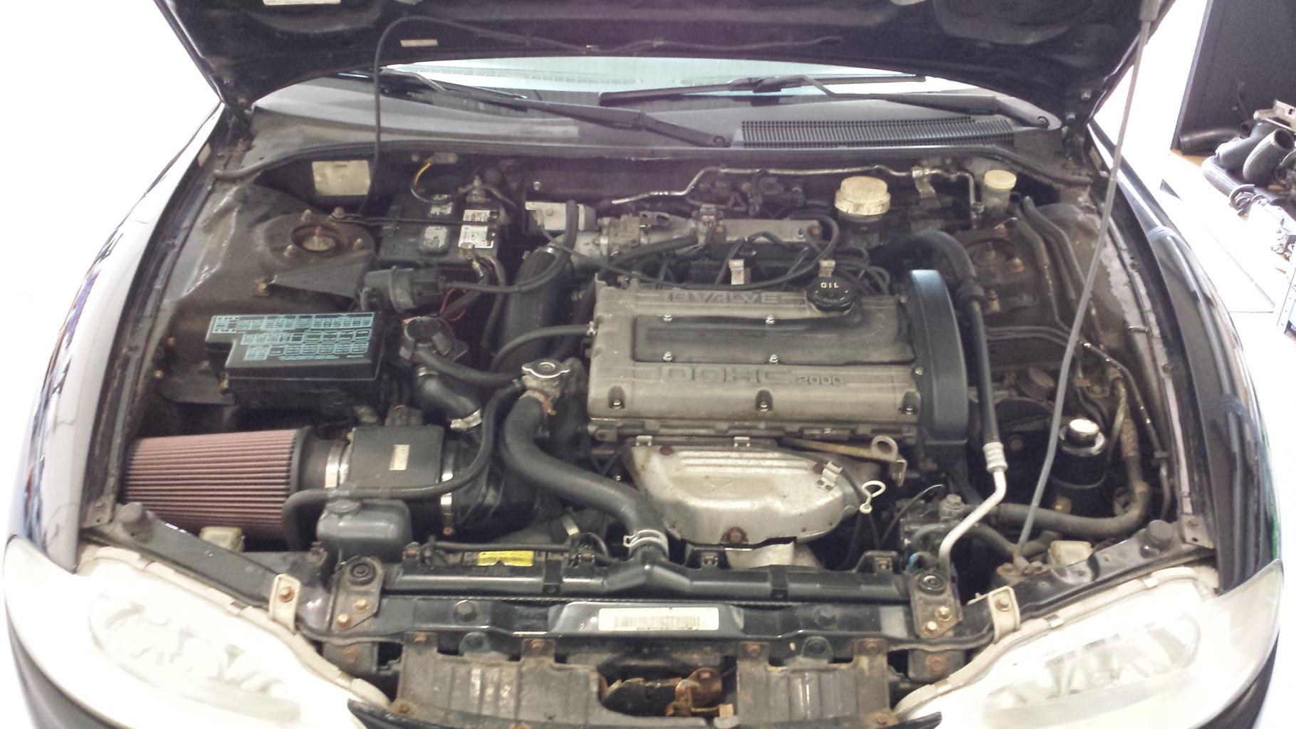

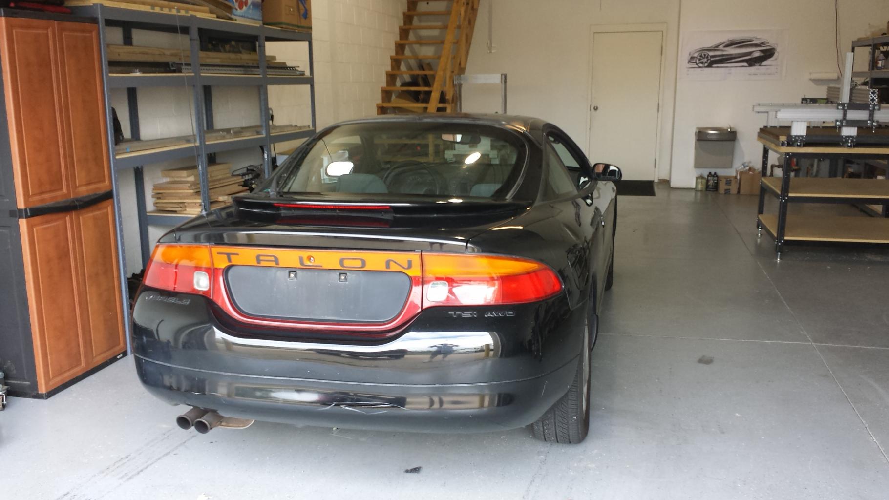

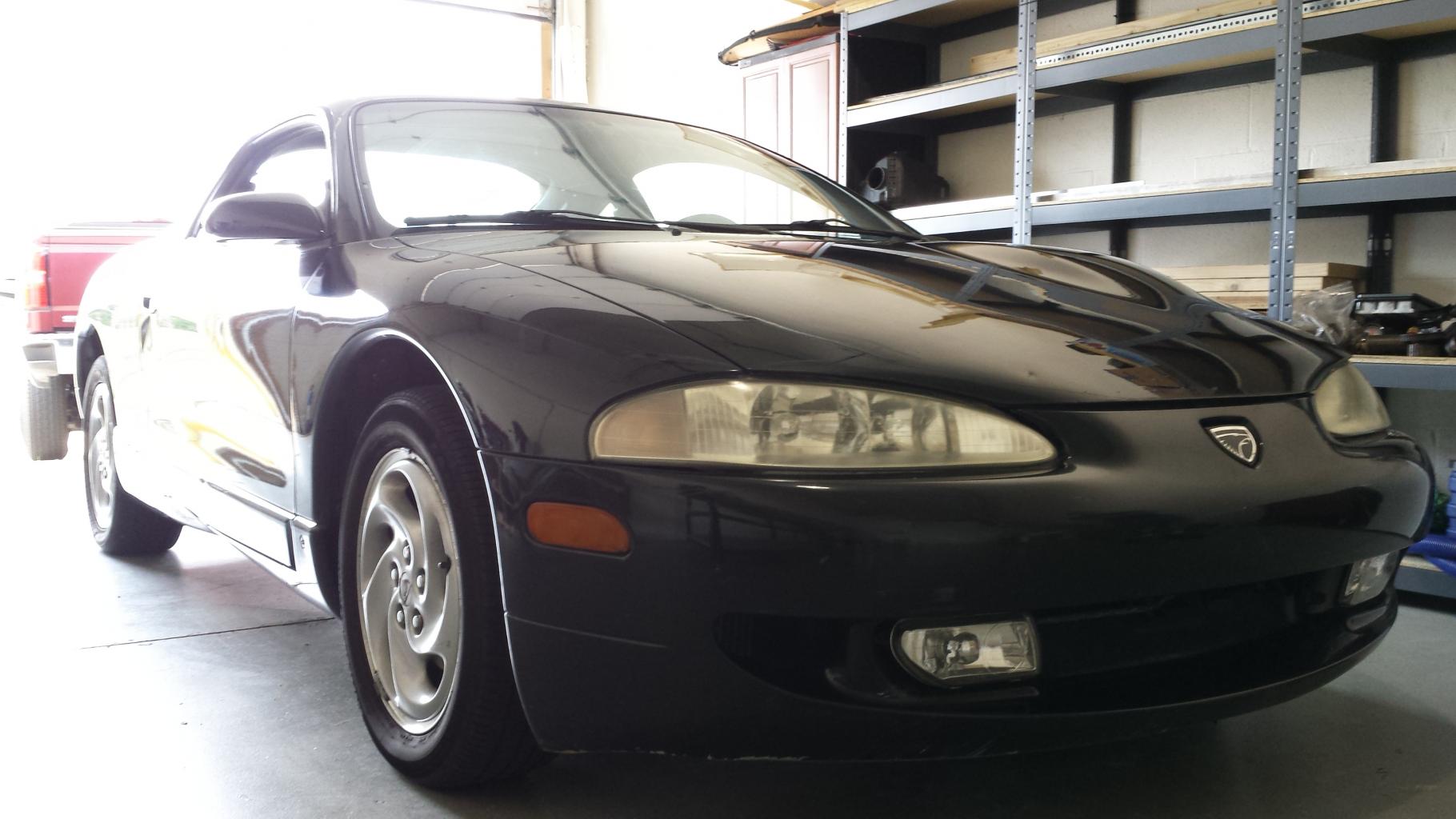

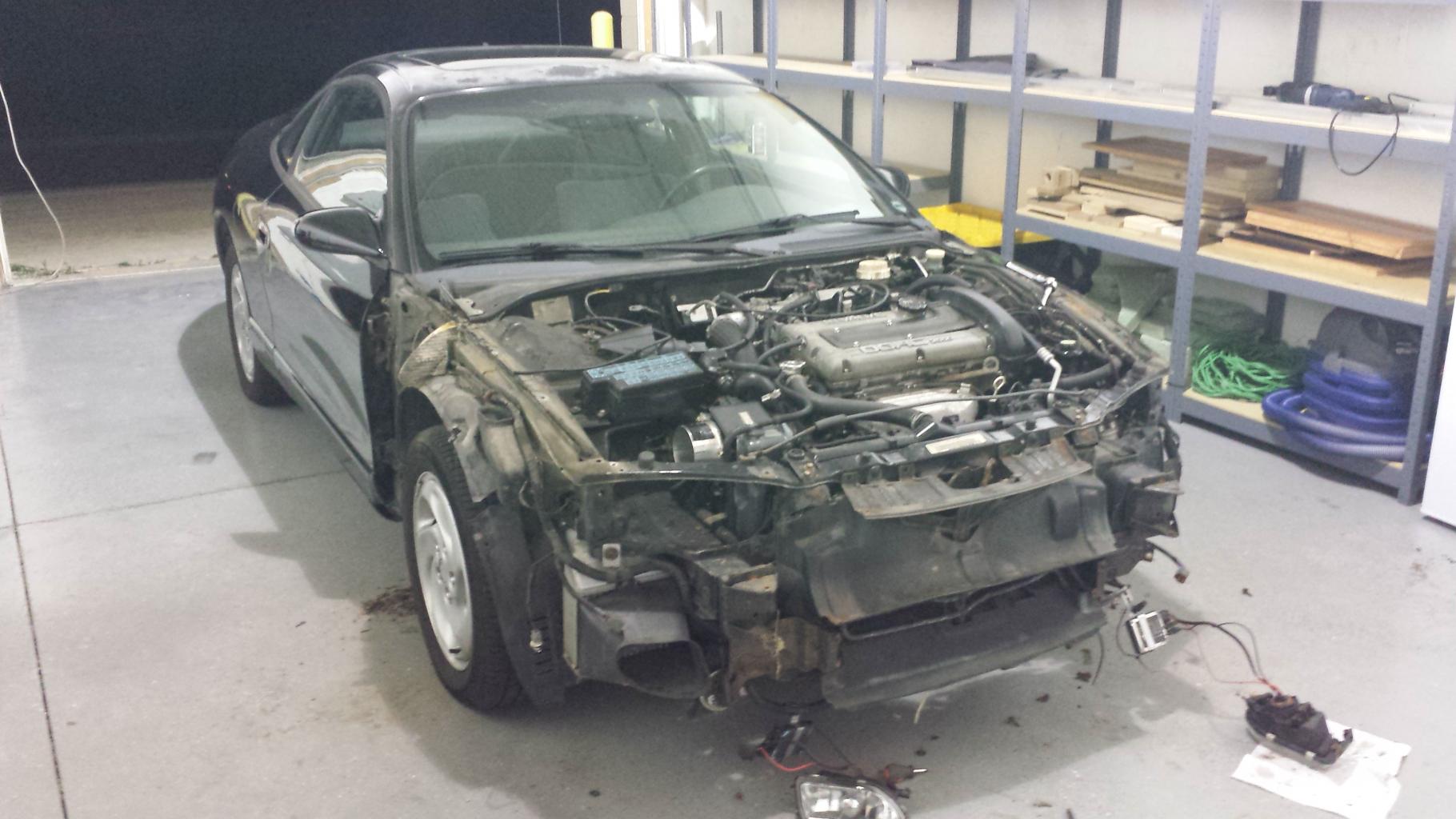

About a year ago I picked up a pretty clean 1995 Eagle Talon TSi AWD for $1500. It had symptoms of 'Crankwalk' but it drove home.
So far I've parted out things I didn't need like the Transmission, Rear Diff, and suspension, and wheels, and I've made back $1200 from the initial $1500. As far as a donor car investment that's not bad, plus I gave back to the DSM community allowing others to get their cars back on the road...
So here's what the Talon looked like...

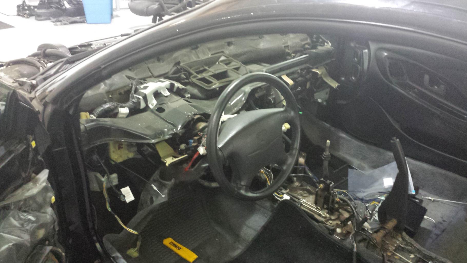

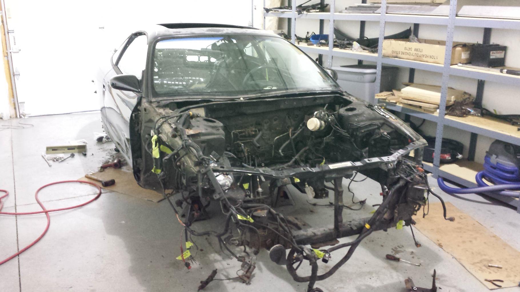

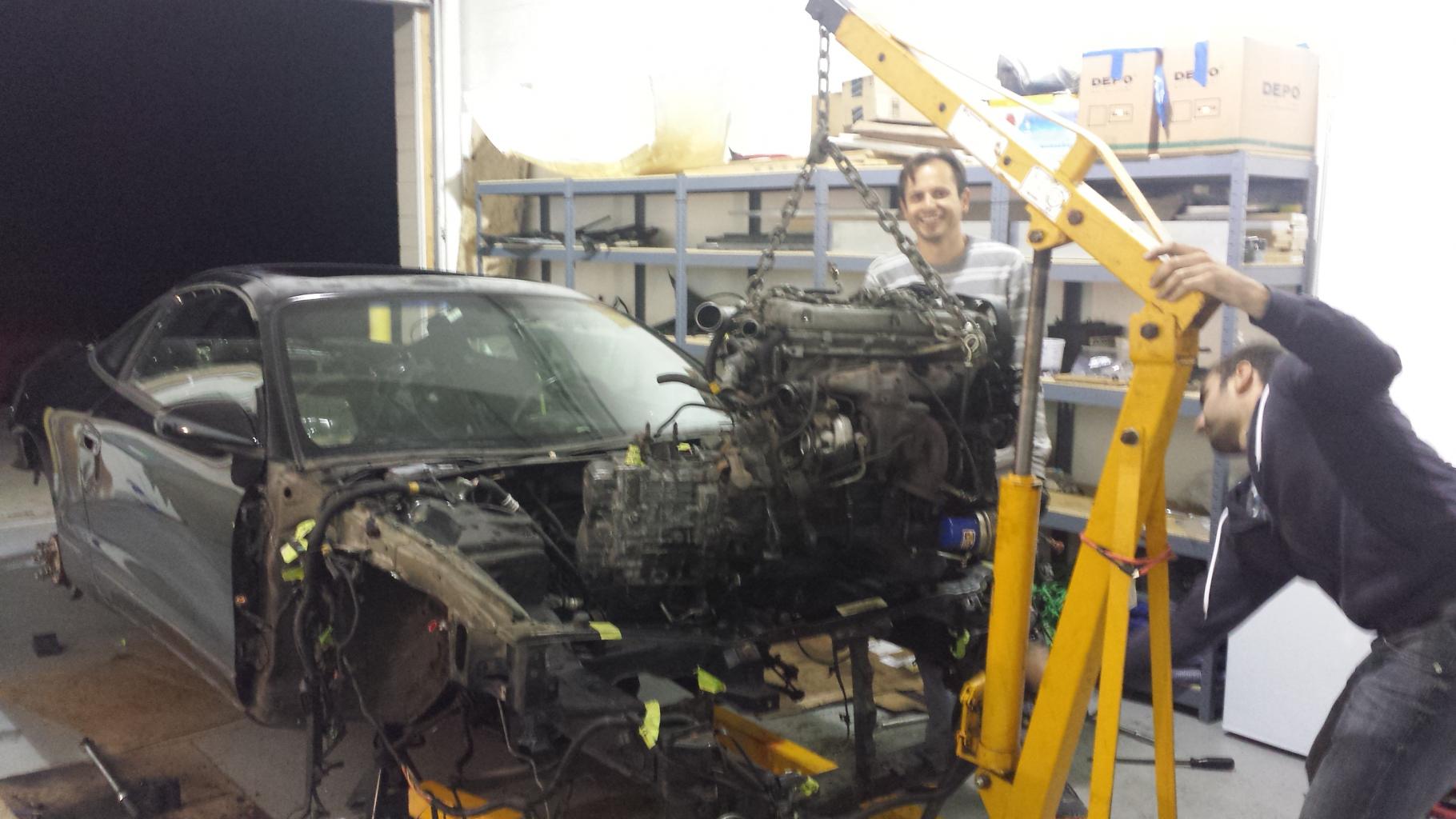

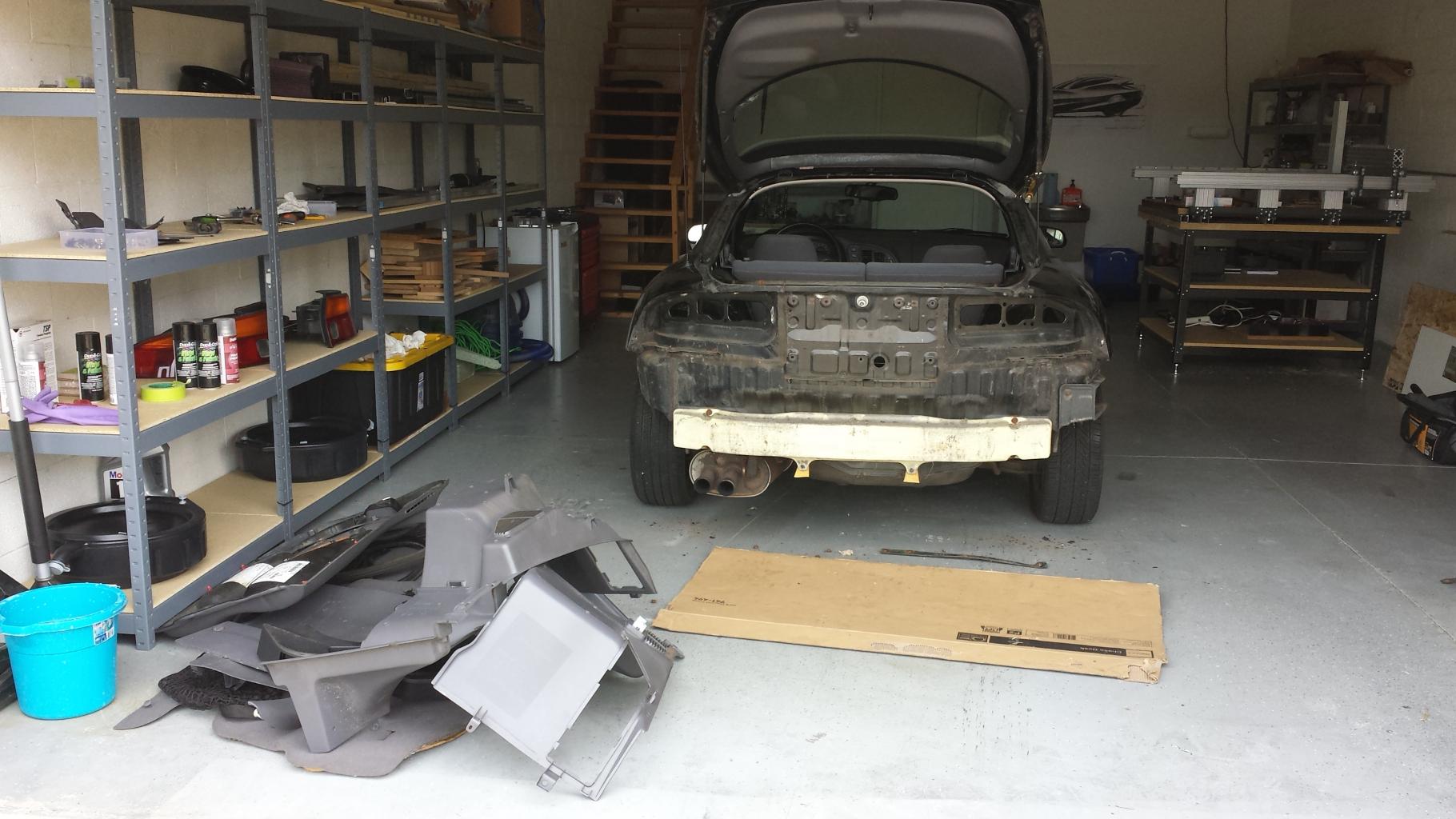

The start of the teardown to a bare shell.

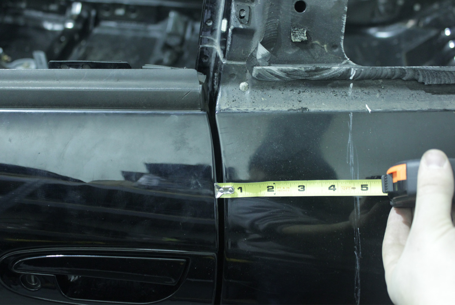

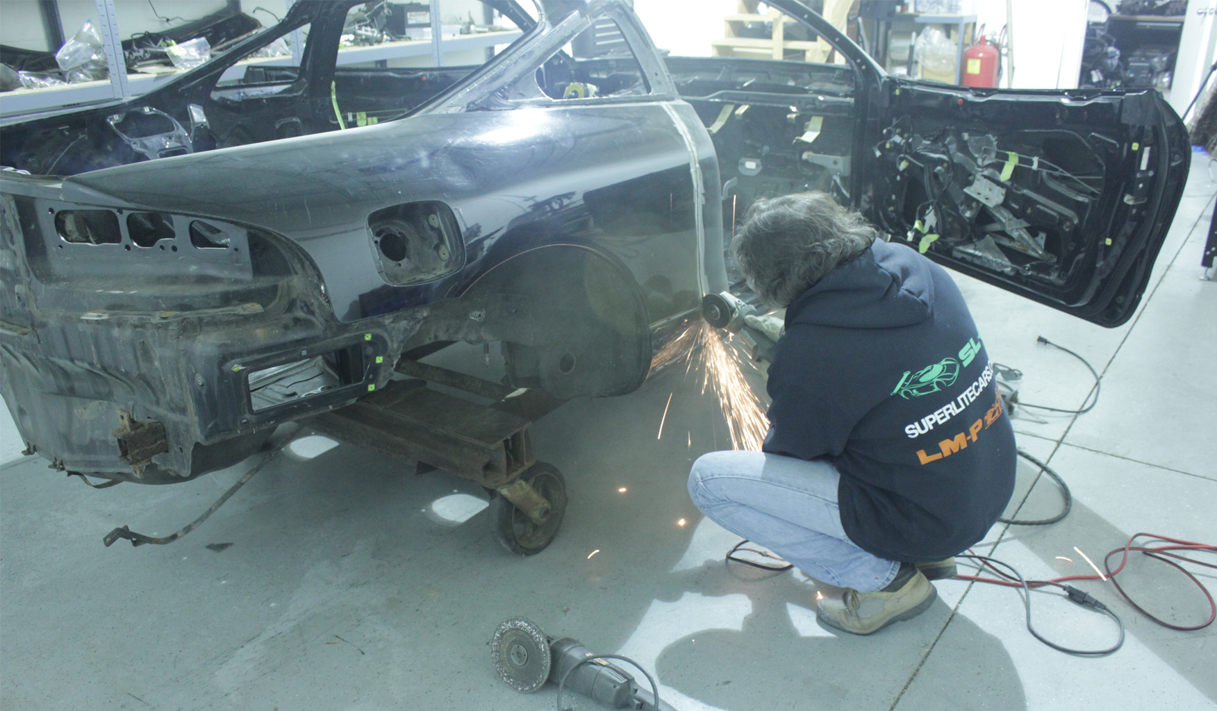

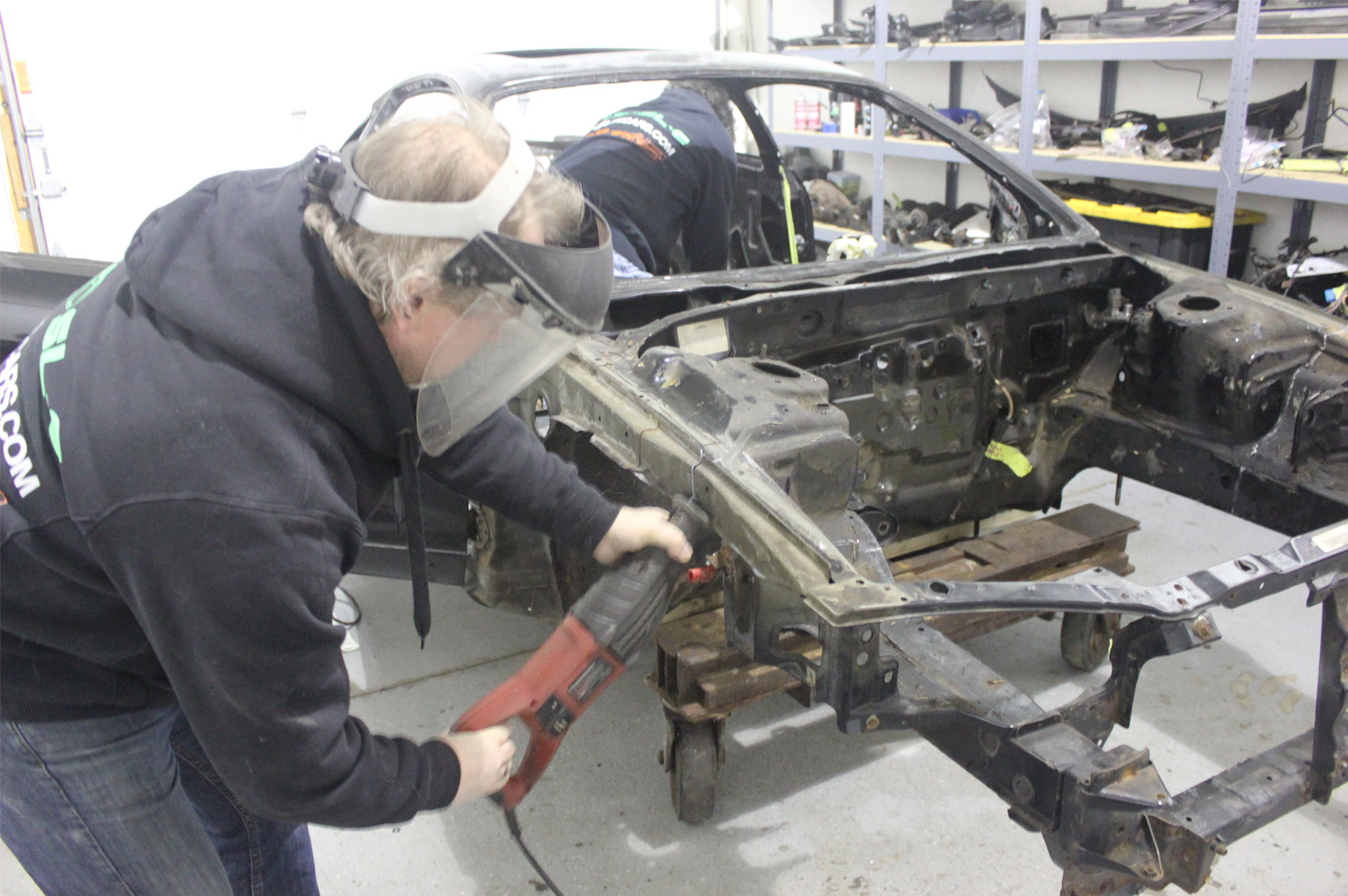

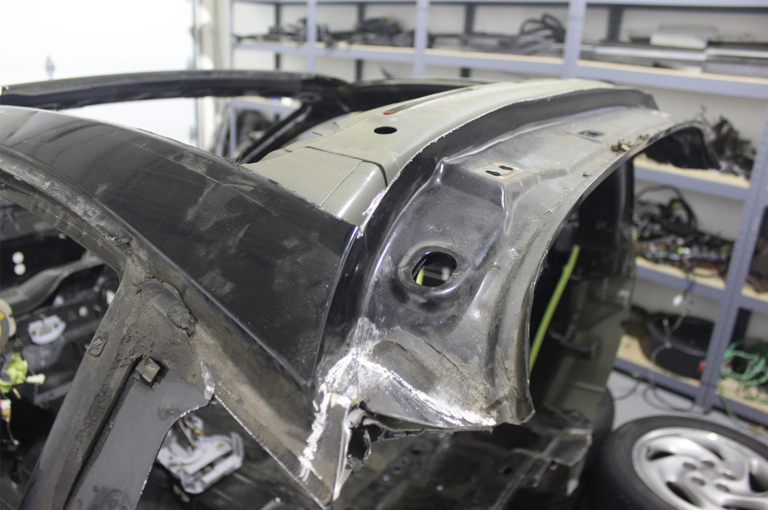

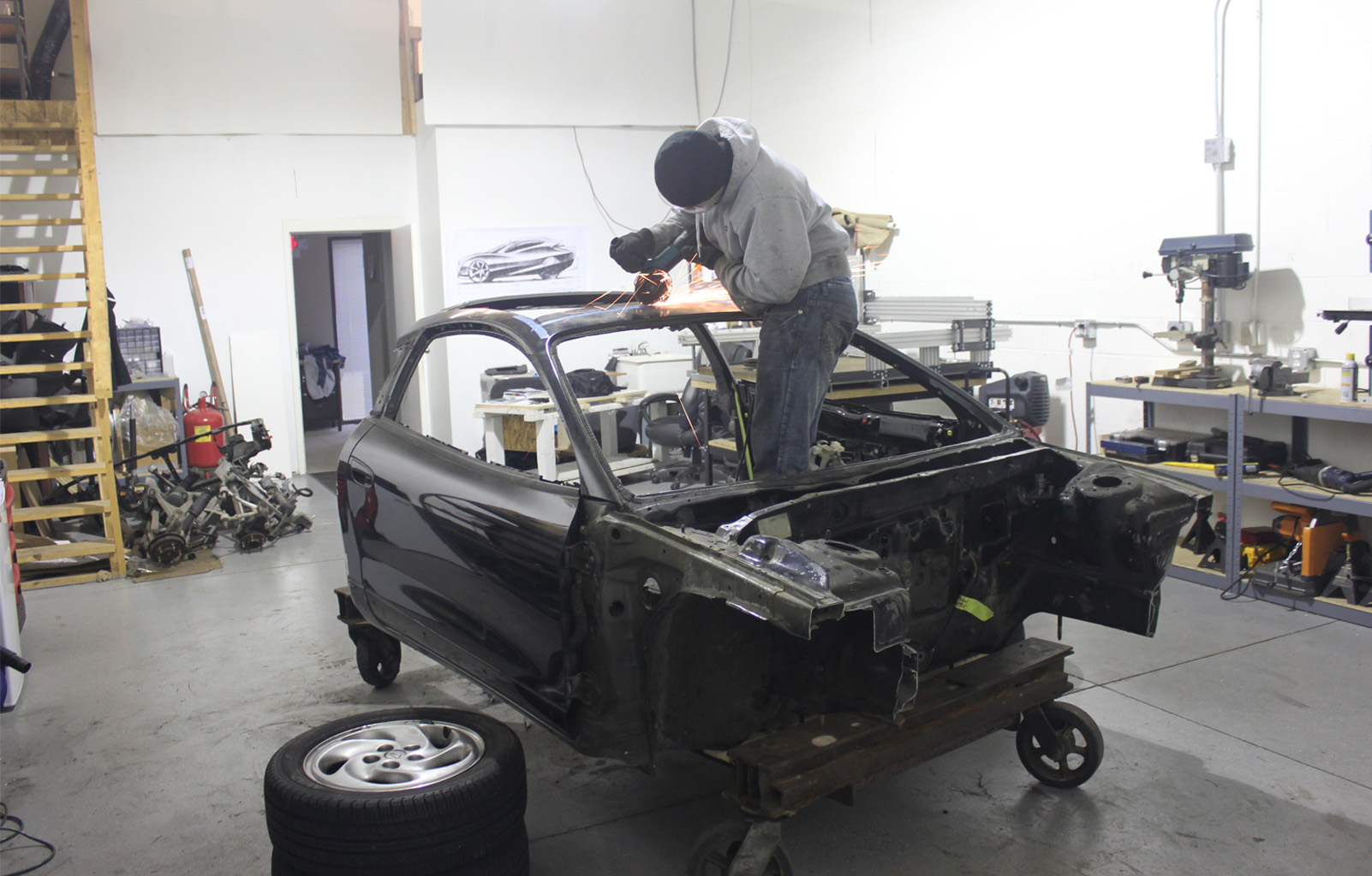

cutting of the car

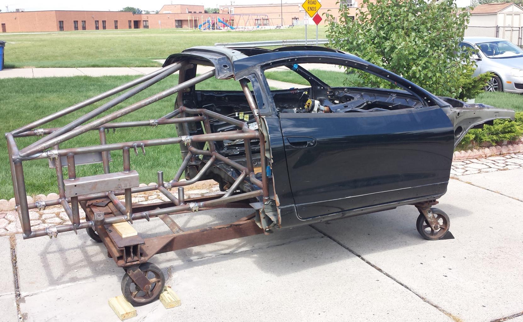

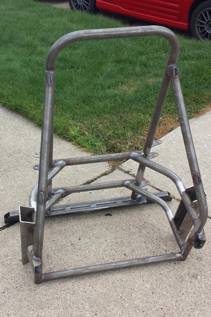

A few months ago I picked up some Corvette C5 Brakes and full suspension local, and just last week I got my Apex kit from Superlite Cars, now the real fun begins!

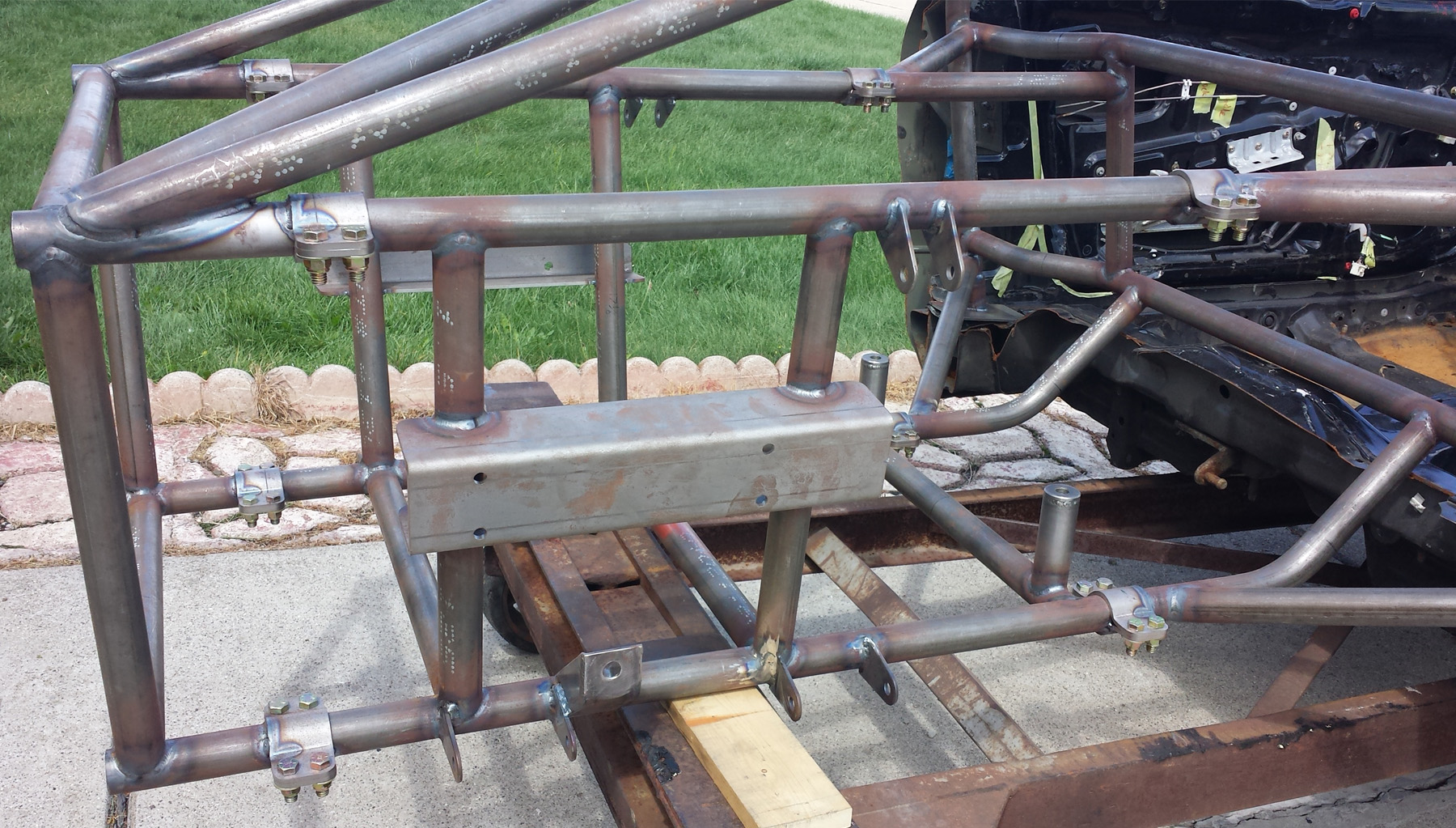

Flo, I'm curious what your plans are for the bulkhead as its a big concern for me. Each time I look at the pics of the rearend I'm like...whattt no bulkhead? Like this pic.
a>
The opening is large. The floor and sides of the eclipse sheet metal are in and out, the cage has several angles, and there's the roll bar entering the car for us LS cage guys. I don't feel like I'm exaggerating when I say 95% of the kit builds on here don't have such an intricate part fabricated whether voluntary or involuntary. Martins having a part water jet and mentioned the cost of this (I can imagine with programming the WJ). Curious if you put any thought toward this yet. Card board template and start cutting, bending? Having looked at it up close does it appear to be an easier job than I'm thinking?
So superlite doesnt have a bulkhead at all for the car? Its not a huge deal if not because i can make one just kinda curious as to why they wouldnt...
Well chaps we did have a bulkhead for the car when it was a four cylinder package...but as the V8 brigades peer pressure determined that the car had to be a V8, then chassis had to completely redesigned and the bulkhead is the last part to be finished...I have not said there isn't one , its just not completed due to all the other changes made to the Apex...and the kit price went down not up I may add...
Fair enough...so maybe there will be an add-on? or maybe it will be included with the kit? ...but sounds like there will be a bulkhead developed/offered later one way or the other. Thats good because while I knew I could manage making one...my goal is to get this thing driving, trying to not get bogged down on any one thing.
