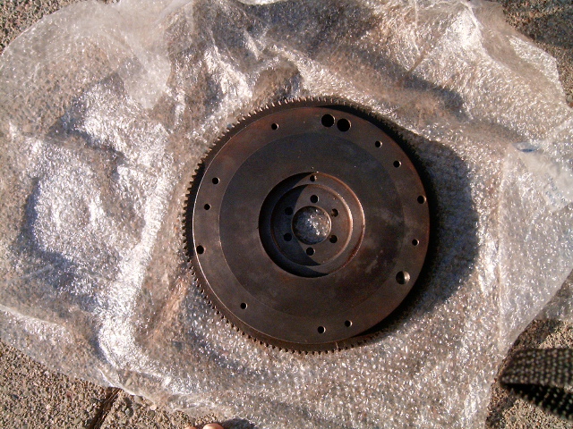

I've got a small problem that I'd like some advice on regarding my GTD 40.
I've had the car for 10 years now, and for a considerable time it has suffered from a slipping clutch. I didn't build the car, so unfortunately don't know all the details of what went into it. Only to say it had a Renault transaxle and Ford 302 (from GTD, so possibly a marine spec unit?).
Last year, I managed to destroy 5th. Completely. Oops
Oh well, I got in touch with Chris Cole (nice guy), and now have one of his lovely Renault 21 Turbo boxes now ready to go back into the car.

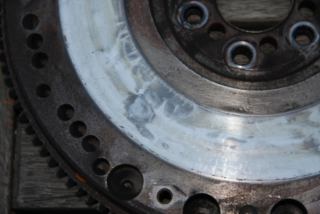

But... I decided to take the clutch off to get a new one to fix the clutch slip, and now the the problems start. Chris suggested I have the flywheel skimmed to remove the glaze. But the surface not only is discoloured from the heat, but also covered in small cracks.
I thought I would be able to easily buy a replacement, to be on the safe side, But....

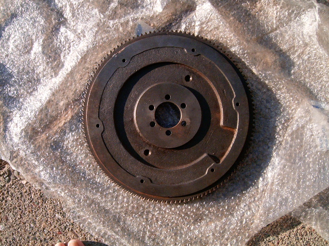

I guess it's not a standard Ford unit for a 302. It only has 121 teeth, and I have heard mention it is for a Ford 3.0 V6. It has some big old balancing holes drilled in it, and I've also heard a flywheel needs to be balanced to the crank, as they are matched. On the rear face of the flywheel there are some numbers stamped into it and there is a big counterweight.
Can anyone give me any advice on:
Can a standard flywheel be skimmed? How much can I take off without weakening it to machine off the cracks. Is this a good idea, considering it isn't a race engine.
If I buy a new flywheel, what do I need and from where?
And finally, will I need to take the crank out to balance it all? That's a big job I'd rather not have to do.
Antony

Antony - I think you could probably remove as much as 1mm from that surface if you needed to and maybe more. I would take it to a good automotive machine shop that has a Blanchard grinder for flywheels. They'll know what to do..
I've had a lot of flywheels that were worse than yours resurrected...

If your flywheel can't be resurrected then talk to a good engine builder. They can take a new flywheel with the balance you have and then match balance it to exactly the same balance as your original thus saving you a lot of hassle. You can get new steel flywheels for your setup in a range of balances from Mick Sollis at Southern GT. You can also get AP clutches which should solve your slip issues.

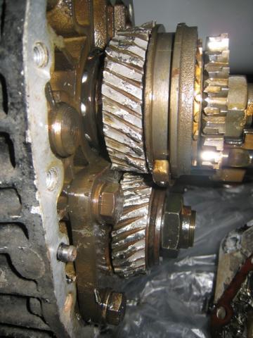

FYI, here is a pic of the remains of 5th! Managed to limp home after that, I really thought I'd blown the clutch but found 1st to 4th still worked.... just.

I wouldn't think that taking a small amount off of the clutch surface would change the balance of the flywheel. If you need to replace the flywheel, a good balance shop should be able to match the old one. If they cannot match balance to the old flywheel you would need to have the crank out and also have the weight of the pistons and connecting rods. All of the moving parts need to be balanced together for a perfect match.
When the flywheel is ground, it takes an even amount off the face of the entire flywheel - thereby leaving the flywheel in the same state of balance that it was in to begin with.
Generally true, but if you look at the GTD flywheel, it has a bucketload of balance holes cut in one area. A skim over the whole area will remove additional weight from the side with no holes. Not much, but a few grams for sure. (and right on the outside edge where it would have most effect)
The flywheel is off an 3.0L Essex Ford V6, eg early Capri/some transits? or an Australian Capri. Cast and not available new from Ford any more but you should be able to pick one up from somewhere. Looking at your existing one I'd get it skimmed and possibly rebalanced if deemed necessary.

Antony. Interesting to see your 5th in such a state. Can you tell us what you were doing when it decided to expire? From what Ive found, its usually the heat issue that buggers them up as they are furtherest from any decent oil supply.
What Ive done with one of mine is to make the 5th gear wider, and hopefully stronger as well by making up a new set. They are only 18mm wide and there is scope to go to 22mm.

I’ve seen this type of failure before on Lotus Esprit Transmissions, which use basically the same Renault UN1 transmission. These have been on high mileage cars and we believe the failure is caused by a combination of insufficient gear width and fatigue loading, specifically from torque reversals (i.e. on engine over-run)<o:p></o:p>
<o:p></o:p>
Bruce’s comment about producing a wider gear would help and so would having the gears shot-peened, which would improve there fatigue resistance.<o:p></o:p>

Antony. Thanks for your replys. As a picture is worth a thousand words, I studied the photo you have of your failed 5th gear. If I am correct, the alignment of the gears is out. Its not common, but I have heard of it happening, the big nut that secures the gears onto the secondary shaft may have come loose, the rear thrust bearing separates, and the shaft drops down slightly, the gears then partially separated, were running on thinner metal and when you took your foot off, its quite a loading on the gears .. and poof --- instant teeth removal. If you've still got the box, Id have a look at the rear secondary shaft nut and see if it is loose - just for the theory anyway.
Bruce - very interesting, It's always nice to know what happen when there is a failure. Unfortunately I haven't got the box any more, so I can't tell you if the nut was loose. I do have some full-res pictures if you want to look at those! The explanation sounds very plausible, and does not involve fatigue, just a build problem. I have a nice new box now, so I'm hoping for no more problems.
