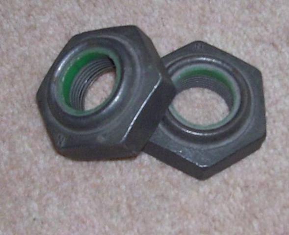

Does anyone know a source for obtaining these nuts ? i need a left hand and right hand thread nut , they are around 21/22mm thread diameter ( or probably 7/8 imperial)
Unfortunately my old ones seem to have worn out the nylon section and im pretty stuck finding them!
thanks
Jason
I have two that appear to be RH thread. PM your address and I will send them to you, they were for my previous KVA that had Granada hubs.
