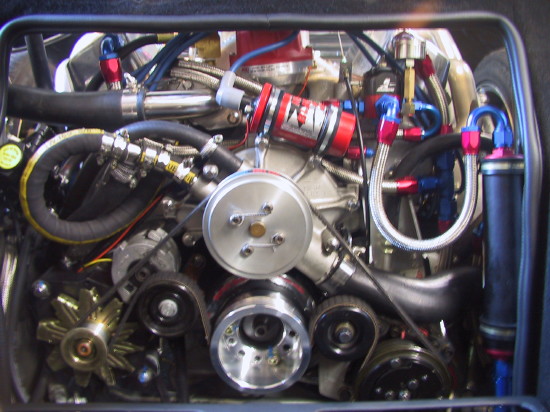

Re: Ford\'s Short Water Pump
Short pump, standard rotation with no v-belts!
