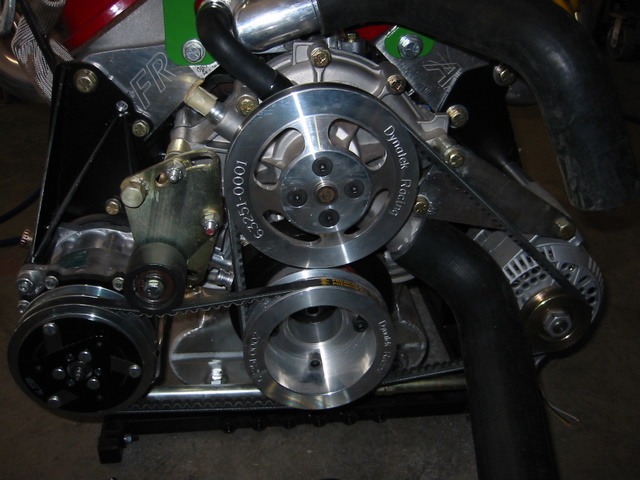

I believe the absolute shortest is the Explorer front dress. It uses a special cam cover, water pump, and harmonic balancer. Most of it can be found used on eBay. There were a lot of crate motors delivered in this trim and many of these were cast off parts. This is a serpentine set up, and it is what I am running on my GT40.
There is only one issue with the [V8]Explorer serpentine set-up and that's the lower bracket idler pulley bearing(NOT the tensioner pulley bearing).This is a small bearing and due to pulley size,runs fast even in the normal vehicle(maybe 5200 engine rpm max).Not long-lived at high r's.Ask me how I know.Other than that,it's fine.This configuration uses an upper right side alternator,an upper left/middle power steering pump and lower left a/c comp. A.J.

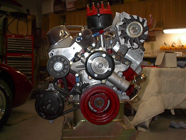

I have a set of pulleys from Dynatek. They work in a SPF GT40 with the short Ford pump. The picture is one I took of Lynn Miners engine just before it went in and they work with the SPF brackets provided with the car.
