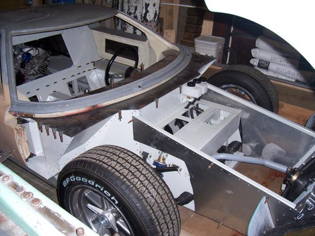

Shawn,
If you are going to scratch build the chassis why not build the front suspension as well, it's the easy part. I used the same rack you are using with Mustang 2" drop spindles and it works great.
