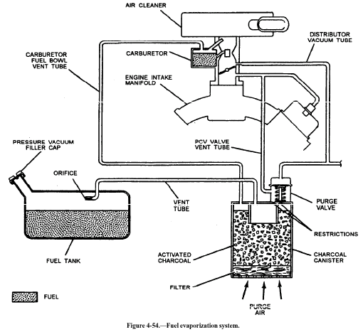

Basically, I plan to follow the attached drawing except I also want to add a check valve for roll over protection in the vent tube. And, I think flaps valves or another type of valves should be added to prevent the fuel from spraying out of the fuel cells if they are compressed in a crash and the filler neck is broken.
Putting a roll over check valve in the vent tube seems easy enough. Does anyone know where I can get a check valve that (1) closes when the car is up side down, (2) will allow air to travel both ways in and out, and (3) will also prevent liquid gasoline from squirting out if the car is right side up and the fuel cells are compressed?
I think I also need a flap or plunger valve inside the filler neck nipple on the tank bladder. It would need to prevent liquid from being squeezed backwards out the filler neck if the tank was compressed on impact. And, to minimize the likely hood that the filler neck will break, the metal tube from the cap down to the valve could be replace with a gasoline tolerant flexible rubber or silicone hose.
Finally I have been told that the only disadvantage of a vent to the carburetor, as shown in the drawing, is that heavy gas vapor is immediately drawn into the intake manifold when the car is started and that may upset the air fuel mixture and make the car hard to start. To fix that, a valve (electric, vacuum, bi-metal thermal ?) could be put in the pcv valve vent tube and set to NOT open until the car was started and running.
Is this enough to take care of the basic safety and all the vapor and smell problems? If I have misunderstood anything here, please tell me. Hopefully I am just reinventing the wheel and this is about how things are normally done.
