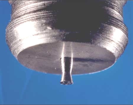

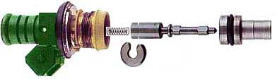

The pintle cover is exactly that as I understand it, a cover to protect the pintle valve tip from damage (most likely during handling or fitting)...

(ps attached a few pics showing the plastic bit (yellow) I think you are refering to, a typical pintle injector internals and a close up of the pintle itself - which is normally ground to tolerances of 1 micron and lifts about 0.06mm when open)....

Paul, the yellow cap in your pictures is exactly what came off.
