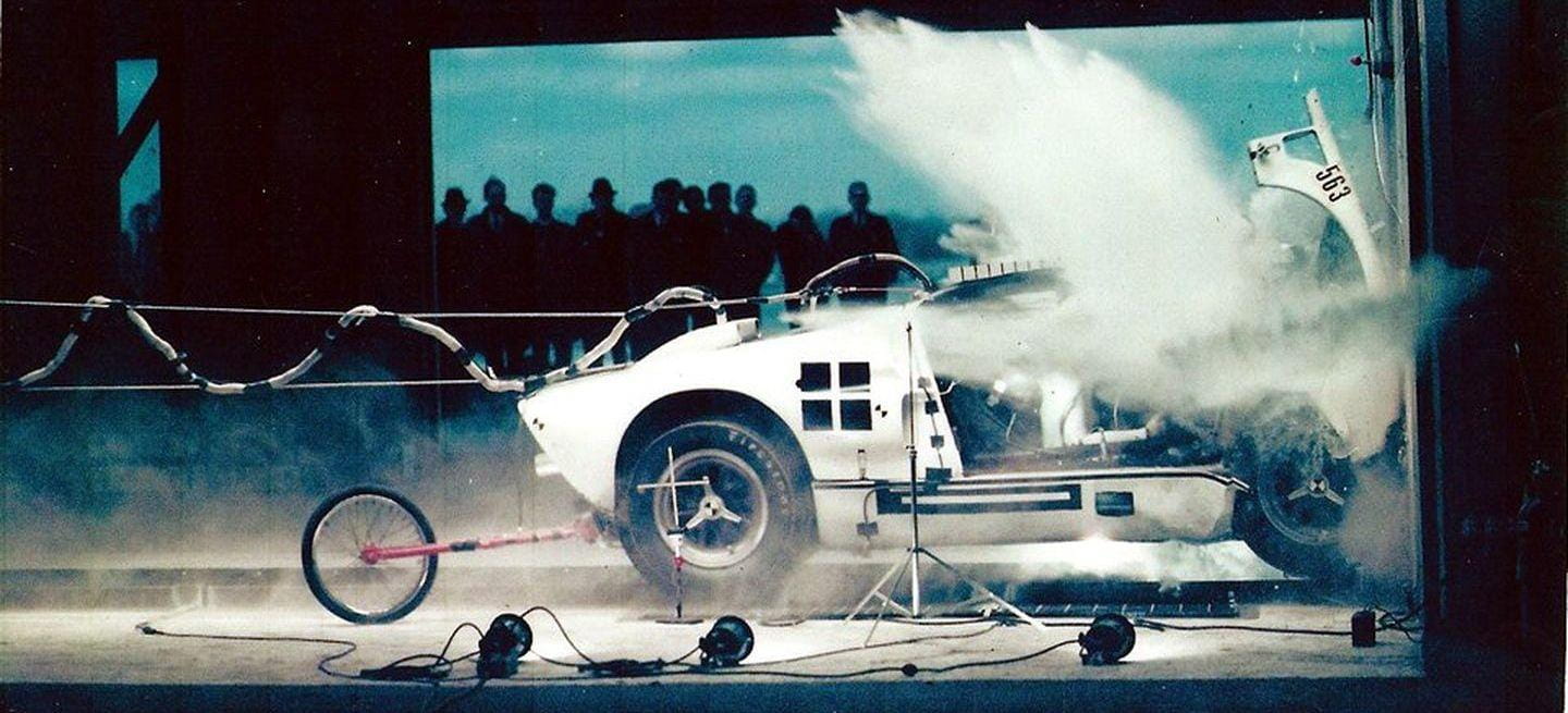

Howard Jones
The above video when watched is a commentary on the dangerous side saddle fuel tanks on GT40s. In a head-on into the barrier or a front corner into a barrier the tire is forced rearward and into the front of the fuel tank, compressing it and the fuel inside and forcing it up and out of the fill tube and filler cap.
This video was why I stopped tracking my GT40 and built an SLC.
damn, really don’t really want to crash a 40!
