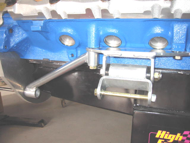

These boxes love to be driven hard, just change the oil annually with a quality Castrol synthetic. Most DRBs use this trans and they get "used"!,haven't heard of any problems in the last 10 years.
(check to see if the angine is braced to the adapter plate)

Great photo of the brace and yes, mine is braced similarily. With DRB's motor mounts and braces, the whole engine/trans seems rock solid.
