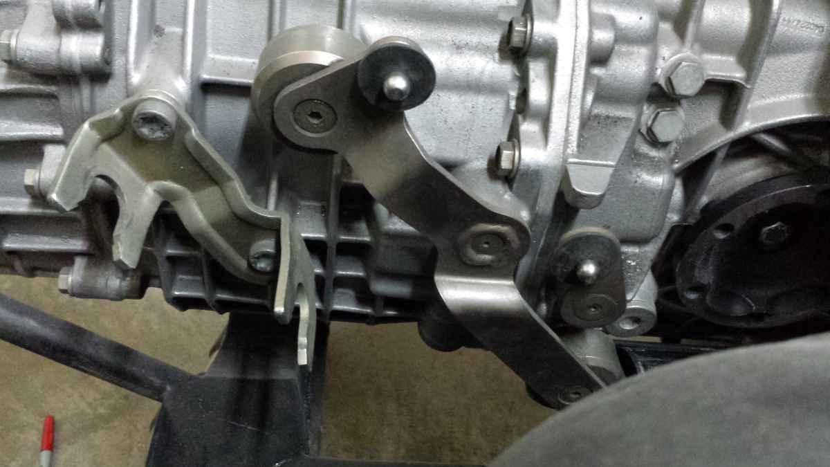

Need some help. Dropped a G96.50 into my pantera, everything is mounted and good to go, but I'm trying to measure for the shift cables and absolutely clueless on which of the two linkages do what, and which gearbox linkage position calls which gear.

The short lever selects the gates and the longer lever selects the gears. The spring for the reverse gate is very stiff. It has been a while since I had one here at the shop so I am not sure what direction selects which gears. You will have to just try it out and see.
