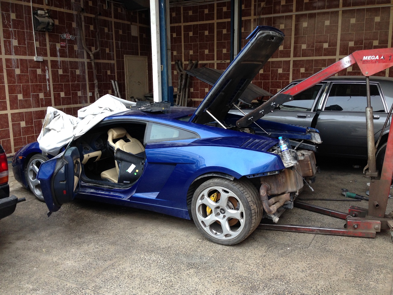

here is my car first when I got it it was without engine and transaxle
and was left for 9 months

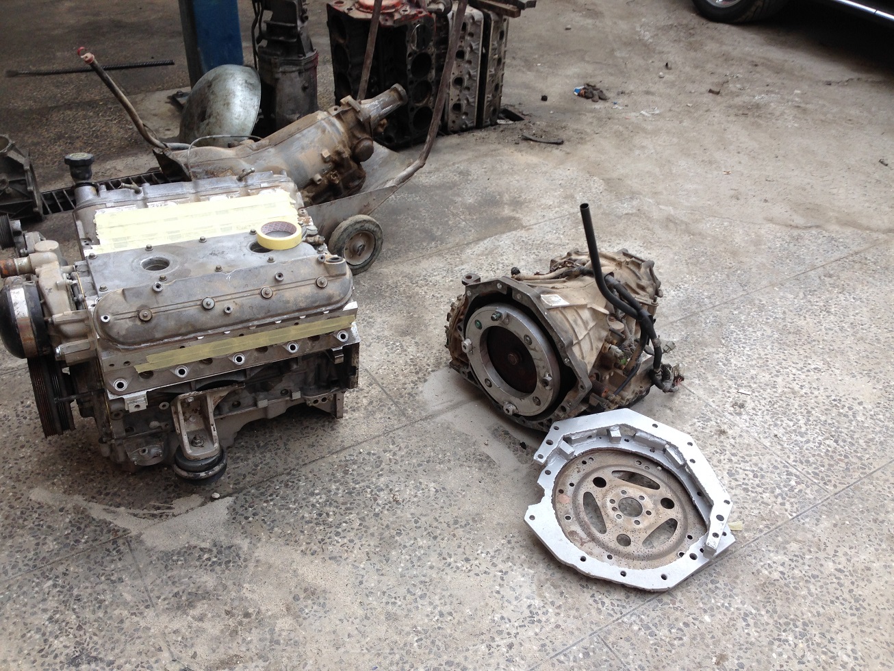

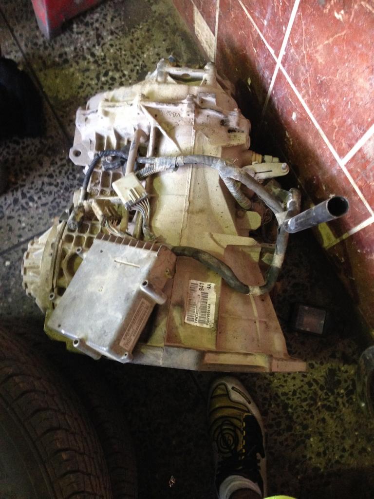

this is the automatic transaxle I bought from one yard with the controller
here is another mistake because I found after that's I need to reflash the controller and we don't have any one in my country do that specially with old car
in the second picture is the adopter first when I got it just to check and what we need to do more to make it fit
look bad I know :)

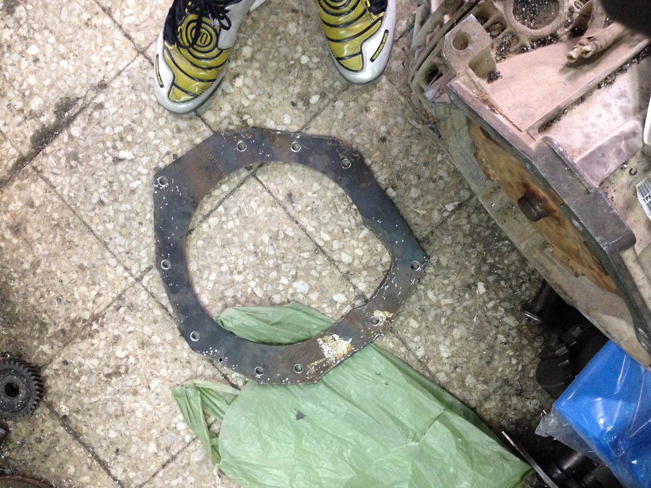

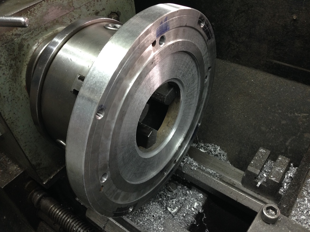

for automatic transaxle adopter you need two part not only one plate like the manual transaxle , is was the first problem I faced then the starter also need space so I cut small part from the adopter
here is the picture for the one part of the adopter
attachment.php

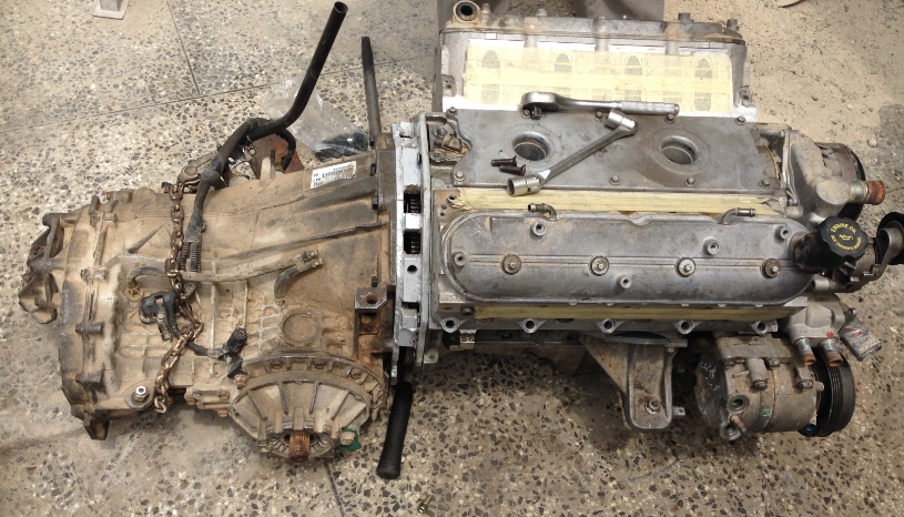

the engine , transaxle and the adopter
attachment.php

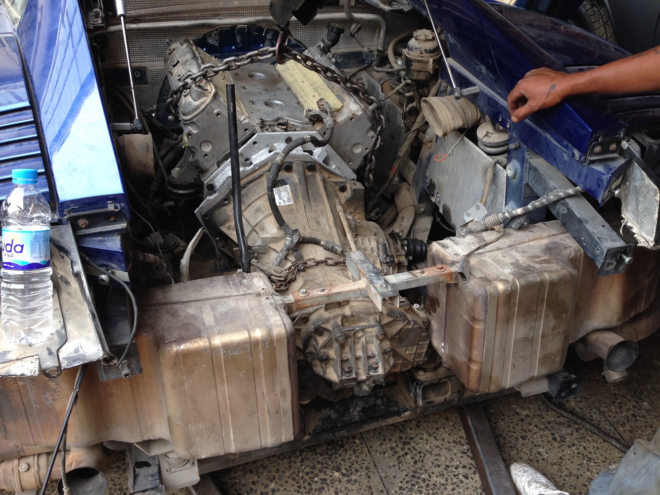

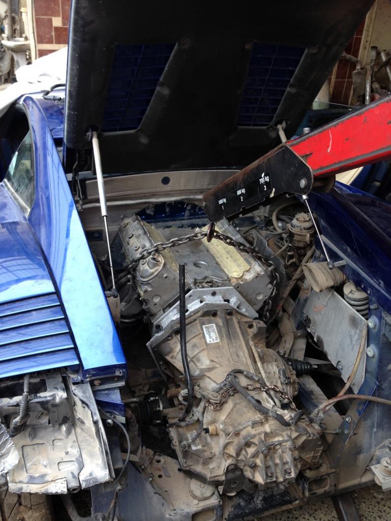

after get the engine ,adopter and the transaxle together I tried to have it to the car to see how it look like
attachment.php
attachment.php
attachment.php

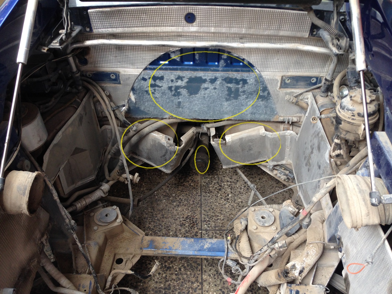

attachment.php

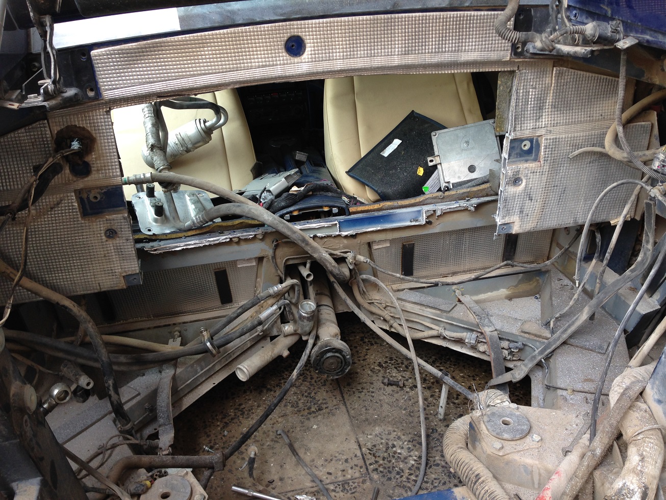

those four yellow circles where I have problem to solve the engine need more space
the center circle : I need to cut the body
the two side circle : the gas tank , need to cut the tips from it
the down circle : is the four wheel drive shift , already I decided to remove it because my transaxle does not support the 4wd
attachment.php

Hi Mish, How much do you need to trim from the firewall, most CV joints will run at about 7deg max, that's what my old Toyota Corona runs from the factory, that means you can move the motor and trans back and gain about 50mm clearance
Paulbav >>>> thank you for your replay , believe me if I had a chance to work better than that I will but can you imagine I couldn't find any one work or accept to have my car in their garage !!!
all what you see is made by my research ,I spent many many hours just to get basic information , just give me time and see how I am going change this car
Graeme S >>>>> yes you right I could move some mm but also I will have problem if I want to change any thing on the engine like the ac compressor or the belt
I have to take the engine out for small thing in the future ,so I decide to move the firewall to have space for the engine
many thanks for your advise

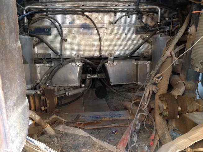

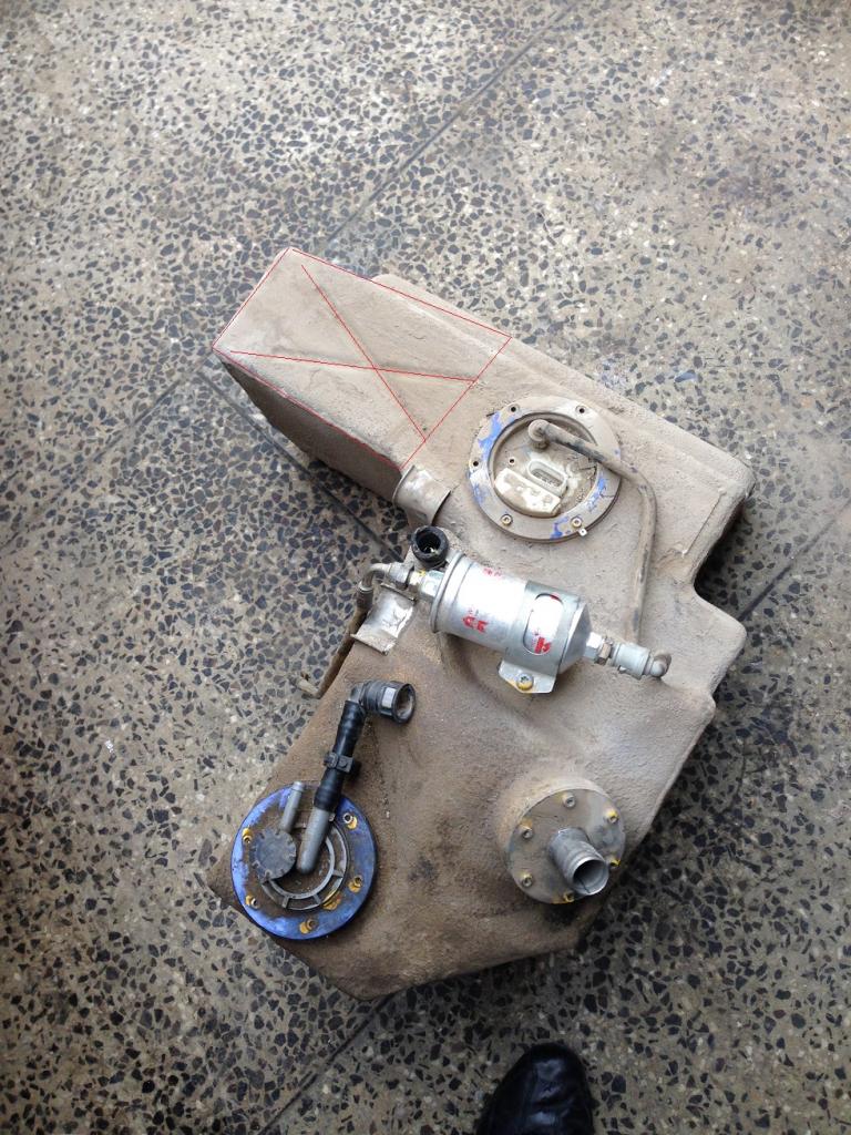

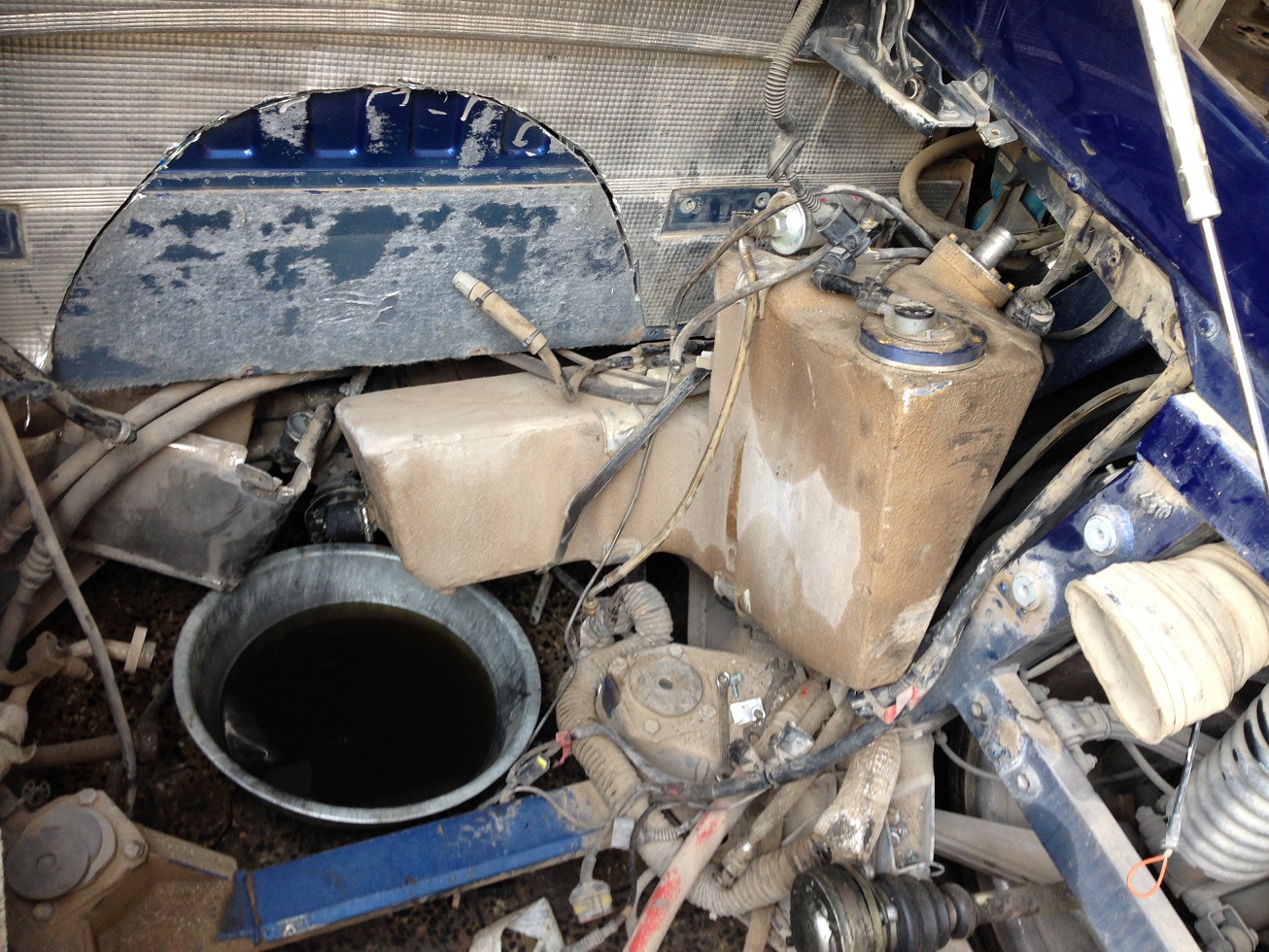

so I started removing the two gas tank for preparing ( cutting the side of it )
attachment.php
attachment.php
the red mark cross is the part I need to remove for both gas tank because those part is very close to the engine ( its for safety and also for the engine to be installed in free space )
attachment.php

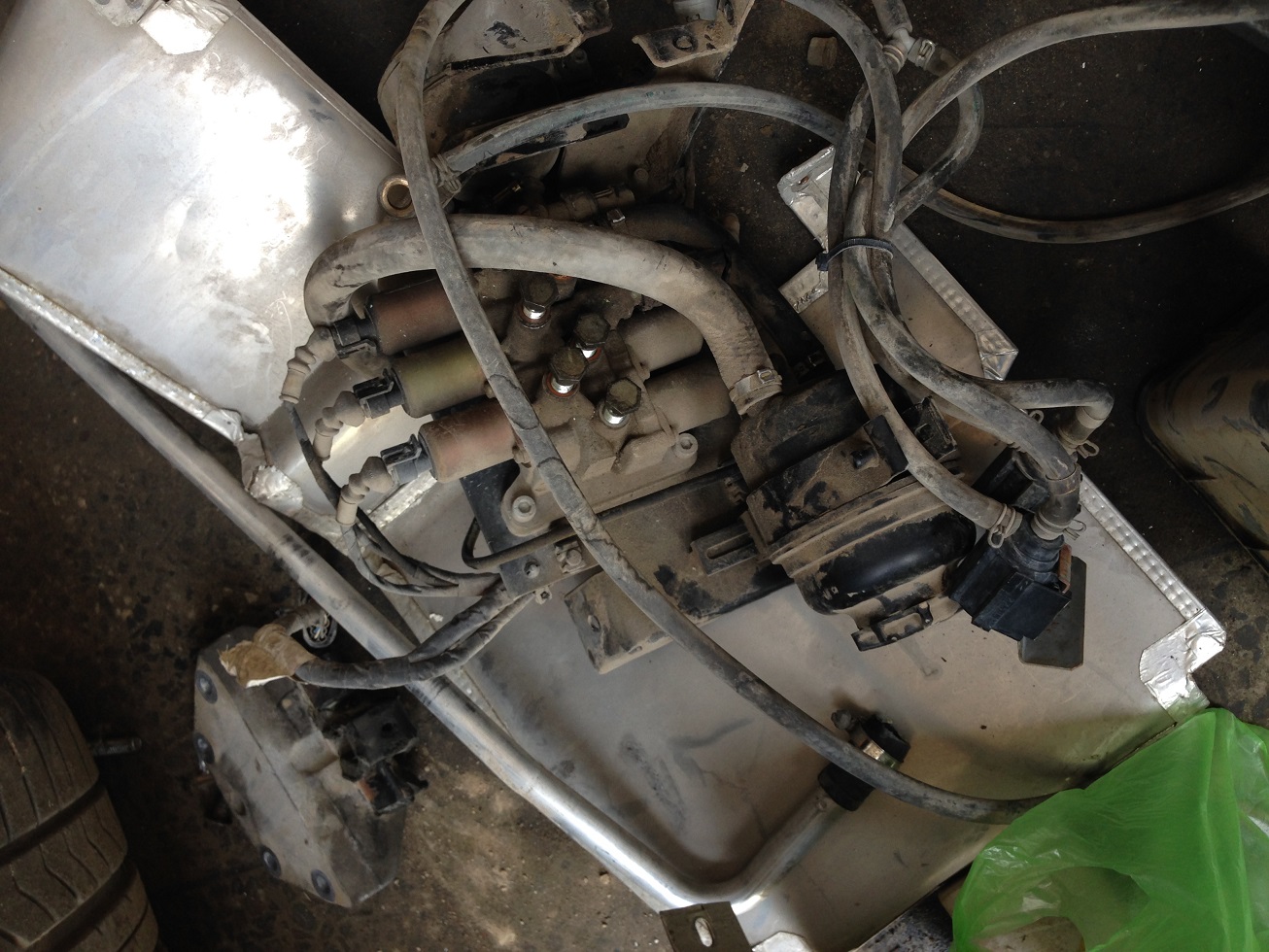

the E gear pumping unit , I don't need them any more so I remove it and kept it in my home garage for any need in the future

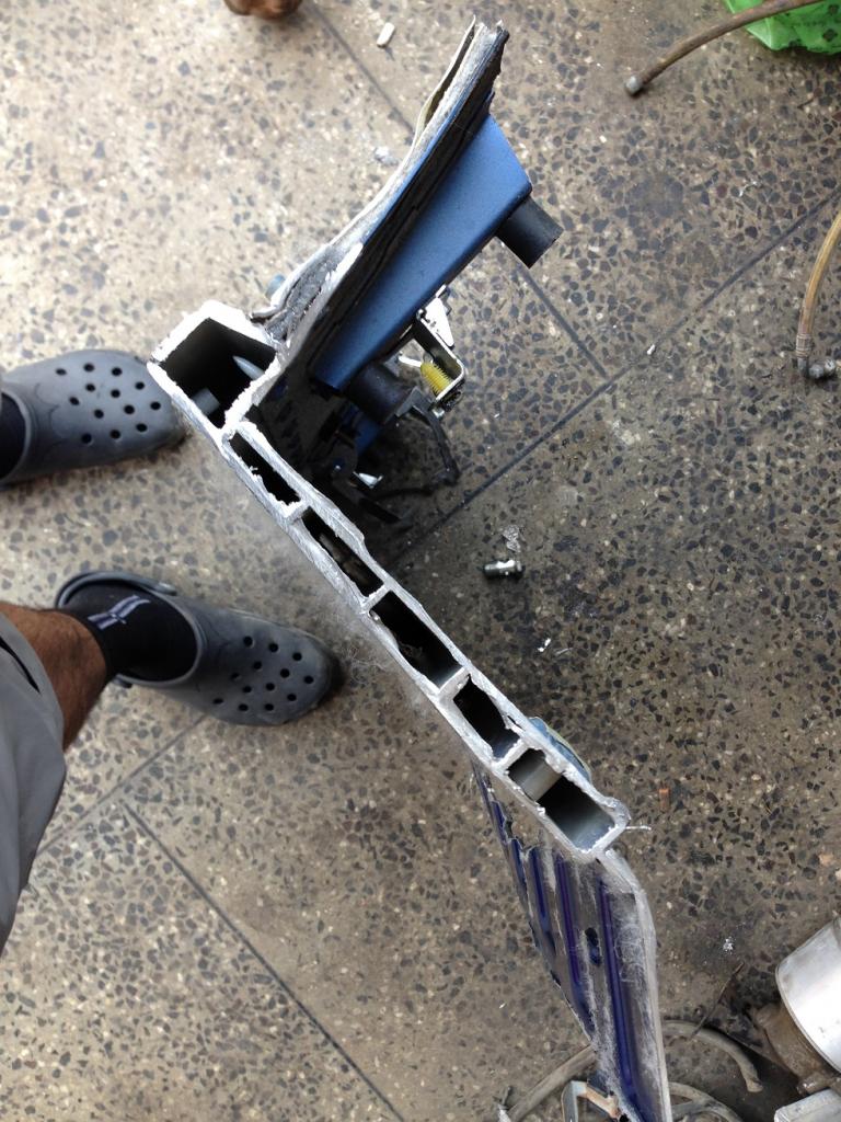

finally with strong heart we move the firewall :)
attachment.php
see the second picture the OEM part was 2cm , after this cutting I decide to have wide plate than the OEM to close the firewall
attachment.php

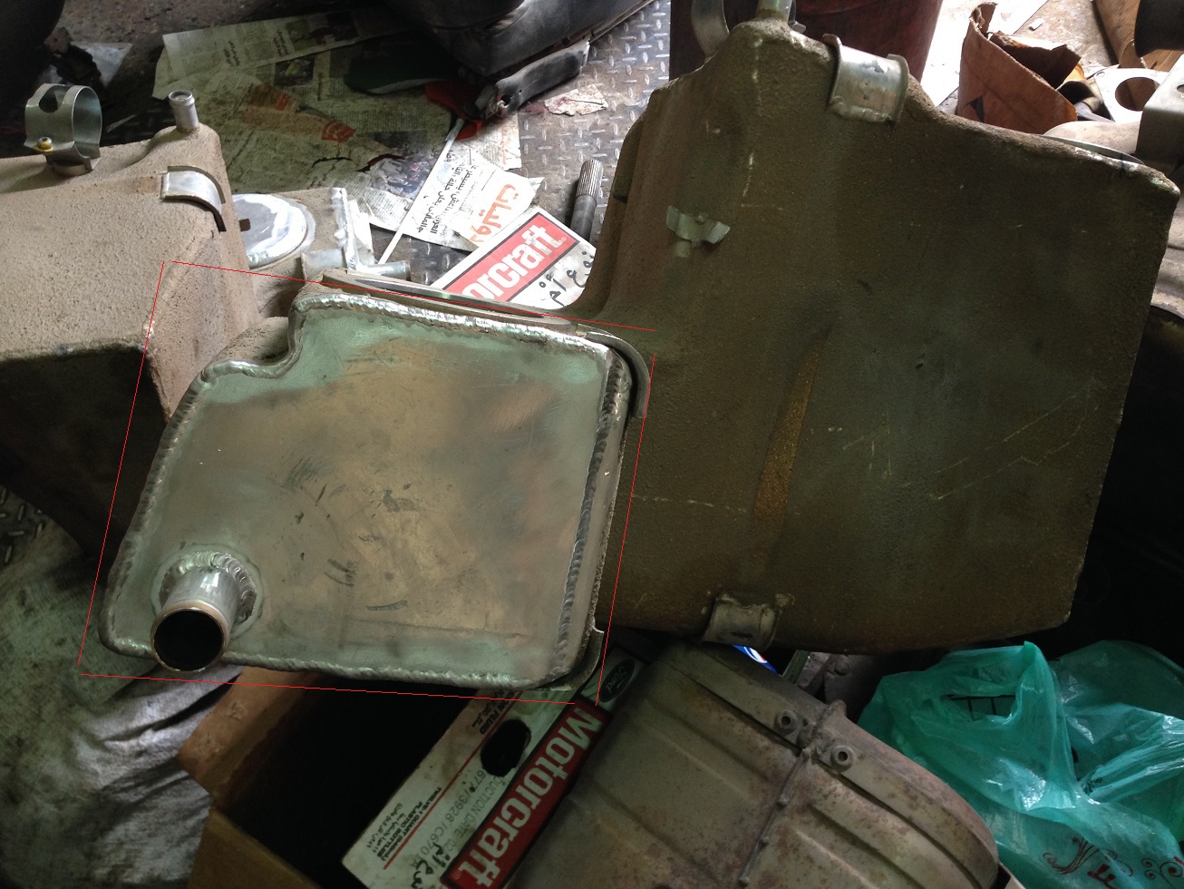

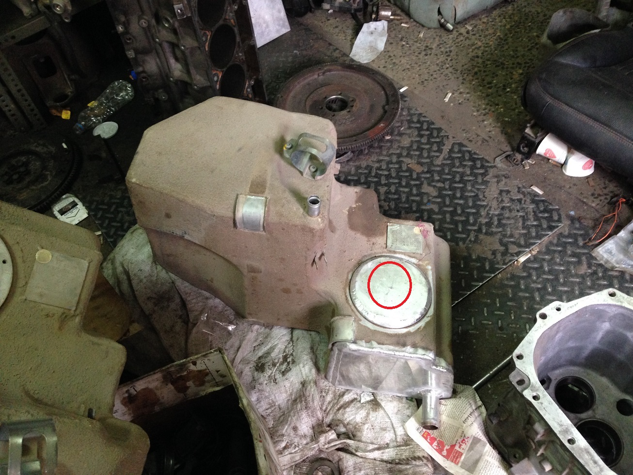

here is the gas tank after I did my cut for the part that's I don't need
( the part is close to the engine side ) its been done by aluminum argon welding , another issue I faced because I couldn't find some one do aluminum argon welding specially for gas tank until I find one who did it for me
attachment.php
you can see the round close part in the red circle , Its for the gas pump and OEM Gallardo has two gas pump so I decide to close one and use only one gas pump for my engine
attachment.php
the gas tank now ready to install but I will not install it now until I finish most of the work and clean the whole engine area

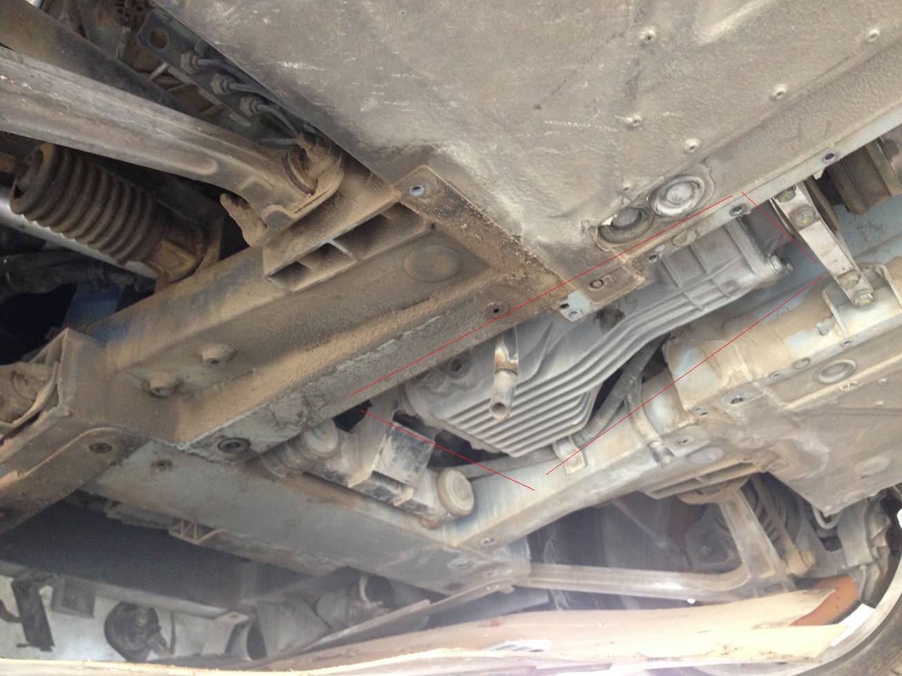

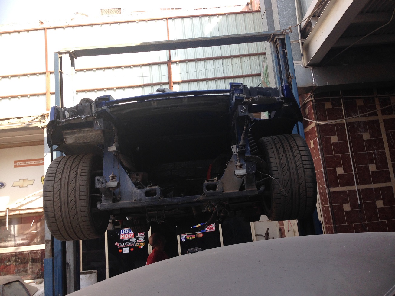

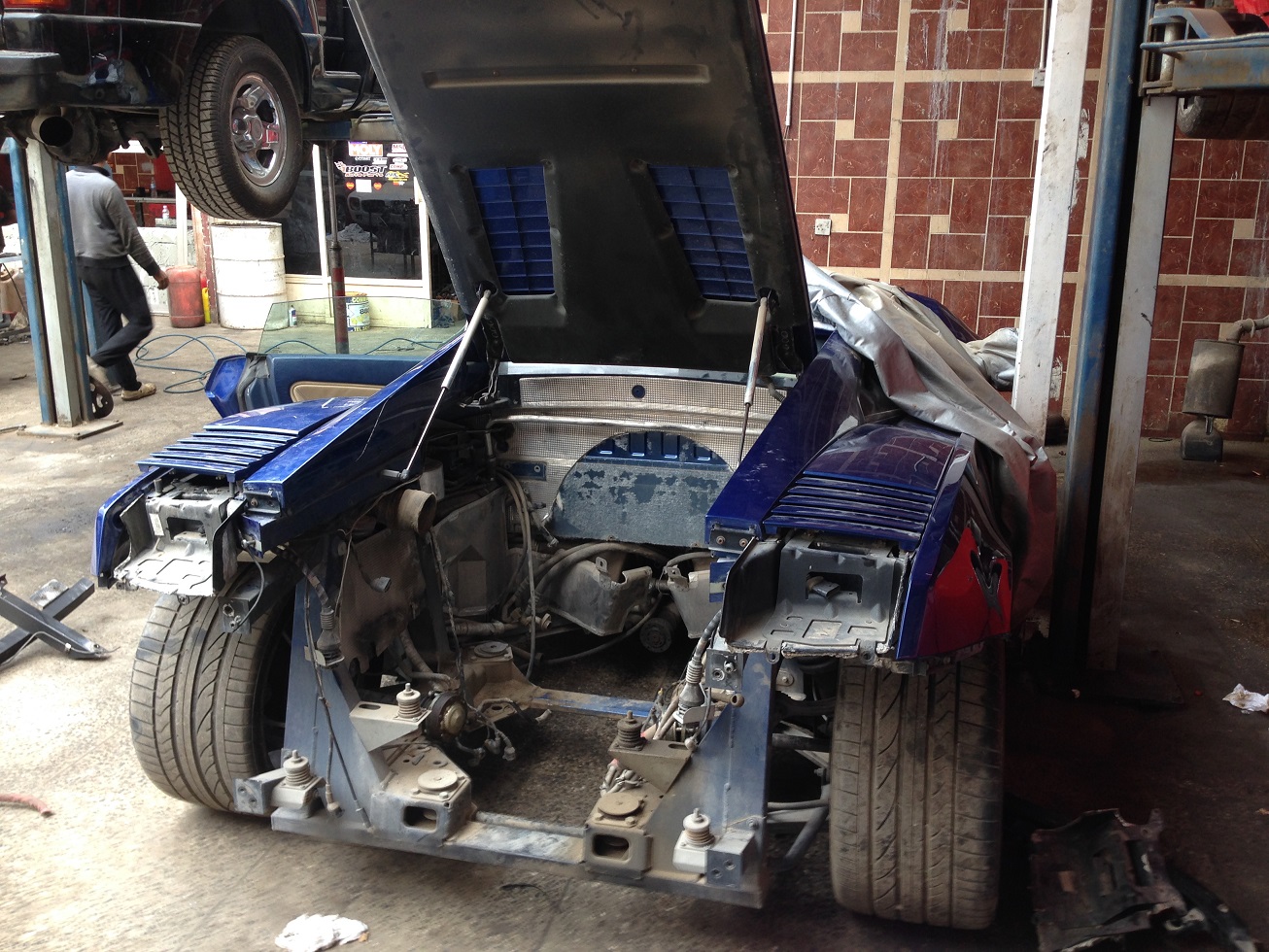

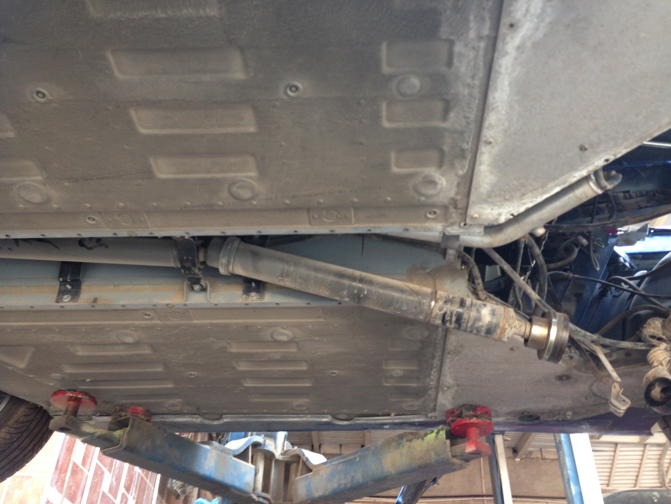

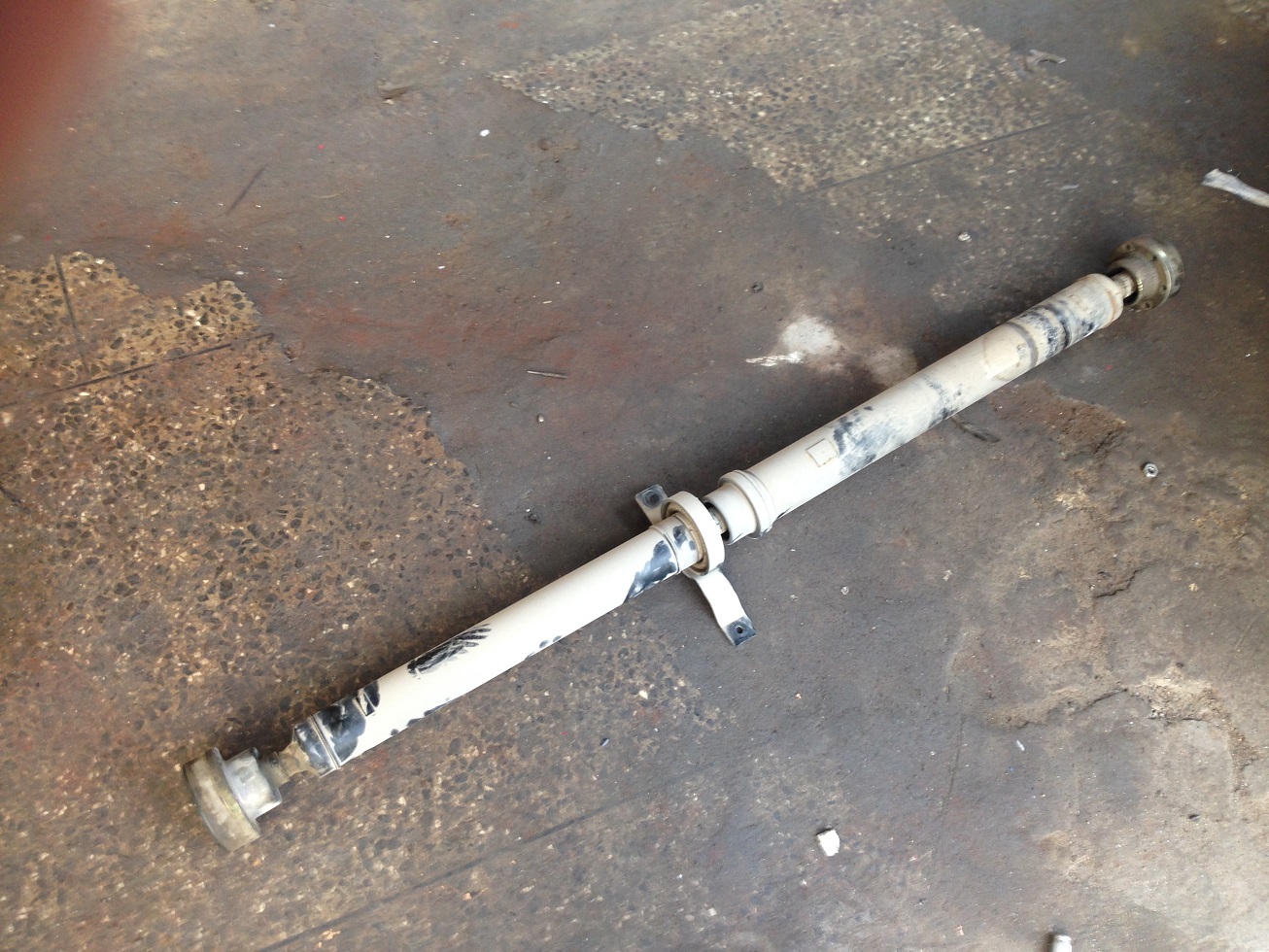

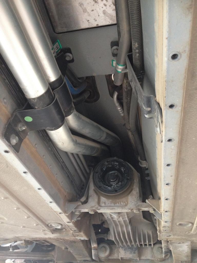

getting ready to remove the four wheels drive shift
attachment.php
on the second picture I decide to keep the front differential with the front axles to support the front frame of the car
attachment.php
removing the 4w drive shift
attachment.php
attachment.php
attachment.php
done with the 4w drive shift , it wasn't hard to remove
