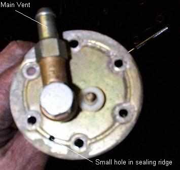

I have fixed one fuel leak, which was due to a leaking diaphragm in the fuel pressure regulator.
Although my car is a DAX the problem seems to be similar to the ones in this thread. Now I find that the drivers side fuel sender appears to be designed to vent the tank since it has a pressed rim with a hole drilled in the sealing ridge. Since it is on a thin paper gasket, this hole is not sealed by the gasket.
The sender also has a larger vent union. The hose connected to this union comes back then loops forward into the sill area. I think it is probably connected to the filler overfill drain, but have yet to check thoroughly.
If I seal the small hole in the sender unit, I dont think that the tank will be vented at all, since the filler drain is in the area sealed by the spring loaded cap.
So I think that I will need to provide an atmospheric vent with a check valve.
Any advice on the right way to do this appreciated.
