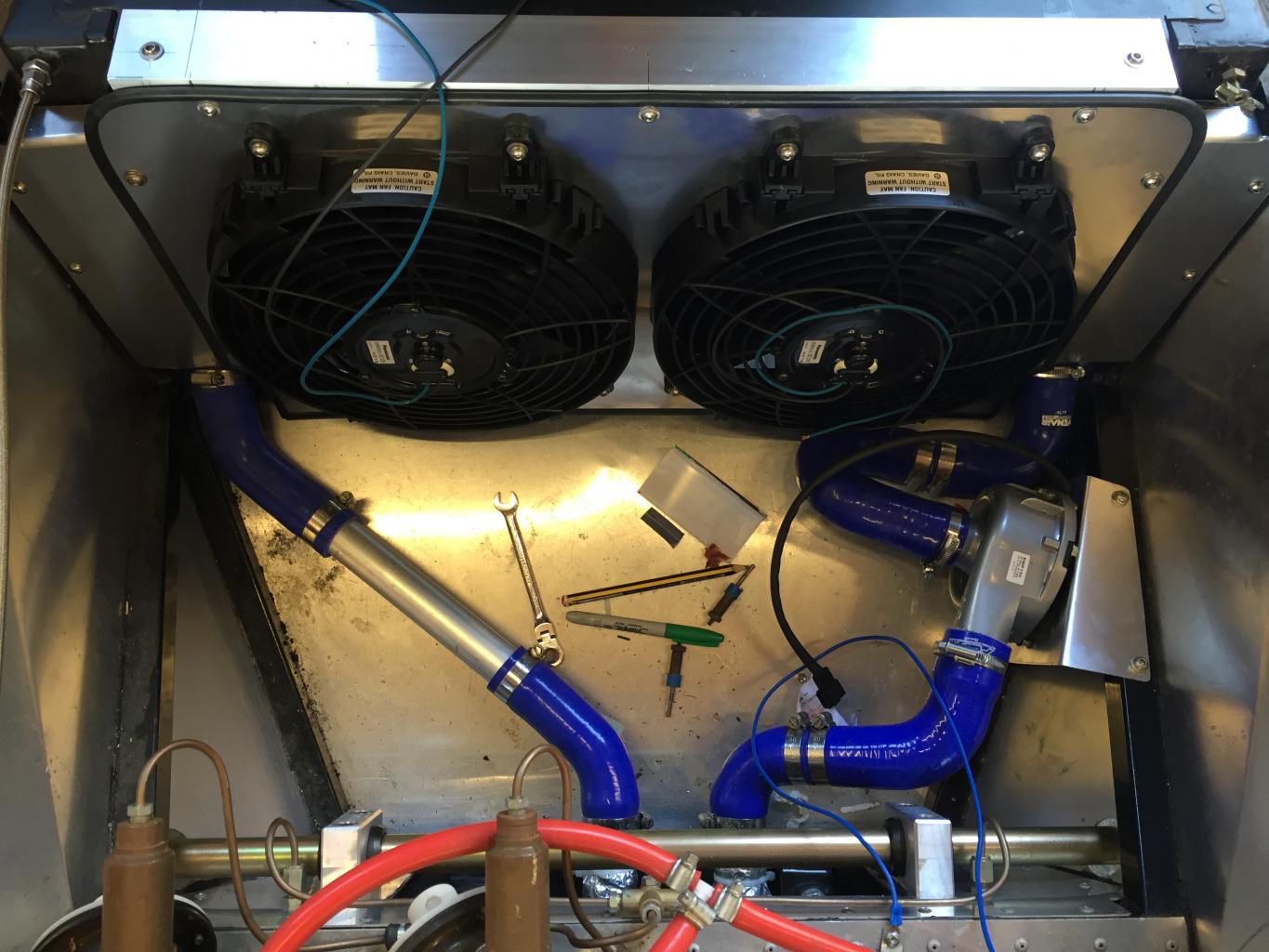

Fans and shroud finished...think i need to move the water pump now else nostril will not fit...
Also gave my new rivnut tool a good workout with this shroud. Cant believe i waited this long to get one. its from Memfast, uk company, worth every penny as there were 15 to do in the shroud alone!!

Glad to see you’re still making progress with your ‘40.<?xml:namespace prefix = o ns = "urn:schemas-microsoft-com<img src=" /><o:p></o:p>
Regarding the waterpump, I’d be looking to mount it below the anti-roll bar. So 90 degree connector (as current) and then a straight run to the radiator, thus eliminating the U-bend<o:p></o:p>
Regards,<o:p></o:p>
Andy<o:p></o:p>
